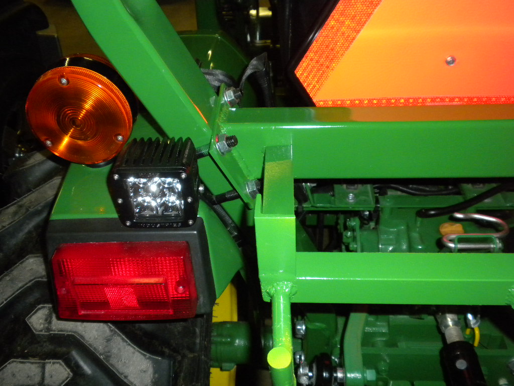

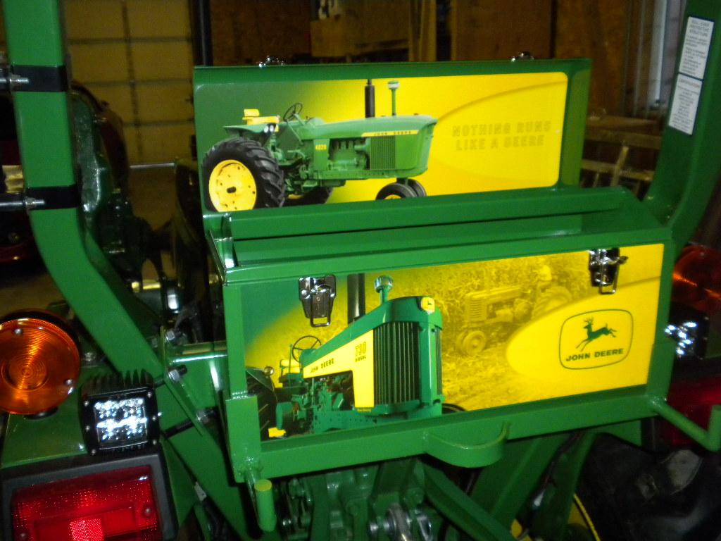

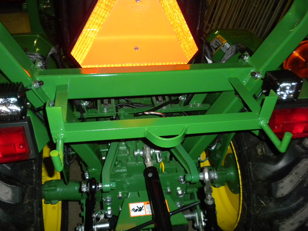

Hit the shop this morning early, finished my tool box and chain setup.
$14 in two cans of paint, with left overs.
$20 in steel
$20 for the u bolt kit, just bought another canopy top mount kit. 2x3 rop.
$60 for the limited tool box, nice steel by the way, its heavyier than my craftsman that looks the same.
6 hours of work, getting the angle right for the ROP was a little tricky if you decide to do this because its also off camber and of course angled. I made a cross member out of wood first then used it for the steel referance.
Hope you like the chain idea, bad comments also welcome. ;)

Looks nice. What holds the toolbox in the support frame?
/ 3005 tool box done today.
Just the back and front corners, If i roll over i might get a head full of tools. But its in there snug, I wanted to be able to remove the box.
/ 3005 tool box done today. #5
Cant it bounce off if you hit a bump??
/ 3005 tool box done today. #6
Looks like a factory install. You should sent it to John Deere and ask for Royalties when they put it on all tractors.
/ 3005 tool box done today. #7
One of those $0.99 rubber cargo straps ought to hold it in there tight even when bouncing or even upside down.

I made a similar set-up for my 790 when I owned it.....and it sure was handy. I realize how tricky it is to get the proper relationships of the "bracketrey" due to all the compound angles - nice job.
I wish for one on my current tractor....but get along with the fender box. I do wish some enterprising person would offer bolt-on kits for popular tractor models.
OH....BTW....not sure if you travel on the roadways.....but, if so, you may want to get a slow-moving-vehicle bracket (bracket and "pocket") so you can mount same on your tool box. They have the bracket at farm stores.

Have no intention to travel on the road, but I think I will just make a magnetic bracket for the signal.

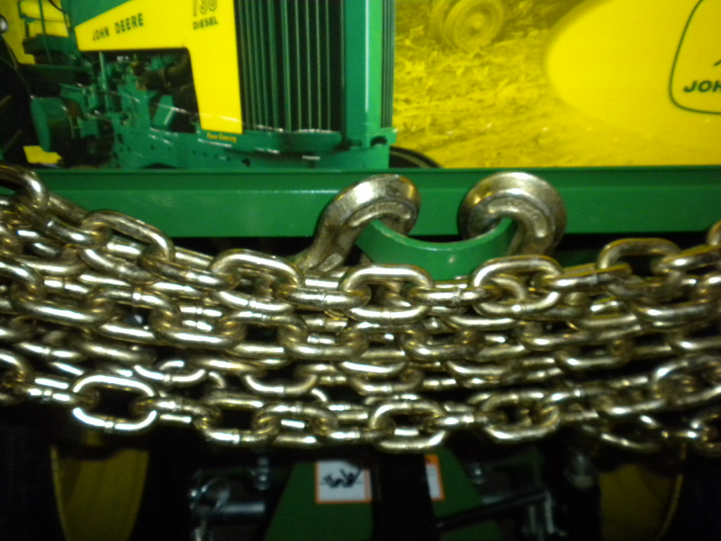

Chain carrier is a nice addition :thumbsup: I usually wrap a chain on the lower 3pt links when I need one.

Very nice work. Does your top-link hit when the 3PH is raised all the way?
1/2 Clearence from the chain hook holder, I measured for the box and mounted the ring in the middle not thinking, well got lucky it doesn't hit.
