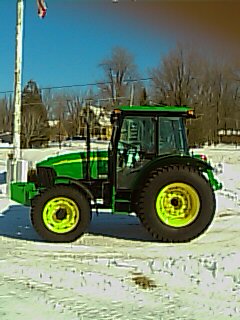

I have owned several tractors and decided about two seasons ago to step back from a utility tractor and back to a compact. I purchased a 3720 Cab. loved the tractor but always felt it was too tippy...particularly with the cab but regardless too narrow for its lenght and capacity. I very much got nervous mowing along hillsides etc. I therefore elected (along with a need for more HP for a new implement I purchased) to move up to a 4720 cab. Tremendous difference in stablity...a better tractor accept for one issue....there are less implements attachments available for the 4000 vs. 3000.
