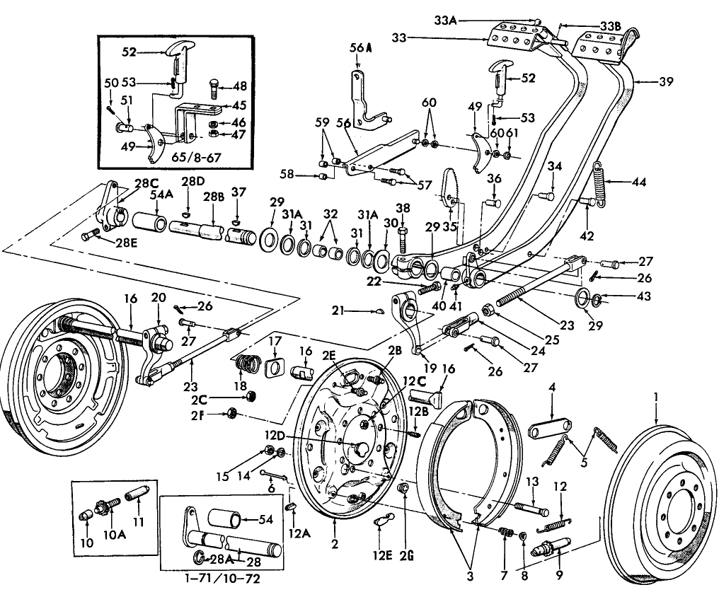

i bought a 3000 ford tractor 68 model. the parking brake is missing,would like to get replaced,any suggestion where to get one ,and pricing.
/ 3000 ford tractor,parking brake #2
Here's an exploded view of your brake controls, just in case you're not sure what all is missing.
I looked at a Ford/New Holland dealer site online, and just the little T-handle, #52 is right at $93.00. And the pawl, #49 is right at $25.00. Since it is such an important item on the tractor, you may want to buy all new, but may consider finding something at a salvage yard.
