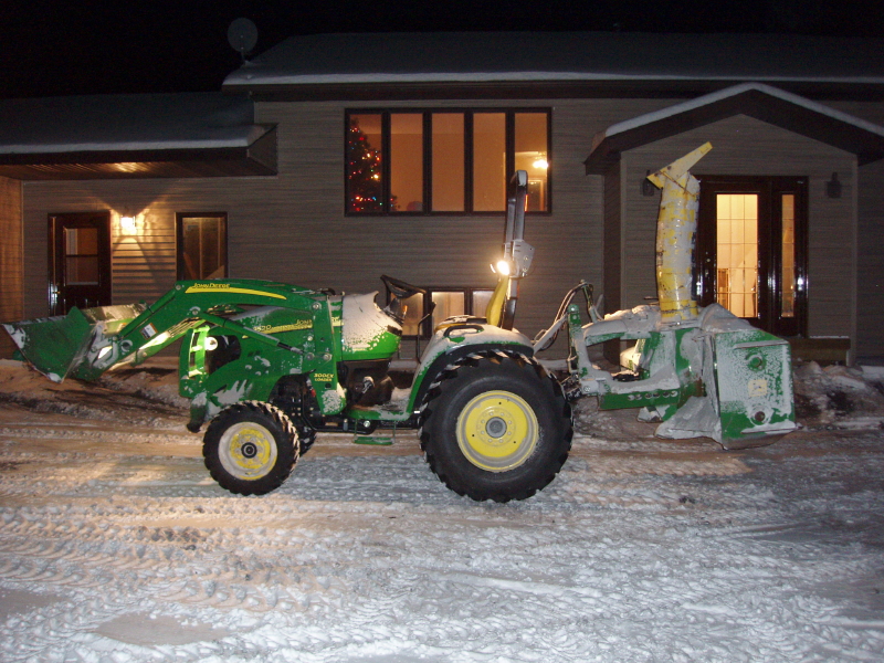

Has anybody upgraded from a 3000-20 non cab to cab model and regretted it?
I keep struggling with the idea of upgrading. Having a cab would be awesome for climate control and dust, but I'm just afraid that I'll give up too much versatility. I like the ability to go most anywhere I like and I don't want to make a mistake. Can't justify two units and they aren't convertible so...

Nobody?
OK, how about this question. Anybody with a cab regret going this route for lack of mobility? I use my Harley rake a lot and I like to hear it from the operator station. I'm sure I could fell it from inside a cab, but I'm worried about scrubbing the cab off on trees when I go in the woods...
