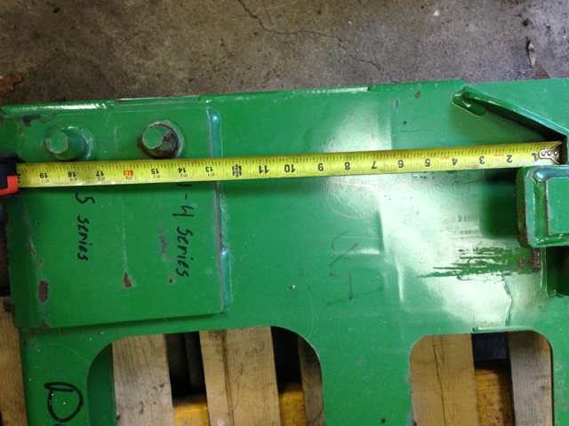

I have a chance to purchase a John Deere Pallet fork attachment that is built for a 400 series FEL. I'm wondering if that will fit on the brackets of my 300CX loader?

Yes 300 & 400 series share the same mounting size for attachments
/ 300 Series Loader - will 400 Series attachments work? #3
The John Deere pallet fork set I have fits from the 2 series all the way up to the 5 series.
/ 300 Series Loader - will 400 Series attachments work? #4
The pallet forks on my 430 FEL would not fit on my neighbors 5000 series, but I don't know the model of FEL he has. Came close, would hang on the hangers but would not match up to mate with the lower stubs to put the lock pin in..
/ 300 Series Loader - will 400 Series attachments work? #5
There is some good cross-reference info here also: Pallet Fork Sets
/ 300 Series Loader - will 400 Series attachments work? #6
300 and 400 are the same, as already noted.

Thanks for the confirmation. I took a tape measure with me and all info provided here is correct. Unfortunately the sale went very high and the Pallet Forks went for nearly new cost. I didn't get the bid.
