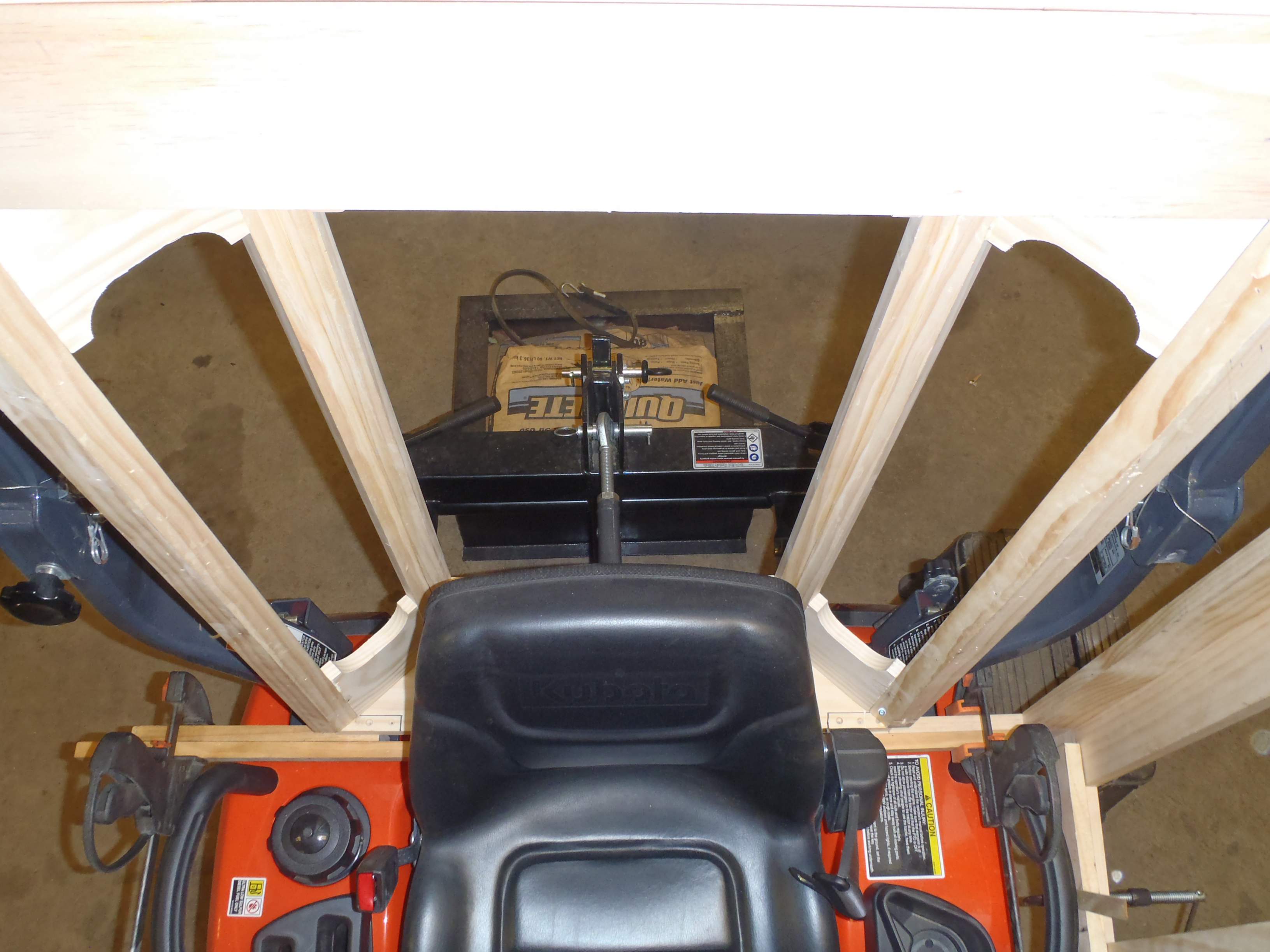

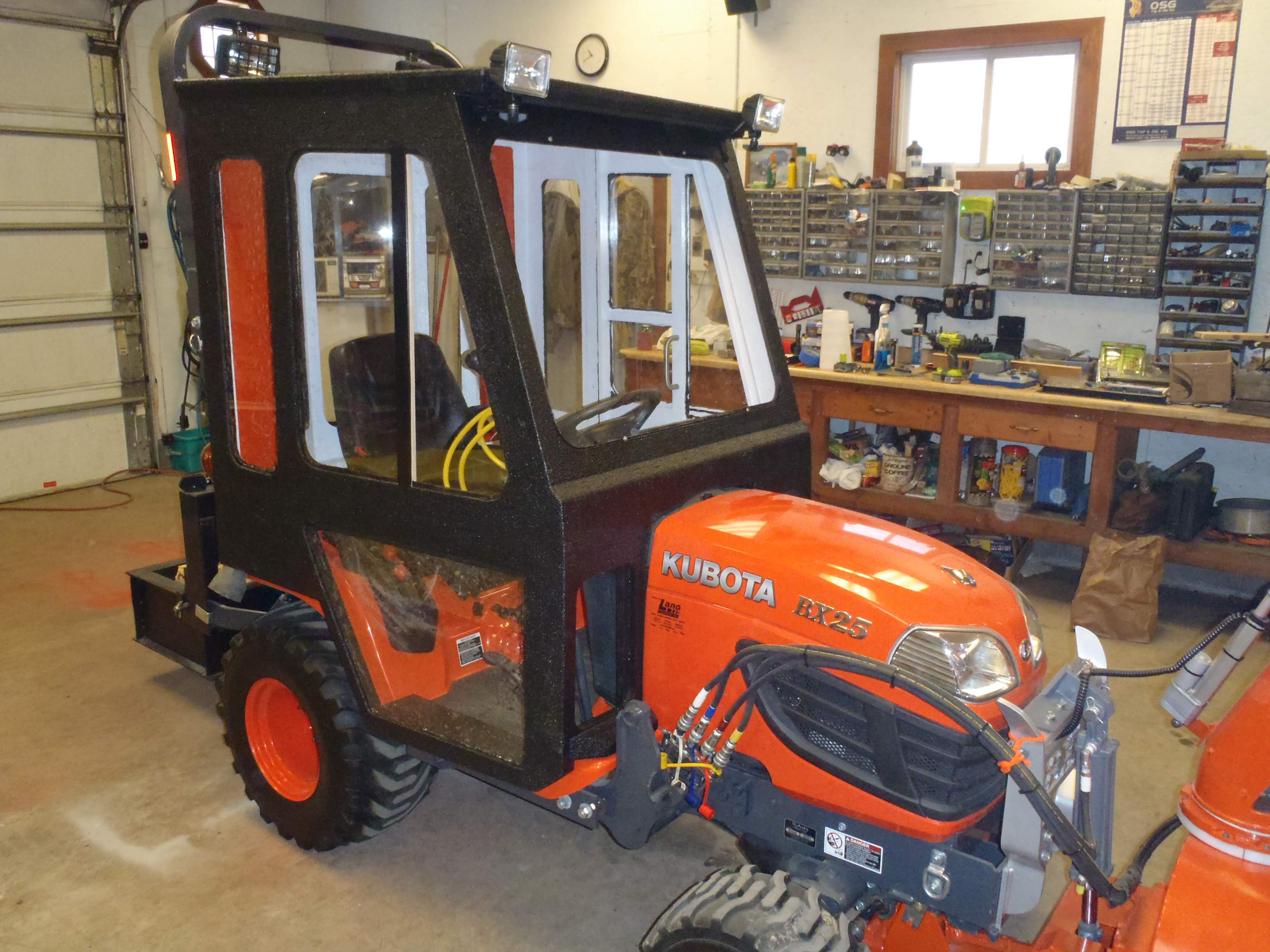

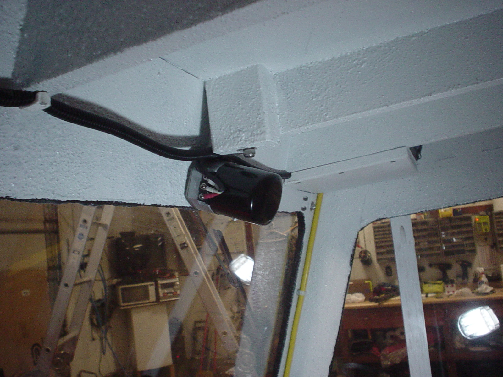

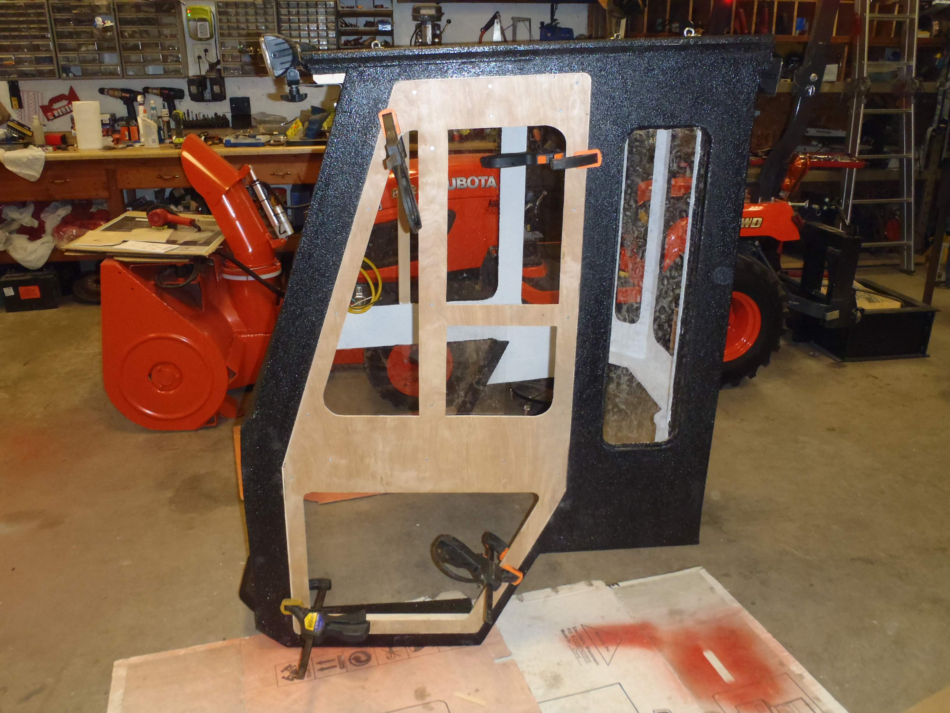

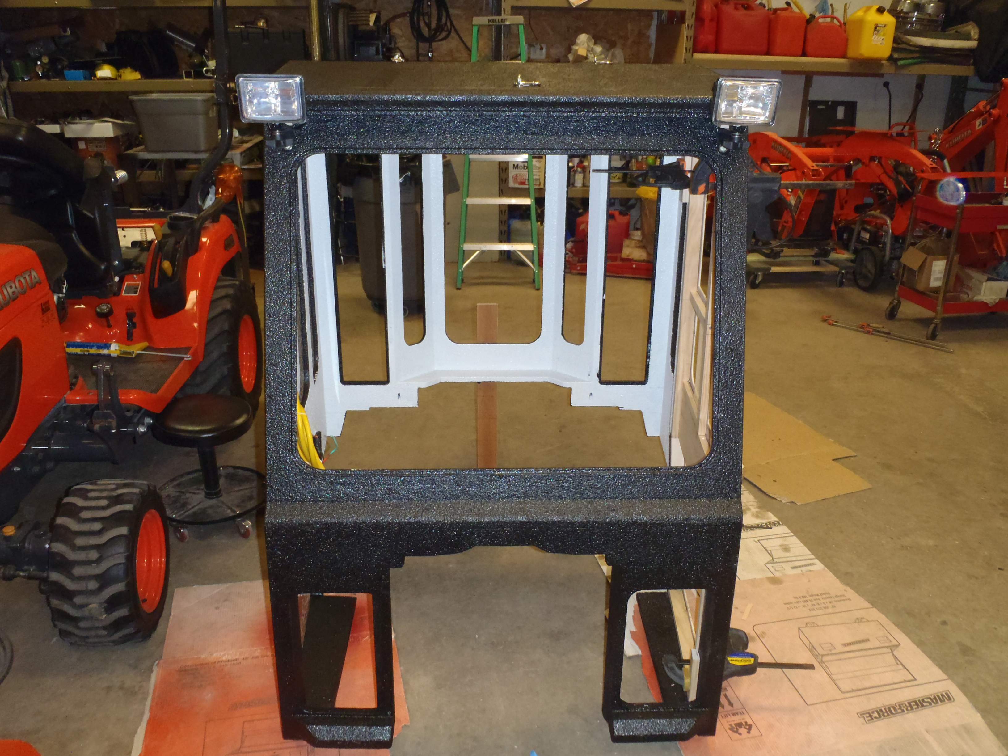

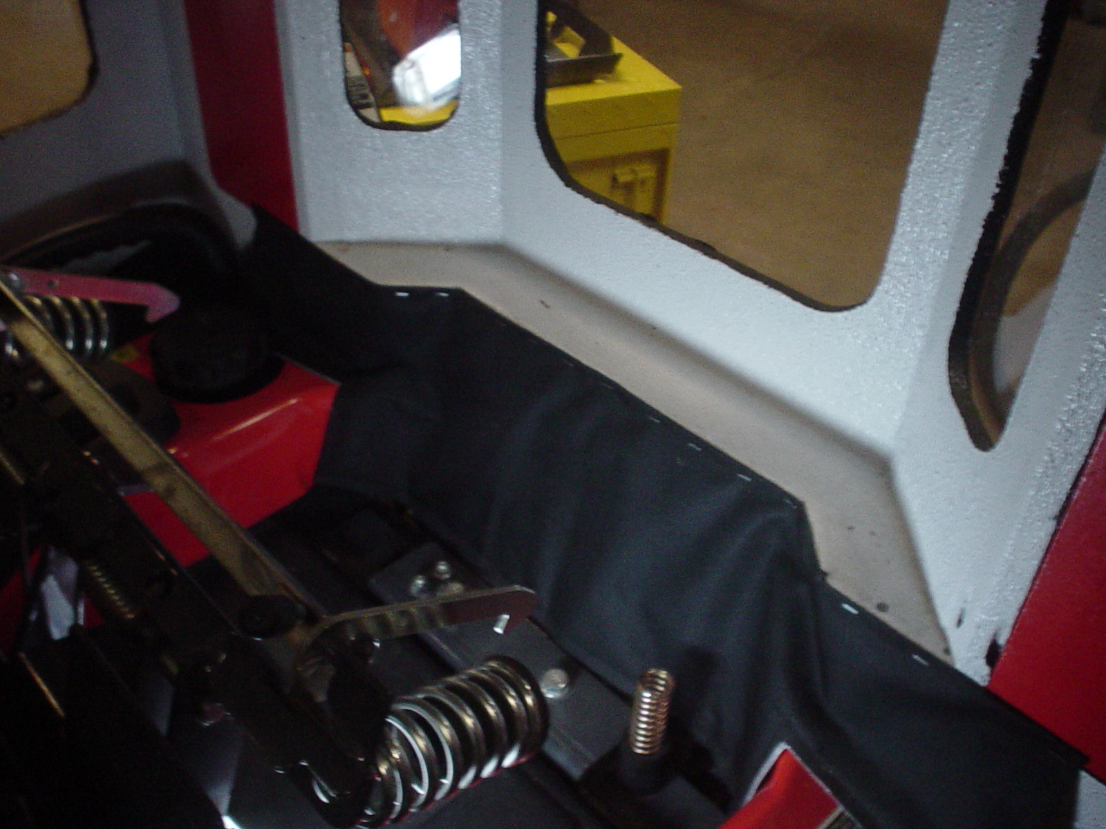

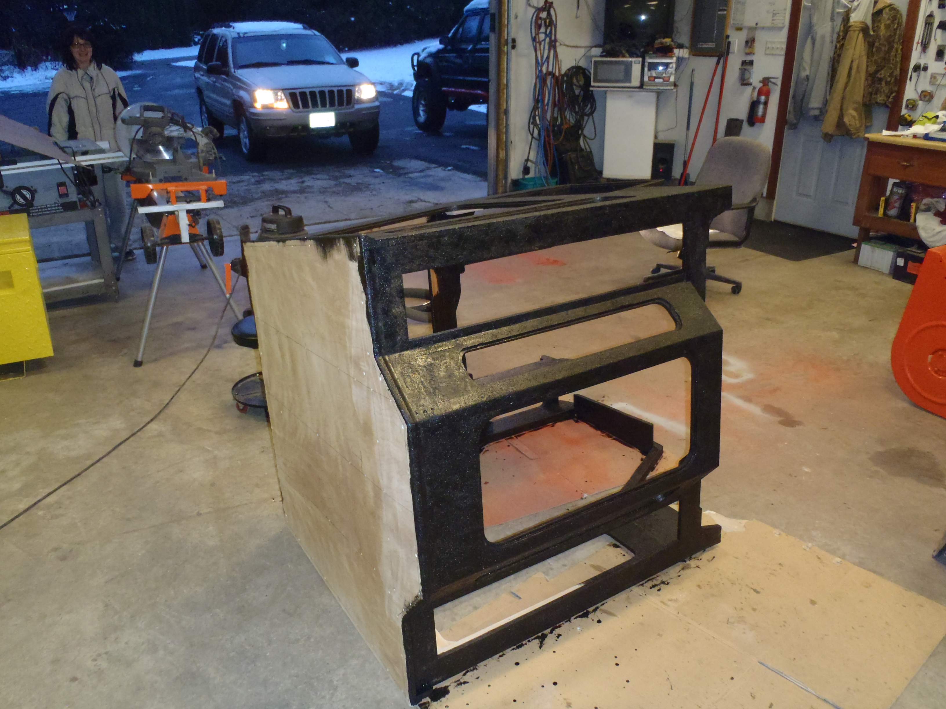

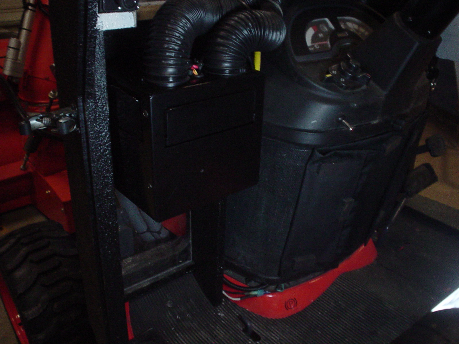

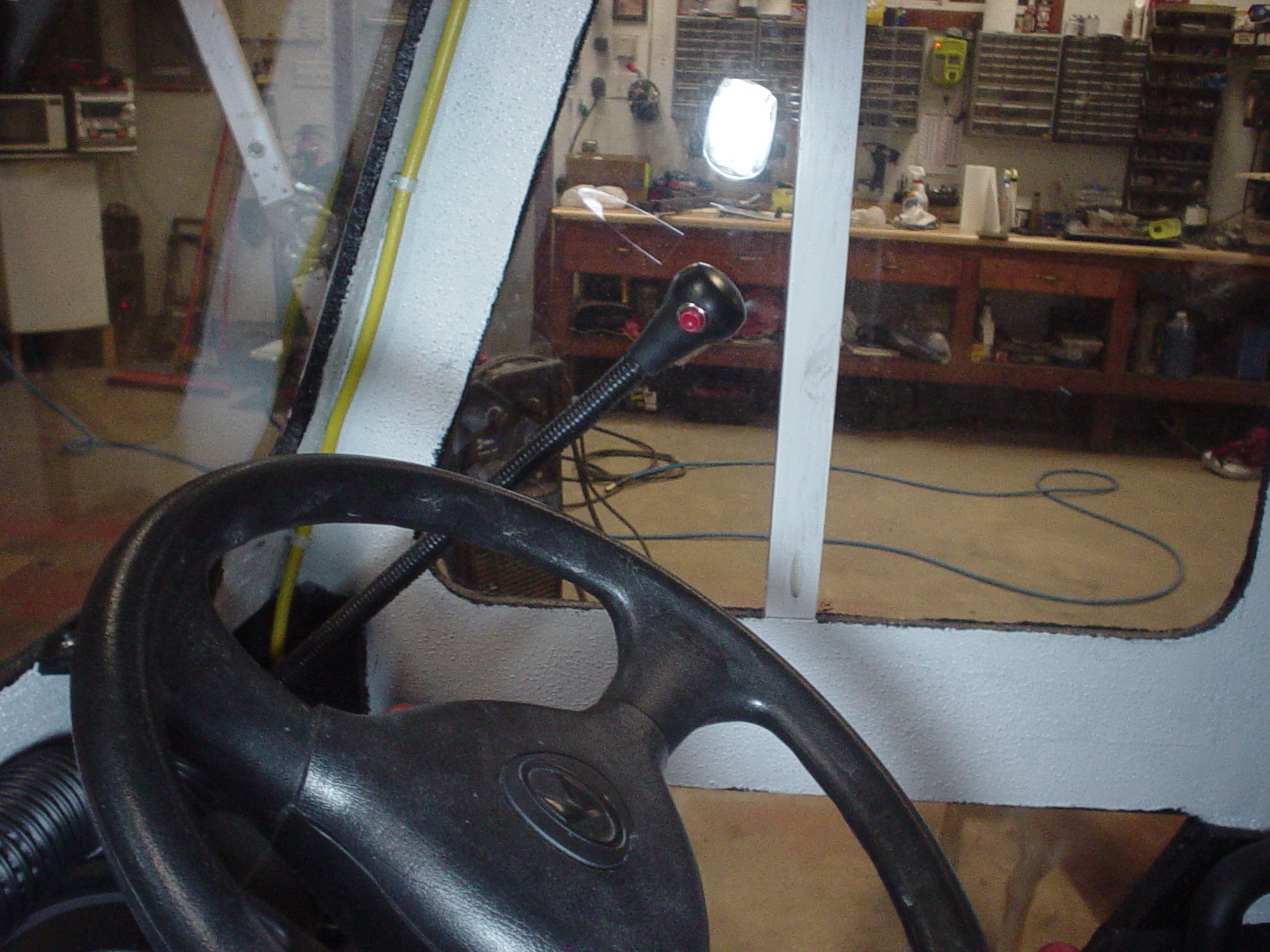

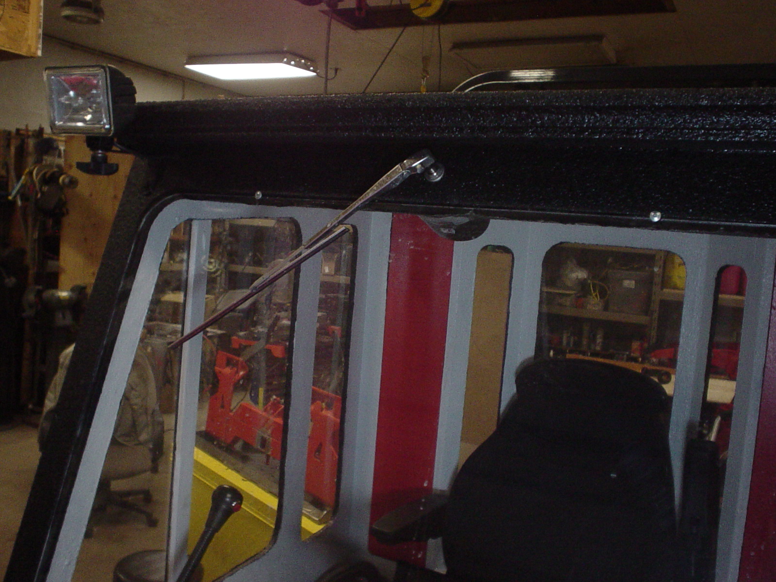

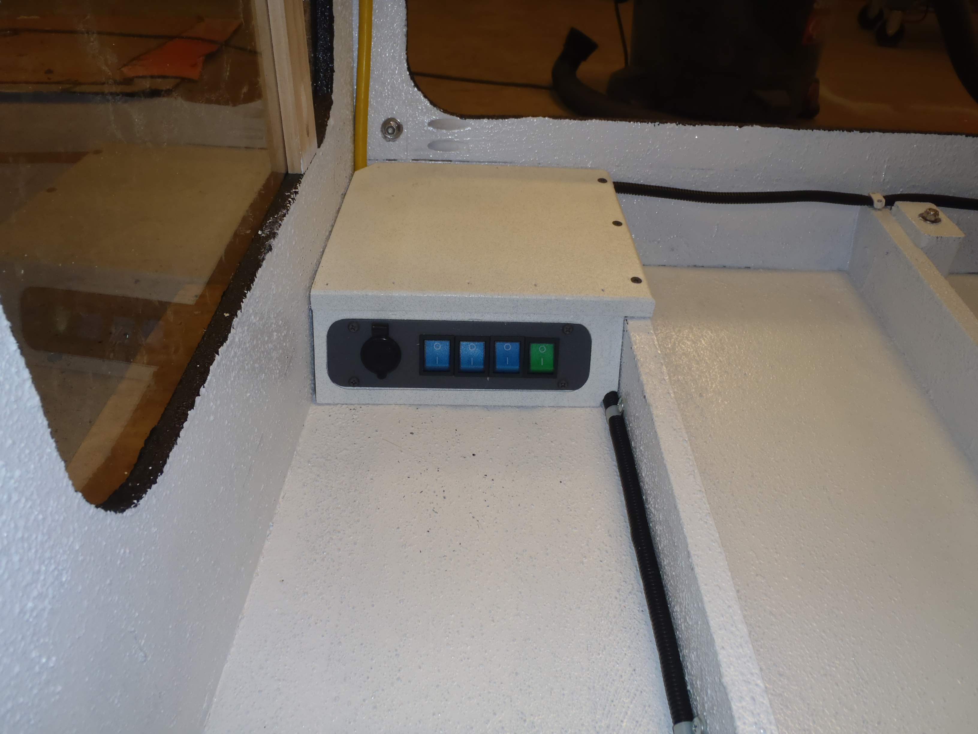

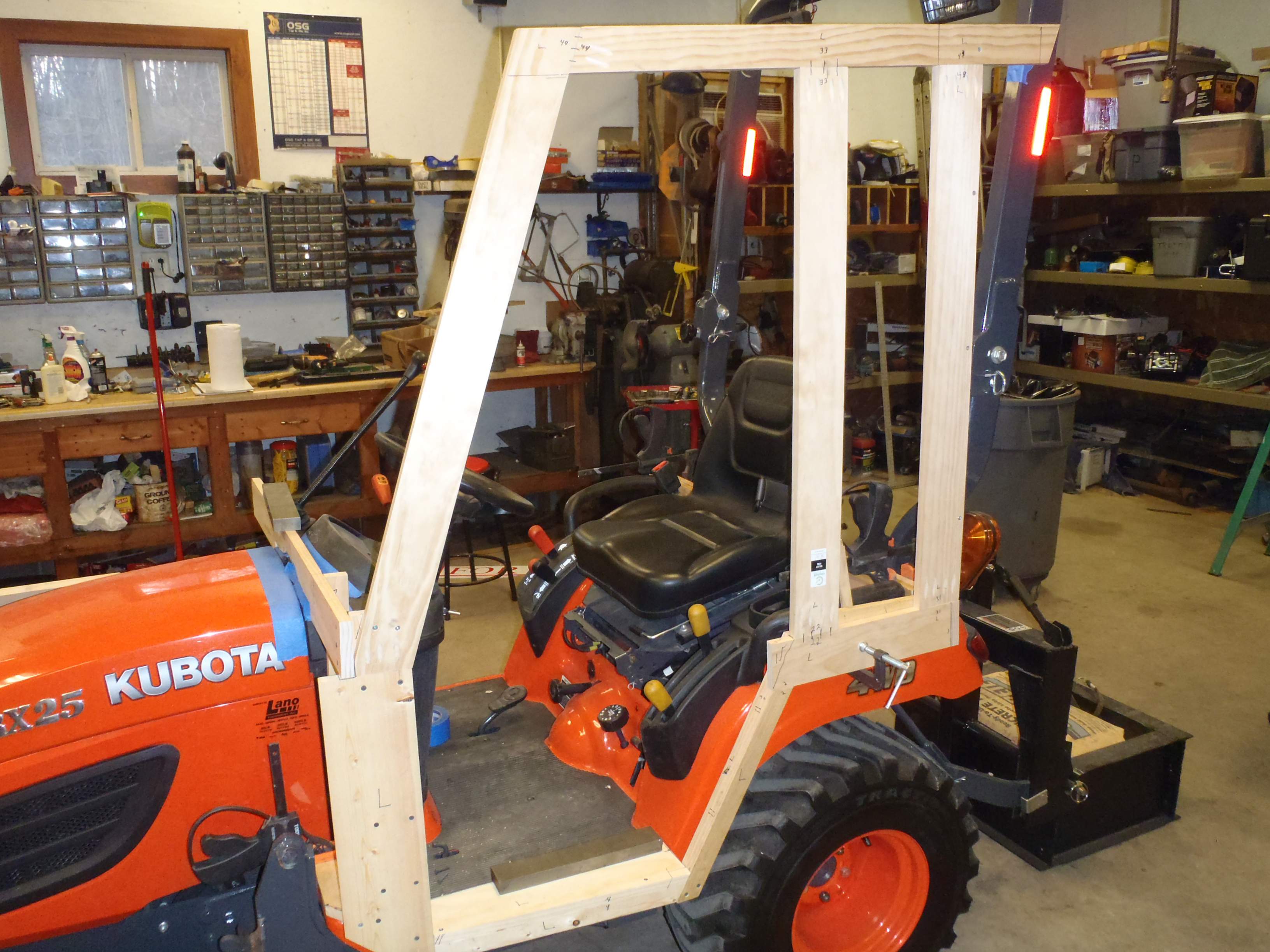

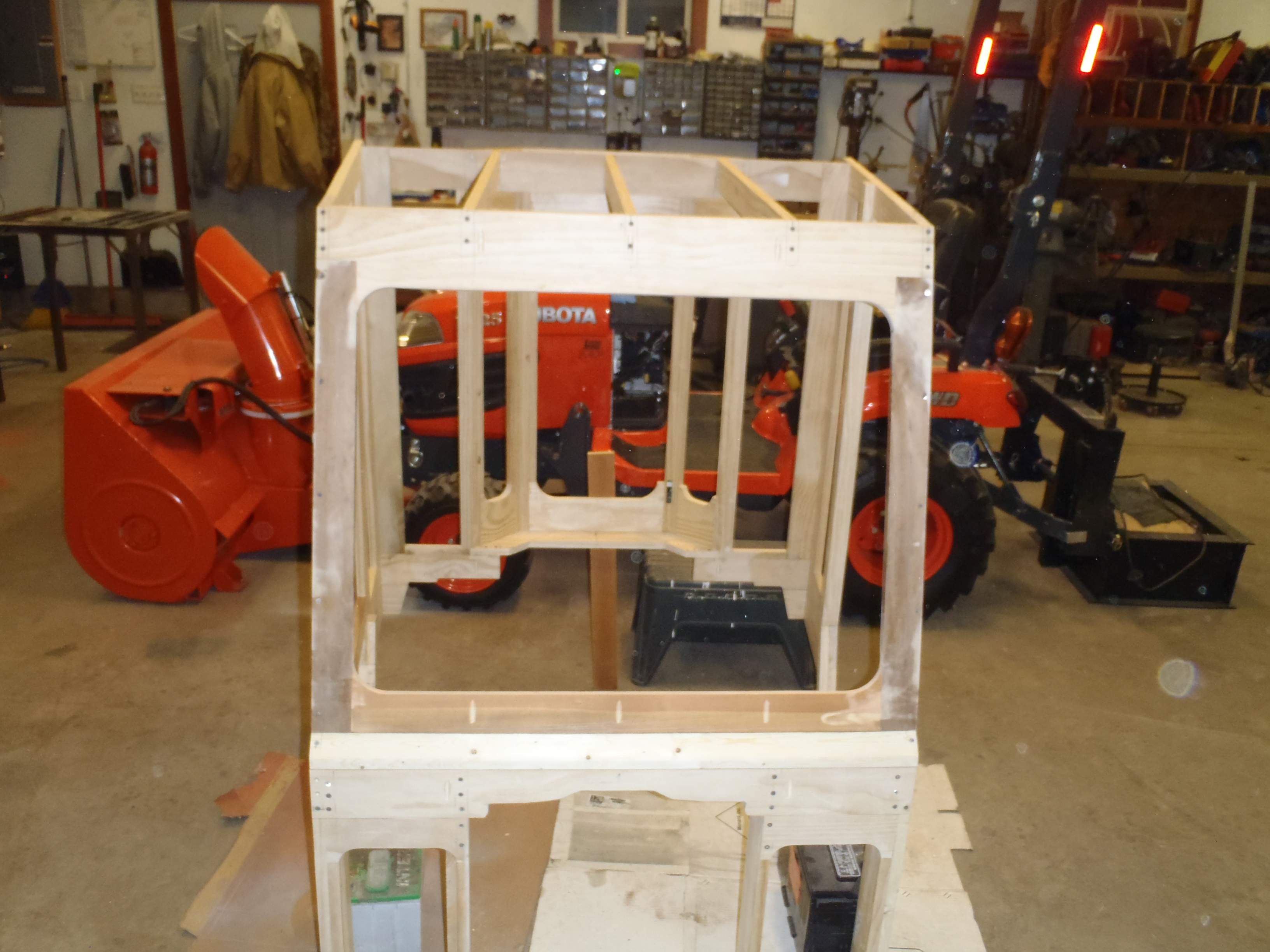

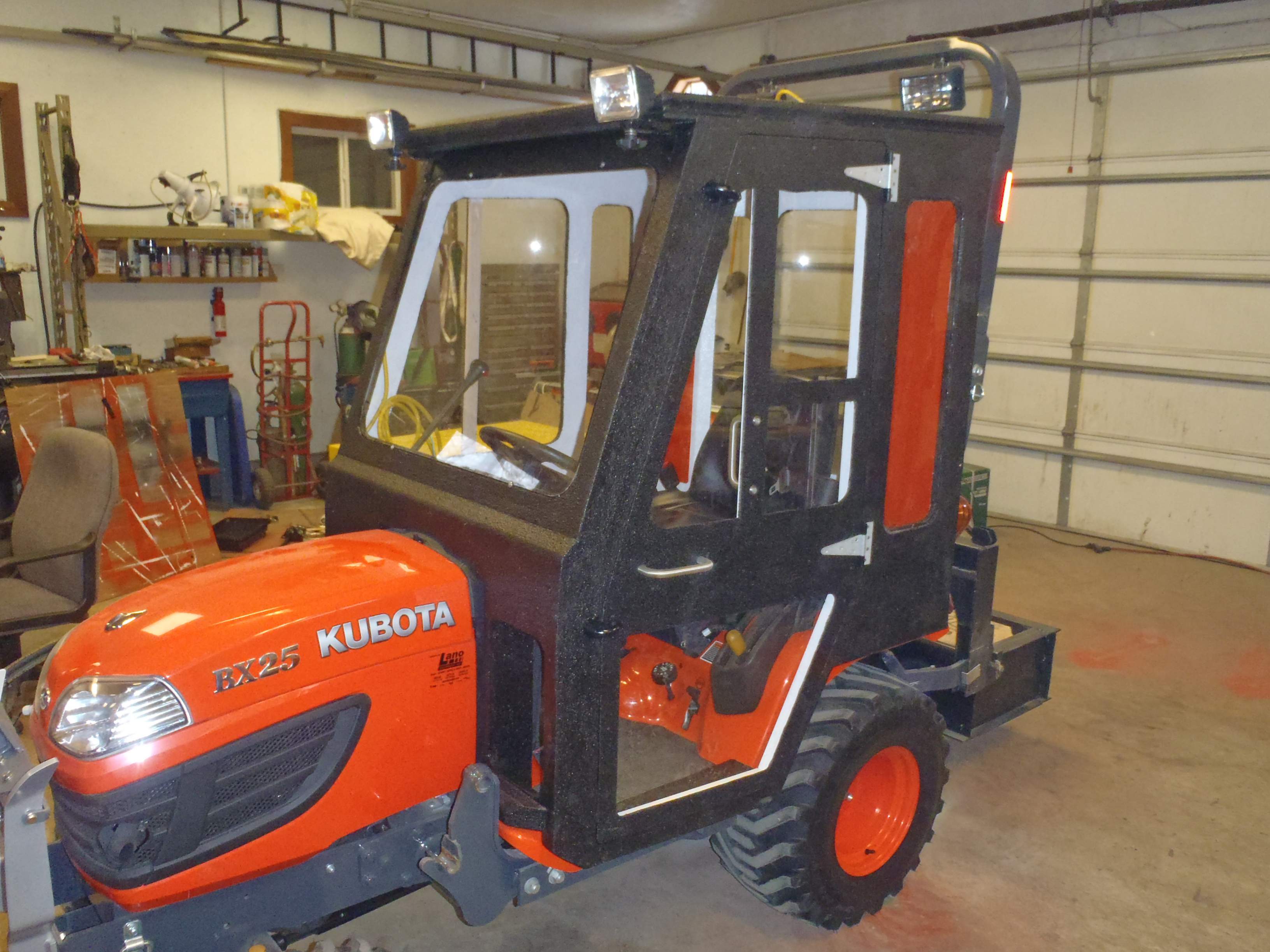

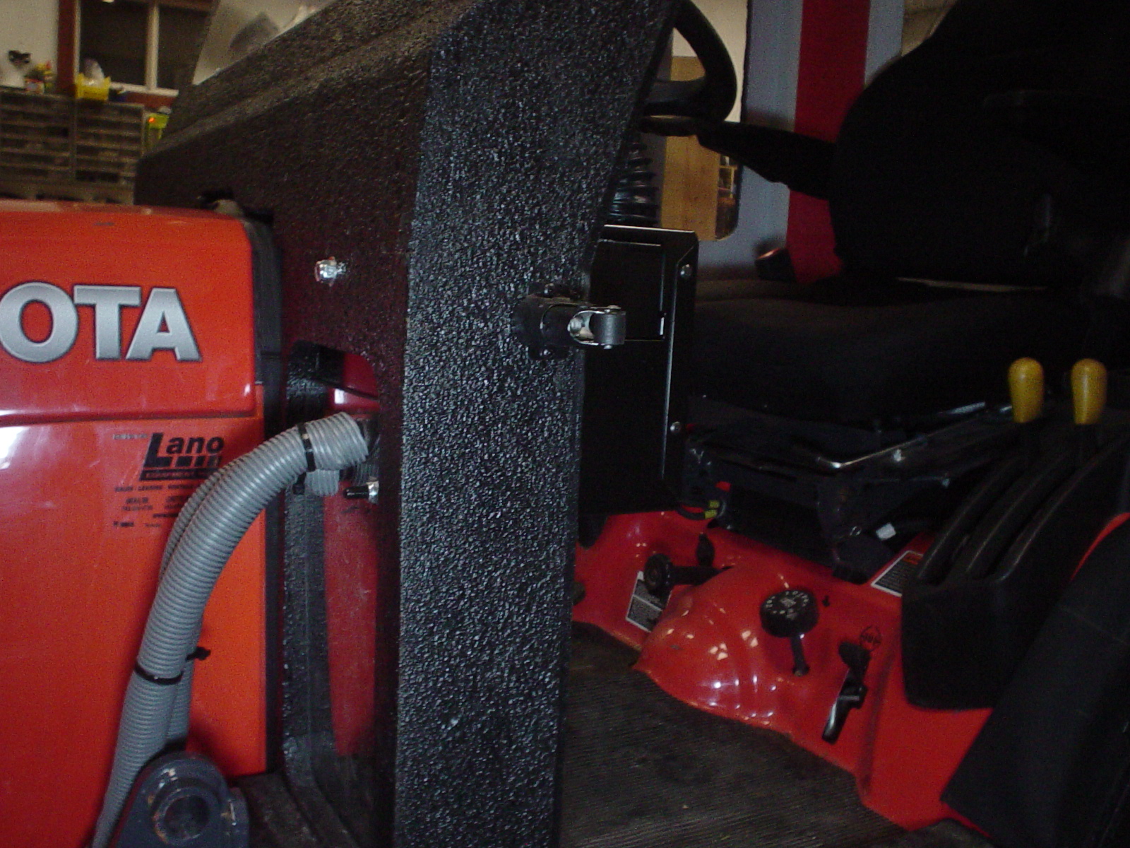

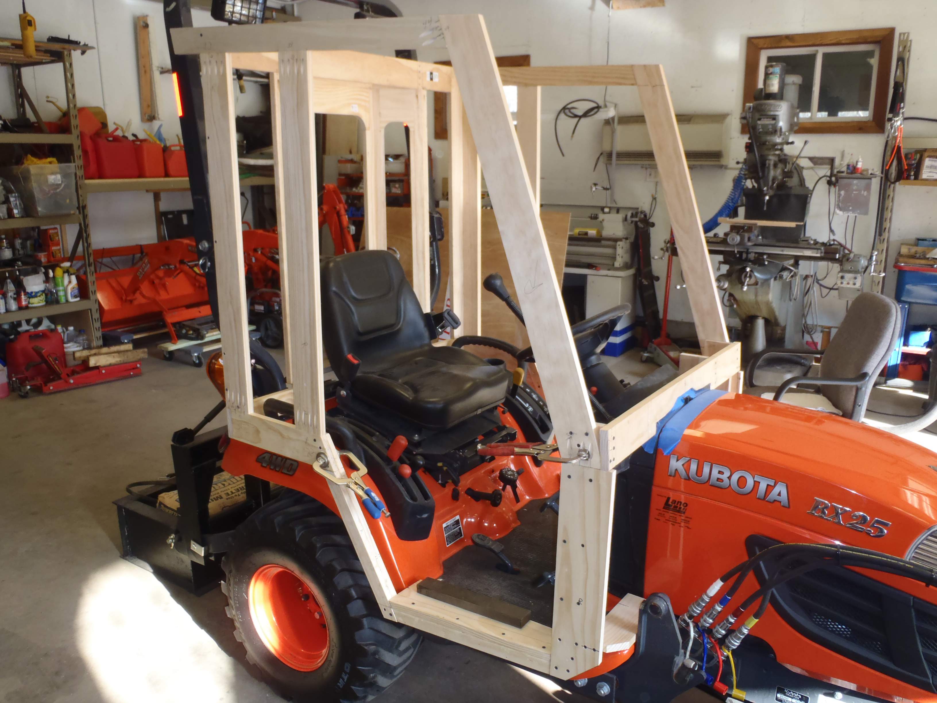

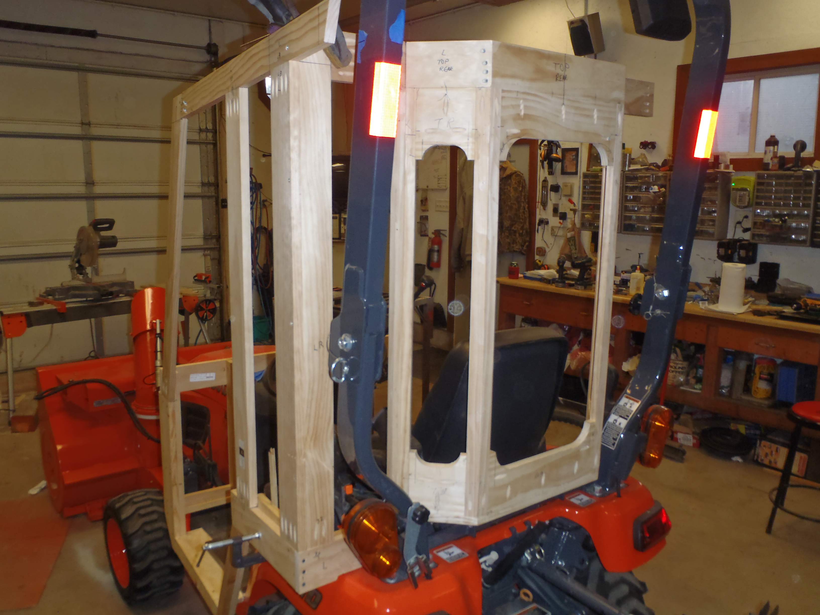

I built this cab 2 years ago. It has held up great to the weather. I do only use it in the winter though. It is made out of clear pine and 1/4" luann plywood for the roof. All joints are pocket screwed and filled with plugs then sanded down. I routered out for the windows, then used 1/8" plexiglass except for wind shield 1/4". I used 1/8" steel plates under the boards that sit the floor boards so they can't break off, then covered that with thin self stick foam. The cab stays in place by gravity and the way it is cut to fit. I used pieces of rubber in the back corners so it won't rub on fenders. I made a little switch box for light switches / wiper and 12volt accessory outlet. Added an interior cab light. The wiper is for a boat. It works good and has self park. The electrical is fused and has relays controlling all functions and is plugged to tractor by #12 SO cord with 2 prong trailer connector. I used screen door closers to hold door shut,they work a lot better Than I thought! I have lights both forward and rear facing for plenty of light. Put Cordura fabric around the base behind the seat and along the fenders to help keep out the wind, not that it is a problem .Also made a cover for radiator intake that uses magnets to hold on. This way I can control the air flow depending on temp. I finally installed a heater really only to keep windshield clean. I covered the whole thing inside and out with 3 coats of Hurculiner truck bed coating, then painted over inside with Rustoleum white. There is 3 eye bolts in the roof so I can lift it off from hoist in my garage ceiling. The whole thing ways around 100lbs if that, and around $300.00 without heater. PB210324.jpgPB210326.jpgPB210327.jpgPB220329.jpgPB230339.jpgPB250354.jpgPC010366.jpgPC030368.jpgPC030372.jpgPC090374.jpgPC090375.jpg
It came better than I expected for no drawings and a bored weekend with nothing better to do.
It sure makes it nice when blowing snow. NOW JUST NEED MORE SNOW!

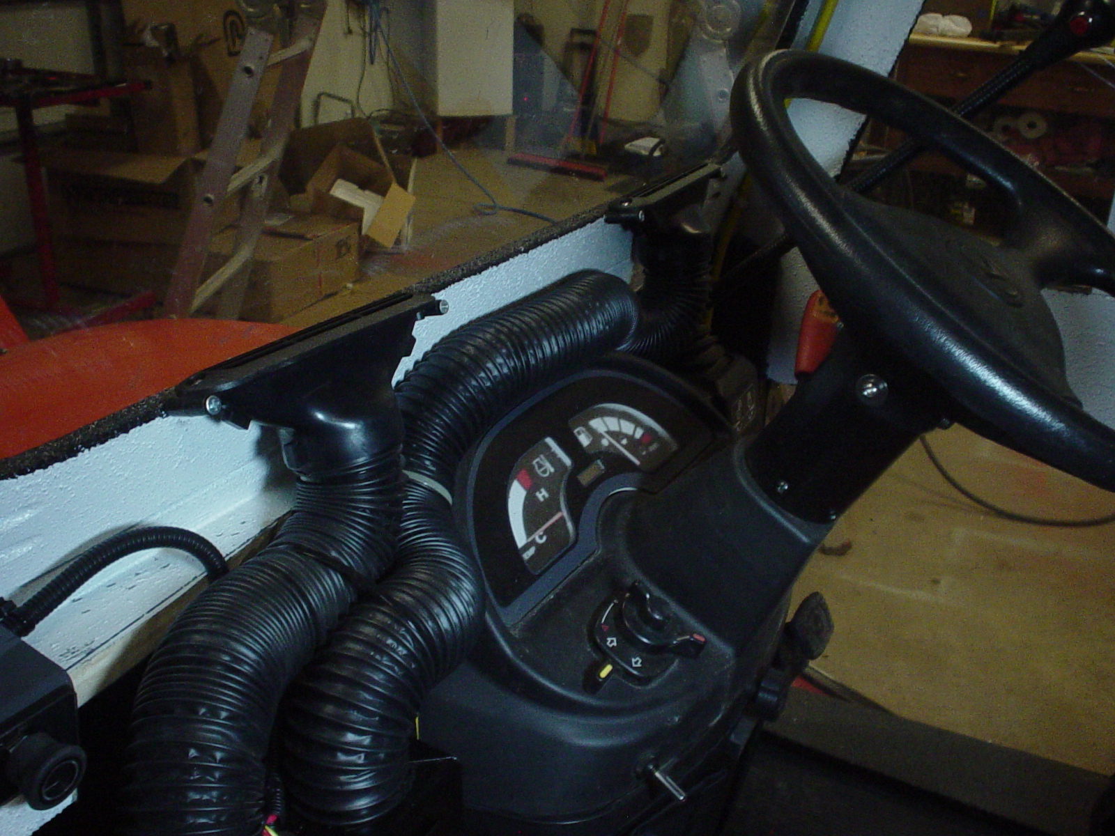

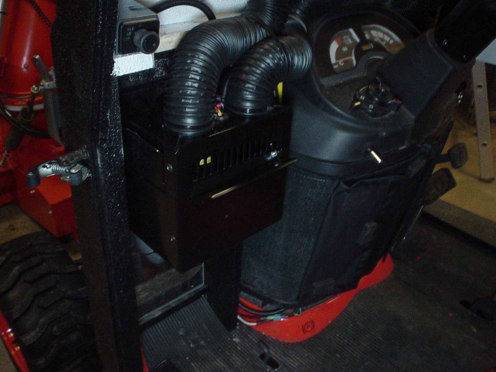

Great project. Looks like you hit it right on. I have wished I could do something like that, but because of my loader mounts and joystick location, it just would be too tricky. You should post photos showing the heater set up and wiper, too, since most of us would be interested. Enjoy!
/ $300.00 BX25 Cab
I will get some more photos if I can Find Camera.

Very cool... nice design detail for the rear side of cab. I'm impressed if that was just a one weekend project with no plans! :thumbsup: Can't beat the price!

Looks good!! This has probably been brought up before but it just popped in my head...
Ever think about reversing the air flow through the radiator to blow the warm air into the cab? A reversable fan would be great but would be quite a project.
EDIT: I done a little searching on the fan reversal idea... I stumbled across a post that mentioned there are two plates you can remove under the battery to allow air to be drawn in there so you can completly block off the grill and prevent cold air being drawn into your cab. This combined with your heater should have you quite comfortable!

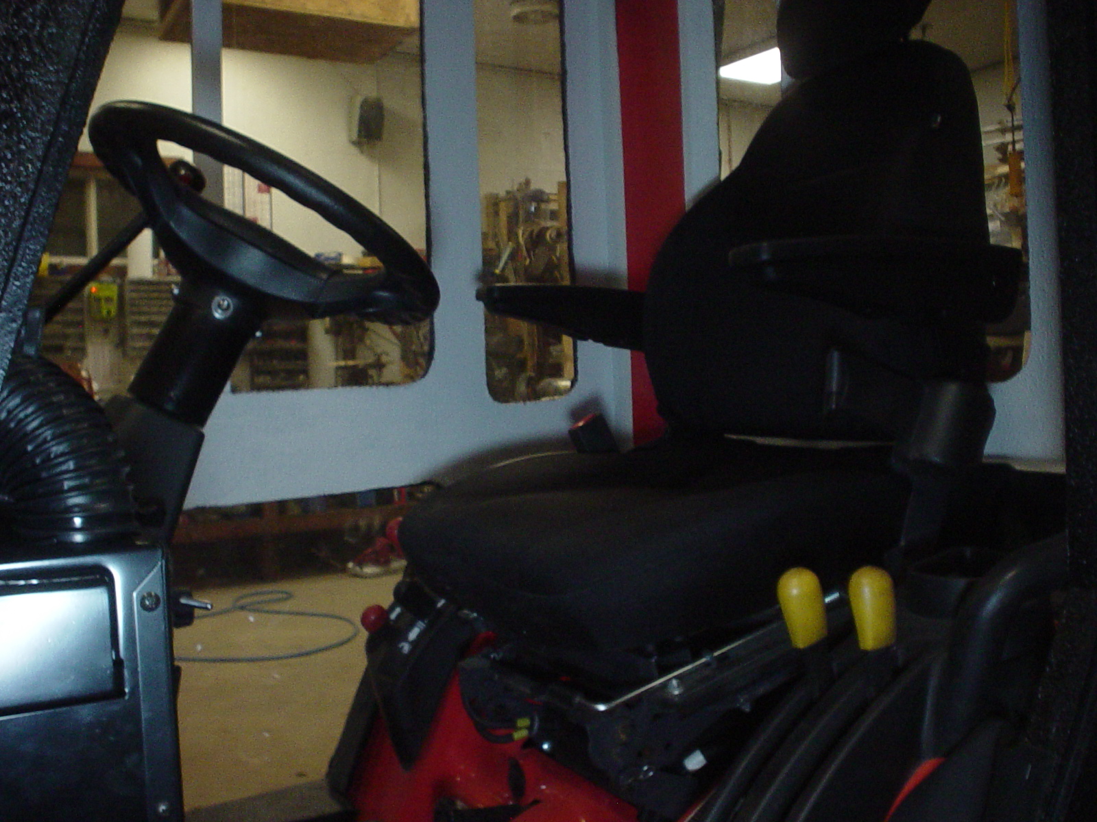

Looks real nice, I personally would have picked a darker grey color for the inside,
but she looks real nice.

Very nice. I wish I had your wood working skills. And I especially like the looks of that seat. Is that a bolt in replacement? Can we get the particulars? Thank you for sharing. Glad you started posting.

honestly, it doesn't get that cold in it anyway. Usually I don't even wear gloves. Heater is really only for defrost.

Very nice job.
How does the plexiglass hold up against scratches esp with the wipers?
/ $300.00 BX25 Cab
#16
Its been 2 winters. So far so good.

Nice build, why did you cover up the nice woodwork with bedliner? I'd need 8 layers of bedliner to hide my crappy joints!!!
