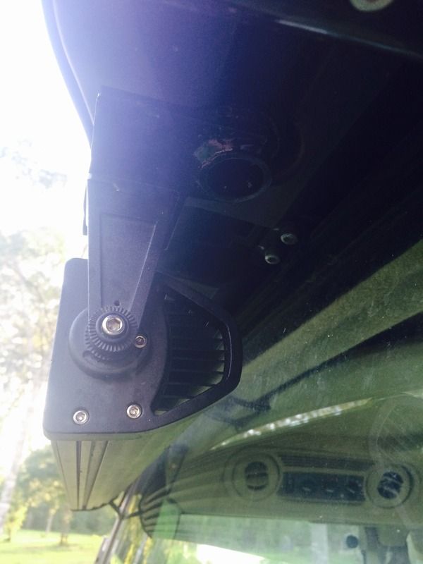

Great job. I would like to see some close up pics of the mounting bracket if you have time to post a few pics of it.

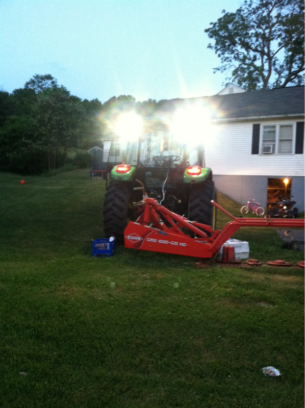

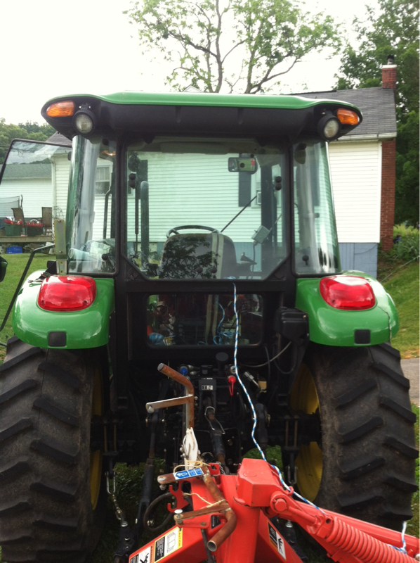

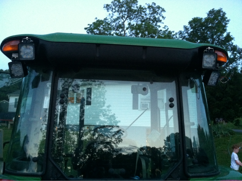

You inspired me this morning, I went and put four new lights on the back of my 5083. The picture at a distance is 100' at 10:00 pm.
I'll try to snap some tomorrow. I'm sure there's an easier or better way to do it and if I made another set I know what I'd do differently but it works really well
That made a huge difference. Looks good! Anything for the front yet?

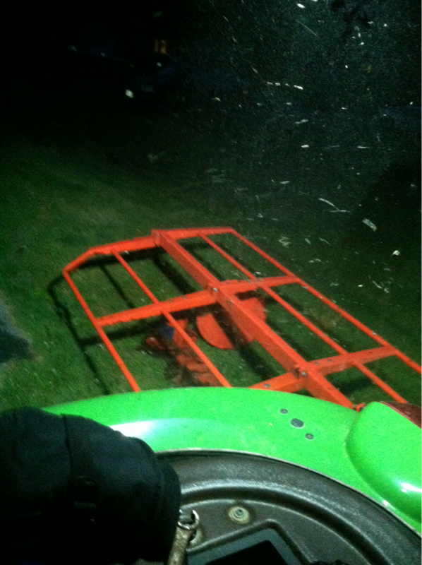

Planning on a light bar similar to yours. I will leave the forward lights I already have though and go with a narrower light bar. I also realized I need a flood mounted on the front right cab corner to light up in front of my mower better.
I can see the mower great, it's the area in front of the mower that's the problem now.

What are we seeing in the pic? I'm thinking the green is a fender of the 5083, but what is the orange attachment ??
   / 30" LED Lightbar install on 5 series cab tractor #18
The orange attachment is my Kuhn gmd600 hd disc mower. The curtain is removed to be replaced. That is a view out the side rear window of the 5083.
Not the best pic. I used material I had around the house. 1" sch 40 pipe with a plate welded at the top and drilled for bolt. Fire hose washer for abrasion/vibration resistance. 2" flat bar coming off pipe and another piece of 2" welded perpendicular.
Brett
