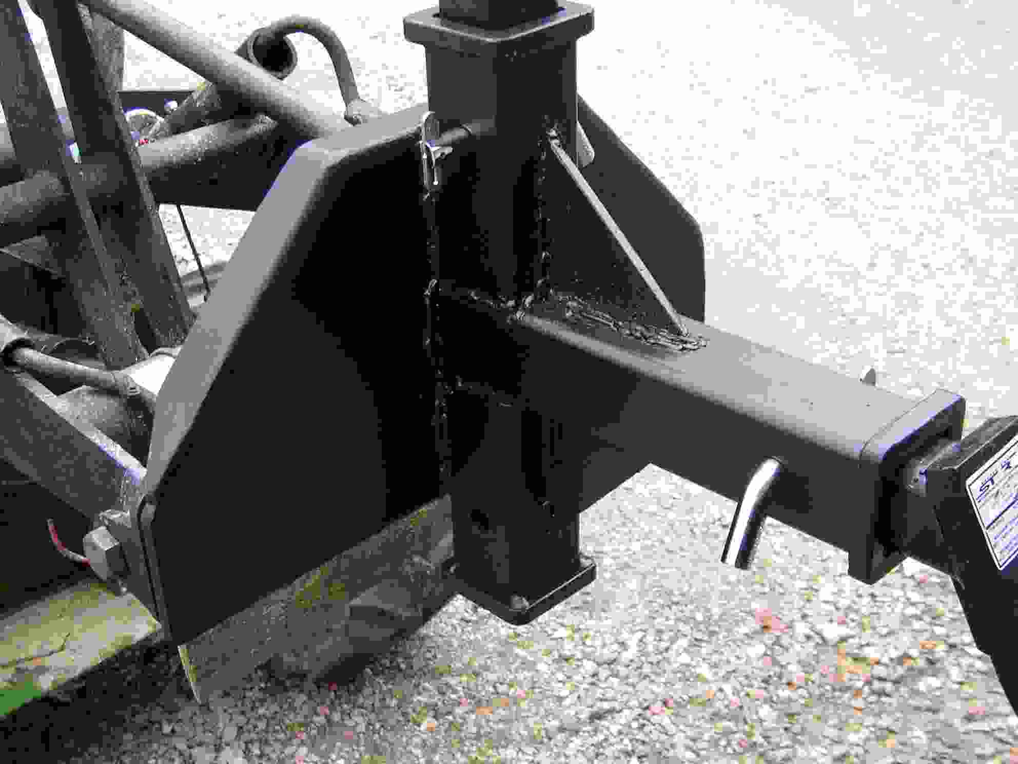

Today I welded three two inch receivers to a quick attach plate. I used one that is 12 inches long and it sticks straight out. I made it longer so I could see the ball when attaching to the trailer. The other two are six inches long and one goes up and one down.
See attachment

Pardon my welds, but I have never taken a class, just read a book.
I hope this is strong enough. I did not put any reinforcing brackets, hoping that the three receivers would reinforce each other. What do you think?
I did not realize it while designing this, but the top receiver makes a good storage place for attachments not in use.
Now I need to come up with some other attachments with two inch receivers. Any suggestion?

I would add some 1/2 in gussets to the top and bottom of the 2 in receiver. 4 in triangle should work fine. What is the purpose of the bottom receiver? You could put a ripper in there, or a pipe puller. The top receiver could be used for a goose neck trailer. A log splitter assembly could be used in the front receiver. You might get 400 to 500 lbs load holding capacity.
/ 3 Way 2 inch receiver
I will add some gussets. Do you mean 1/2 inch thick. Wow! I have some 1/4 plate. Is that enough? Also do you mean connect the middle receiver to the top and bottom receivers with this gusset?
I was thinking that the bottom receiver would be good for a root or dirt ripper. I have some old brush cutter blades. I was considering using one of them, cut short to 18 inches or so. How does this sound?

On most of the hitches that I have seen, the gussets are 1/4 in for a 300 to 500 lbs load, but I thought that if you were to try and lift the maximum weight of 800 lbs with the receiver, then a stronger gusset might be appropriate. Just use what you have or double up.

I added the gussets today using 1/4 inch steel. I think with the middle receiver supported and welded to the top and bottom receviers and then adding two gussets it should be strong enough. It certainly is stronger (assuming my welds are OK) than the PT version. I have attached a photo.
J_J, thanks for your advice on this and other areas.

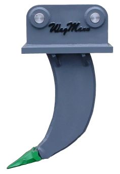

That does look stronger. Did you say what the top receiver was far, other than storage. You might be able to adapt a ripper shank like this for the bottom.

J_J, I don't have a specific plan for the top receiver. A boom pole comes to mind, but I have the minihoe and that does a pretty good job as a boom. I do need a ripper for the bottom.
