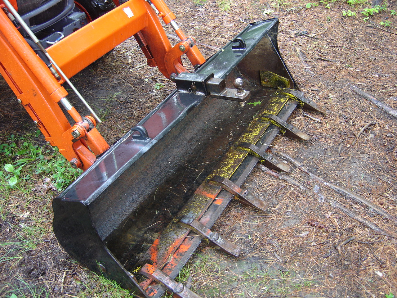

Here is another option. It keeps you from hurting your neck!
