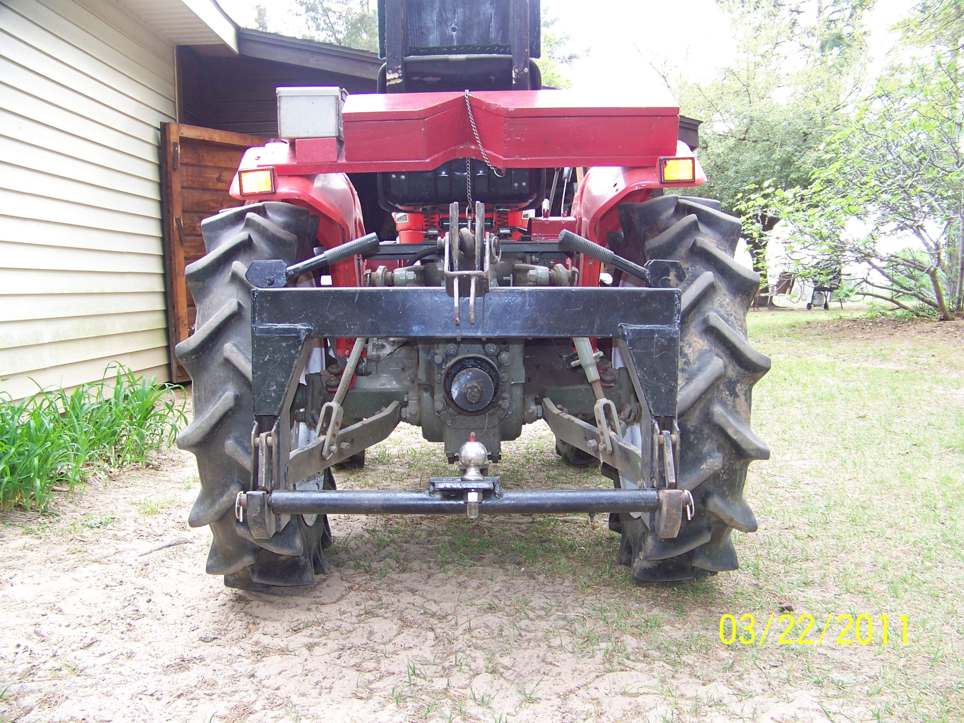

I need to move some trailers from time to time around my property. Some accept a 1 7/8 or a 2" in ball and one has a pintle hook. So I deally I would like to use a receiver tube set up allowing me to swap out different hitch set ups.
What have others done? Can you include pictures?
/ 3 pt Towing a trailer ideas needed #2

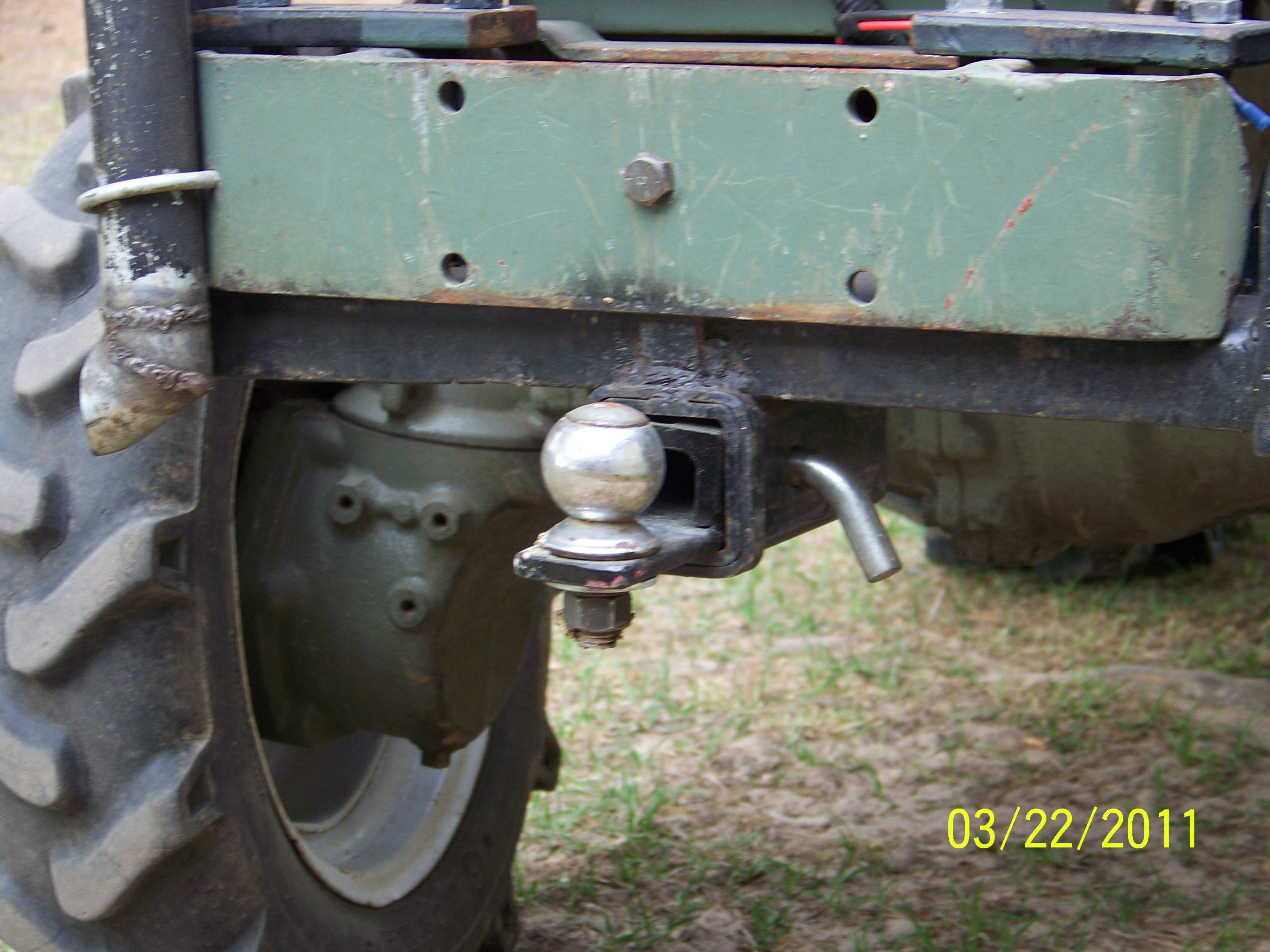

I just got a short piece of receiver tubing, and welded it onto a 2x2 piece of box tubing, with the same material going up to the top link mount. Whatever hitch you need slides in and pins, just like on a pickup receiver. I welded a couple cut off 7/8 bolts on the end I had drilled for pins. Mine looks about like this: Flexpoint Adapter Turns Your 3-Point Hitch into Versatile 2in. Receiver, Model# FPHS-1 | 3-Point Hitch Adapters | Northern Tool + Equipment
I put my receiver tube underneath the cross piece, and the bolts on top. It's ugly, but it lets the ball get very low, so I can place it underneath a trailer that has sunken into the dirt if it's rained, or whatever. It's a pretty good setup. I use it for moving trailers around so I can mow on it, so I actually just use a 1 7/8 ball the whole time. I don't have anything with a pintle hitch, but the the smaller ball may go in there anyway. If I were doing more than moving them forward and backward 30 feet I'd hook them up properly, but I'm just using it to move them short distances to get behind and underneath to mow.

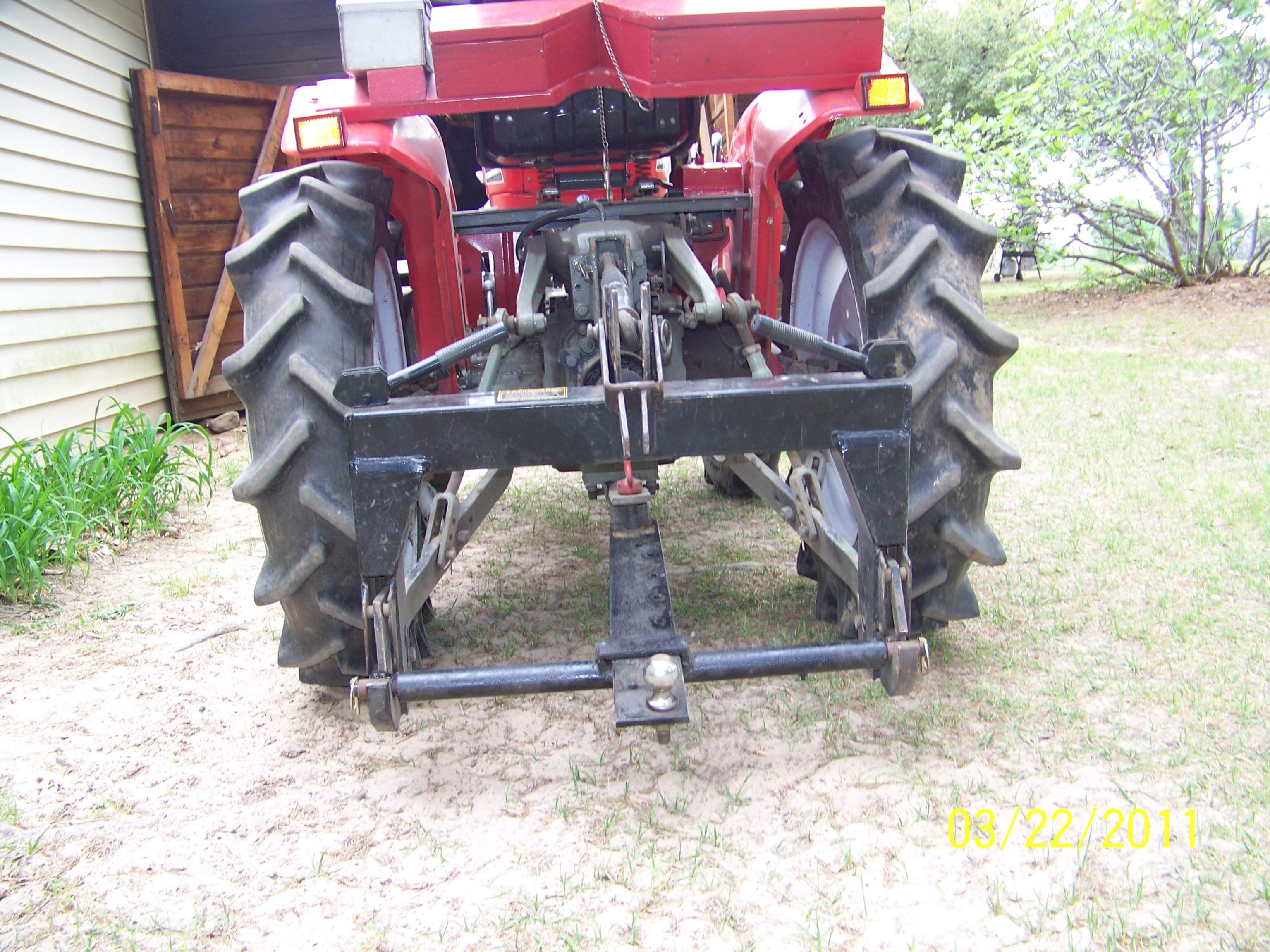

I built my hitch receiver so that I could lower it all the way to the ground, to get underneath any trailer that I needed, without having to jack it up. A benefit for you might be that you could lower the hitch to the ground and use it as an emergency anchor to slow down if your hills are that steep.
/ 3 pt Towing a trailer ideas needed #11
I use that Harbor Freight hitch with most of my implements. Had to adapt several to fit it but it's worth it to me because I change regularly. I also have this Hitch Mount Vise Plate Harbor Freight piece with a little winch mounted on it. I have matching plugs on tractor and winch so it is a quick mount. It goes in my front receiver. Here is my back hitch at a couple of different heights.
