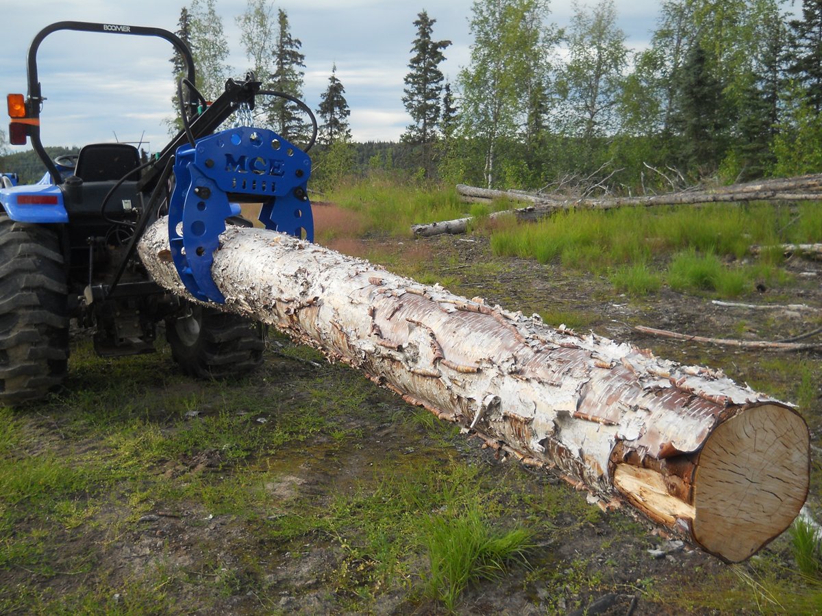

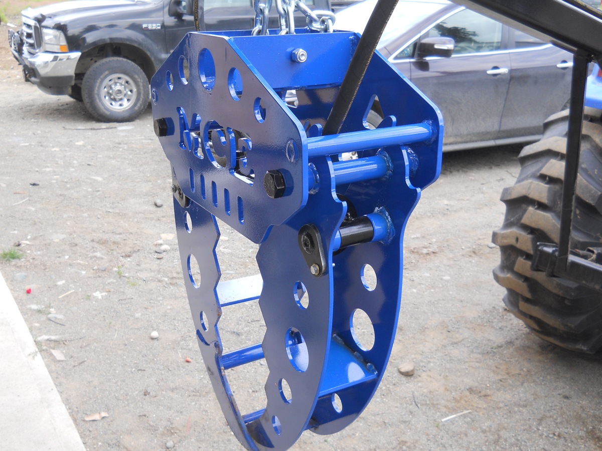

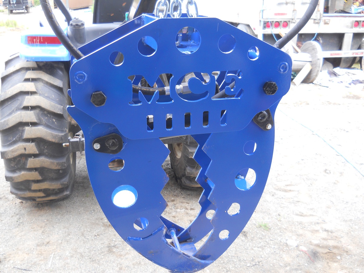

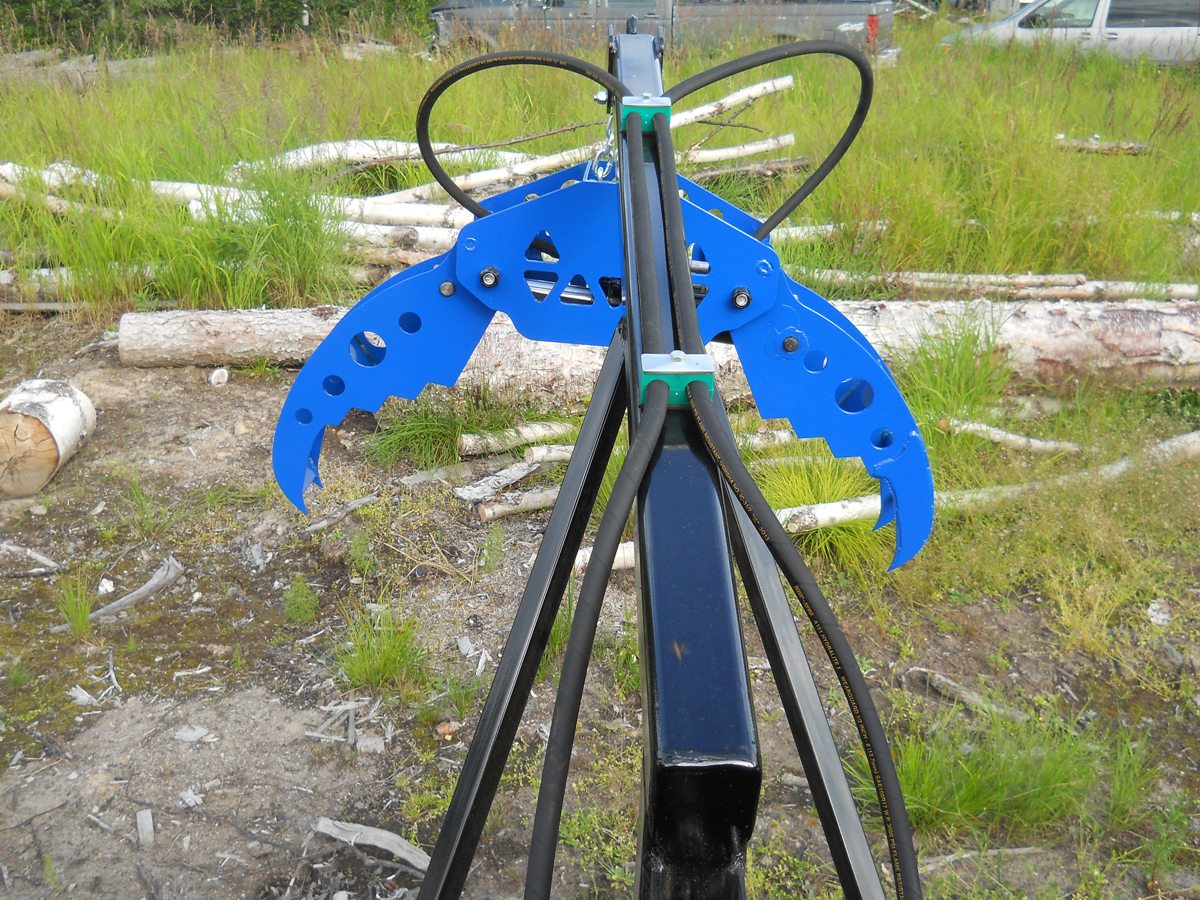

I have wanted a 3 pt Log Grapple for some time, I finally got around to building one. The main frame is 5/16" and the arms are 1/4" with a 3"x8" ram, I also powder coated it, just because. I have only "played with it in the yard, will be taking it out to the firewood lot for a real test. "MCE is my company name"

Great looking build!
How big a diameter log can that thing grab?

Cool. That is a nice looking attachment. Do you mind sharing how much $ you have into it?
/ 3 pt Log Grapple #4
Very well done ... beautiful job ... looks totally professional !

Here we have some fairly large spruce and birch, nothing like SE AK but some in the 24-30 inch range

Very impressive AK. please give us a report after you have given it a good workout. I'm wondering 2 things, what is the measurement from the cyl pin to the "hinge" pin, and does that provide enough leverage or squeeze to hold a full "bite" of multiple stems? And while you're at it, do you like the dangling chain mount v/s a more ridgid 2 axis conventional mount?
Thanks for posting, and I'm probably going to "steal" you design (if I may) :thumbsup:

The Hinge pins are 7/8" cylinder pins are 1". The chains are "cheap & easy" and seem to work real well there short enough to only allow just over 180 degree rotation yet they rotate very easily for the first 90 degrees.

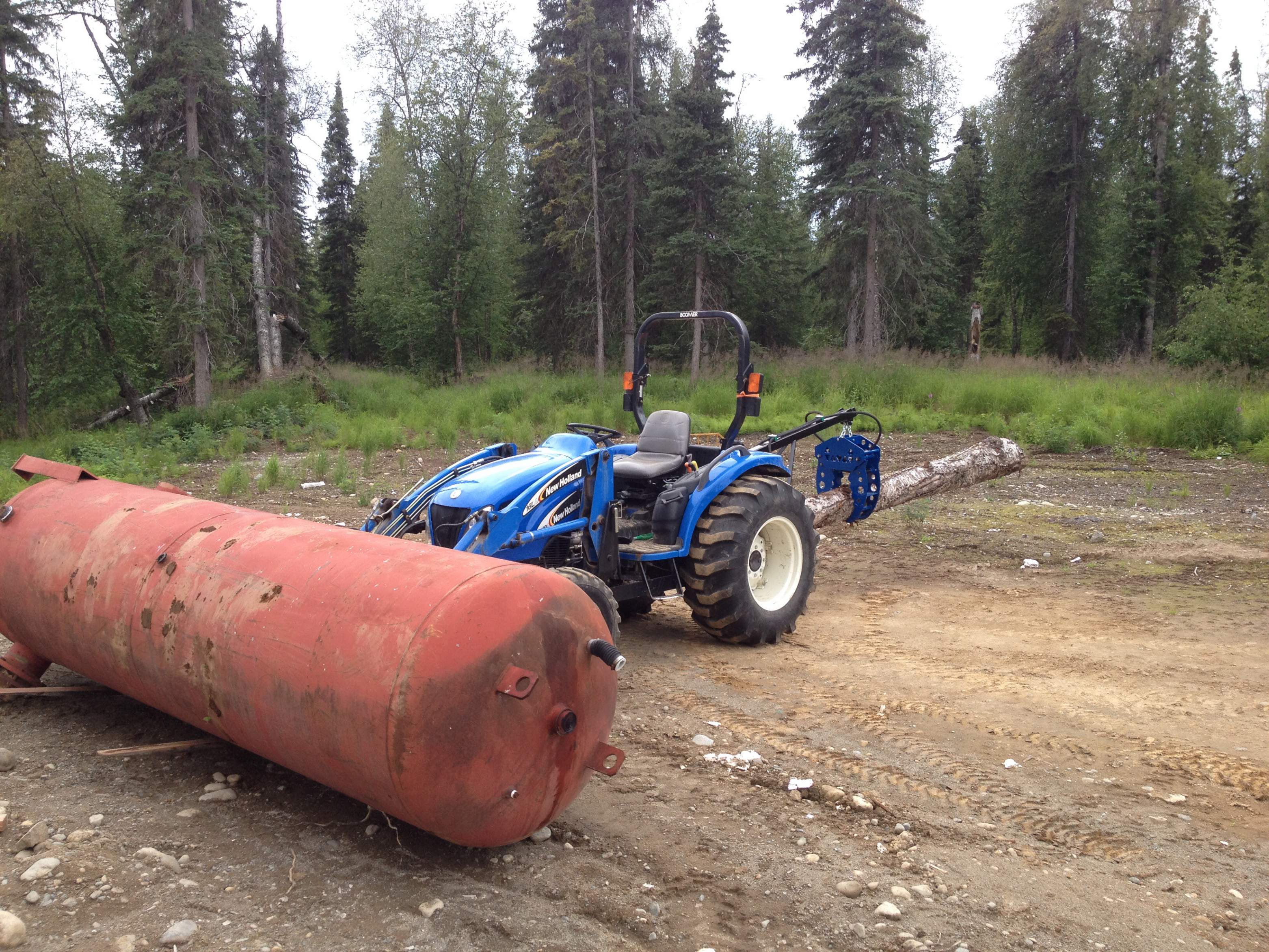

I found a new use for the grapple, holding a counter-weight!!
