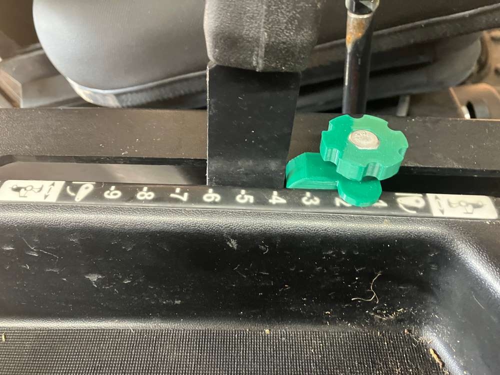

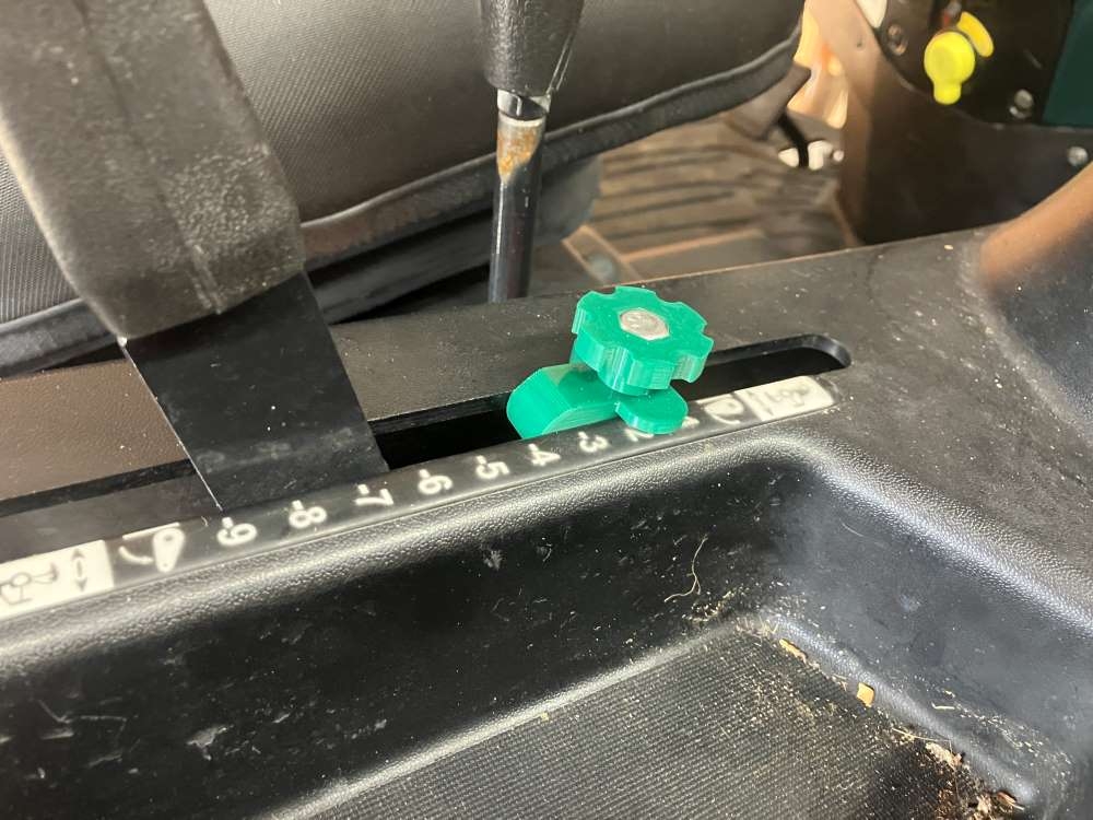

Hi all. Hope everyone had a great Christmas. I posted this in the Facebook Summit group and thought it might be useful here as well. I've had my tractor for almost a year now and for the most part, really love it. One of my frustrations, however, is when I run the rotary cutter and I forget the setting for the three point height. A lot of tractors have a stop that you can set so you can quickly move to the lever to the correct setting. Unfortunately, Summit doesn't make one for their tractor, so I designed and 3D printed my own. It's an easy print and simple to install. The only hardware required is a 1/4-20 x 1-1/2 bolt and nut. I printed mine out of PETG, which should work fine because I keep my tractor under cover, but if you leave yours outside in the elements, ASA is probably a better filament choice. In any event, I'm happy to share the STL files for anyone who wants to print your own, or I can print one for you for the cost of materials and postage (~$7.00.)
Regards and Happy New Year,
Ed
