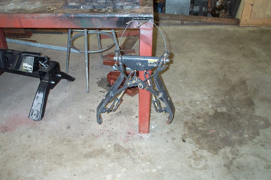

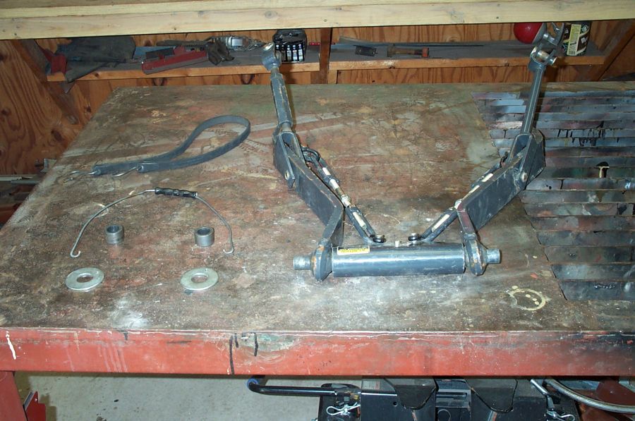

When my 3 point hitch is not installed, I'm always afraid I'll loose or misplace the 2 bushings that go on the ends of the lower link pin. I came up with a simple solution to keep everything together and also substitutes as a way to hang everything on the wall of my shop. All you need is 2 - 1" flat washers, a handle from a 5 gal bucket, and a short (10") bungee cord. Drill a small hole in each flat washer, just big enough for the ends of the bucket handle to fit through. Slide one of two link pin bushings over each end of the bucket handle, hook the flat washers to each end of the bucket handle, slip the flat washers over the ends of the lower link pin. Threading the bungee cord through the lift rods and hooking the ends of the cord to the link pin on the outside the flat washers helps to hold everything in place. Use caution when carrying this setup around, one slip up and you could be minus a toe :eek:

Good idea Tex...Luv the brain stormin that goes on here.
Don
/ 3 pt hitch storage - BX24 #3
Dang! that is the best idea yet for the 3 pt stuff. I lost one of the bushing once for couple weeks.:mad: your idea would prevent this from happening again thats for sure. before i would always had to back it onto the sheet of plywood and unassemble and leave it on the plywood sheet while i was using the BH. i love your new idea so, i think i have everything except the washers big enough so that is on my high to get list .:D
/ 3 pt hitch storage - BX24 #4
Cool!
/ 3 pt hitch storage - BX24 #5
I guess I am the odd ball. I just put zip ties on the shaft with bushings in the middle...Done.
/ 3 pt hitch storage - BX24 #6
Dude, I am the odd one. I just drop it on the floor.
Radioman, just noticed your avatar. You got life insurance?? :D
/ 3 pt hitch storage - BX24 #8
But if I don't lose a bushing or something, what will be my excuse for the NEED to go to TSC or dealer for replacement parts? :):)
/ 3 pt hitch storage - BX24 #9
Ummm :eek: .actually i mow around trees that has branches tooooo low and it all flat land. Don't worry - ill be removing these branches this spring for good and this winter one of my fall projects is to put rops back on and mount the lights in at the top of rops. right now i am using the holes in bottom half of rops for the add on lights. good catch though. i always wondered when would someone notice that. hope the safety police doesnt get me before then.:eek::p
/ 3 pt hitch storage - BX24 #11
Good idea. However, I place the bushings in the top of the left and right lifting rods and secure them with the lifting rods clevis pins and snap rings.
