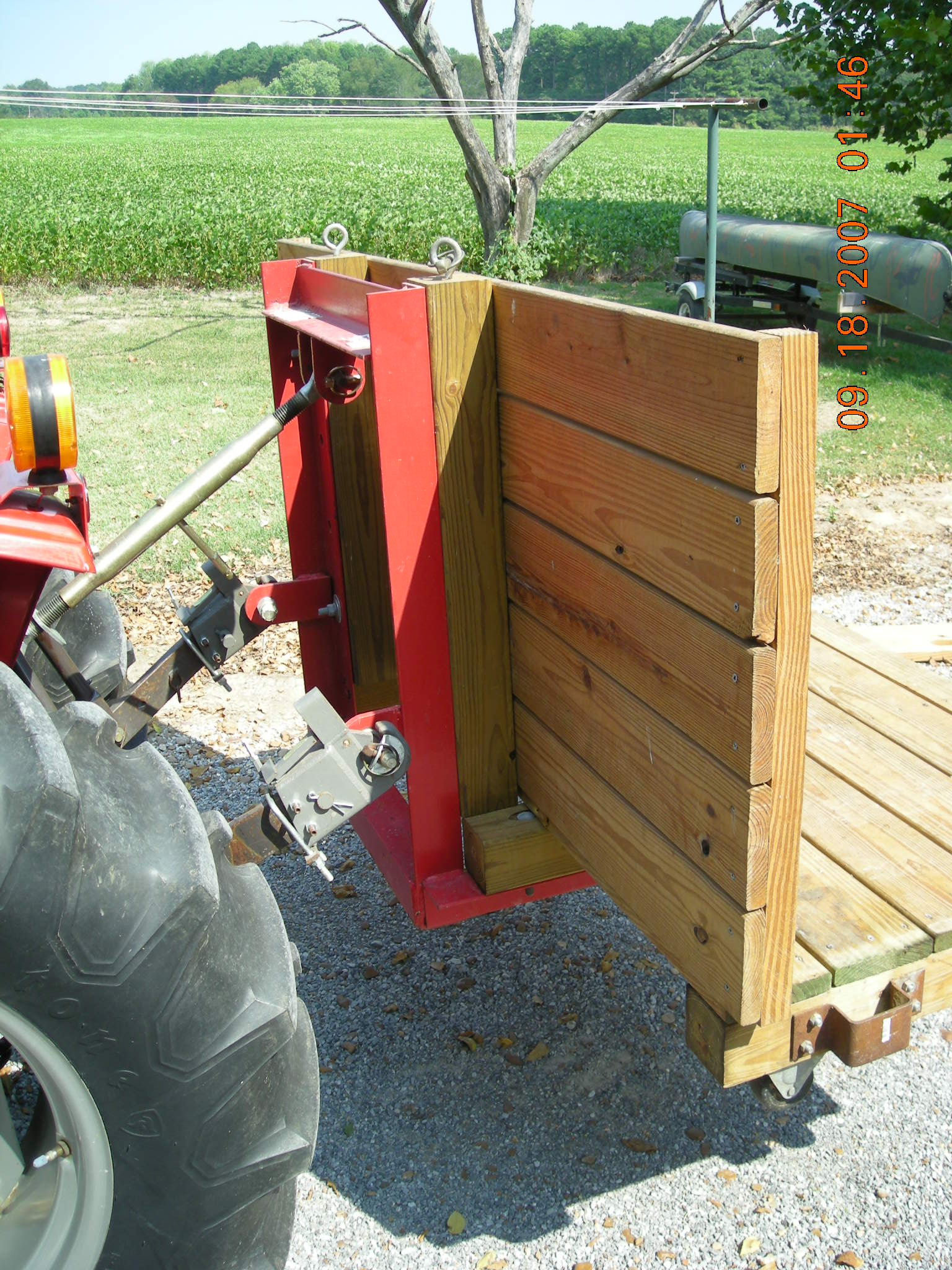

/ 3 pt Firewood Basket #17
I use this one i made for firewood and a lot more uses.
