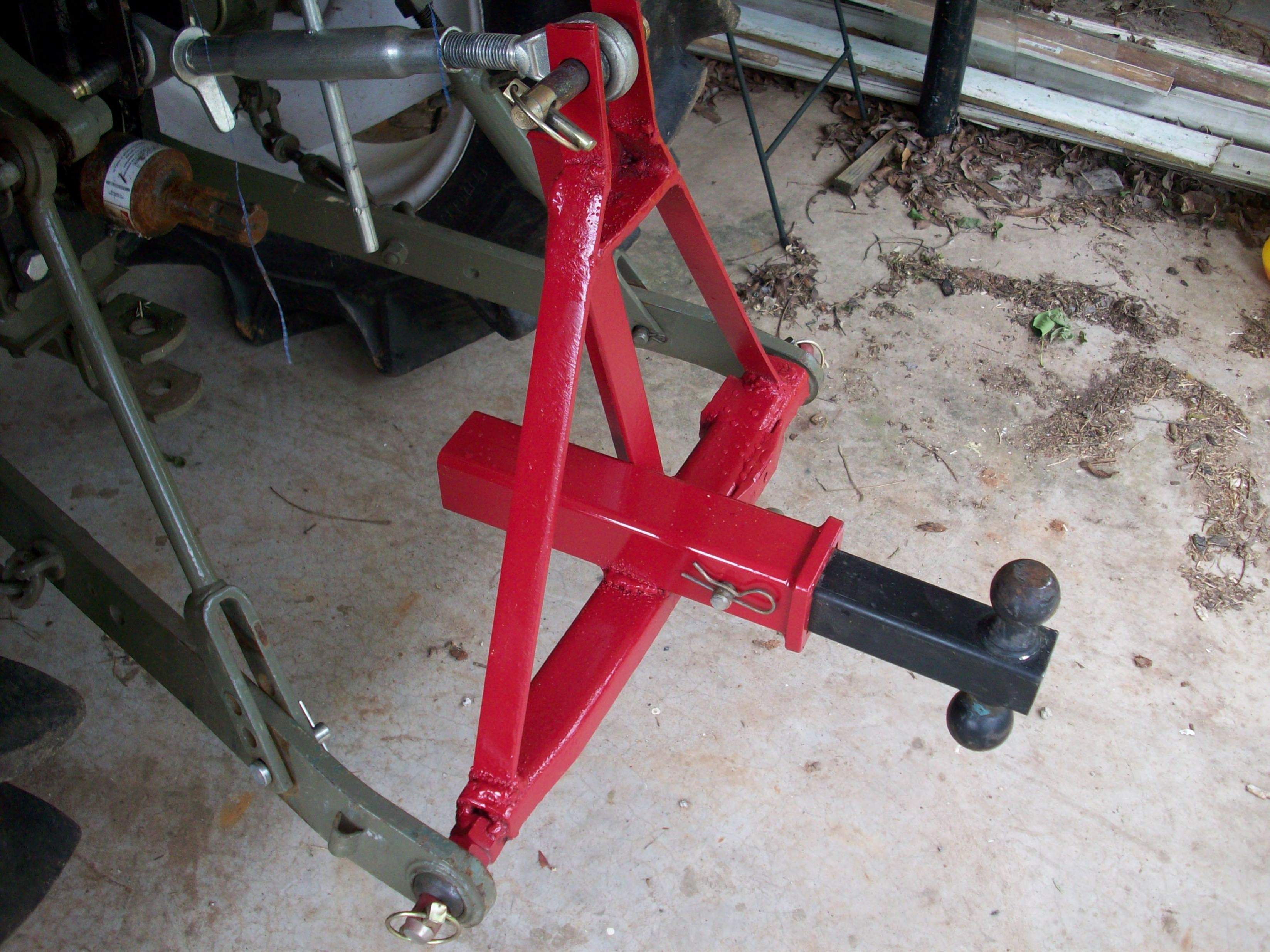

I made this to move trailers around the yard. I found the bottom metal in the woods, bought the pins at my carquest for around $6 a peice, bought the top staps of 1/8'' from him for around $7 cut and welded it up. Had the receiver hitch that i bought from agrisupply for something else and did not use it. I should have made it heavier but intended to move trailors now im going to make a disk hiller to go on a toolbar , which is why i put the vertical metal angle to help support it. Wish i had made it heavier but i will use it and if i twist it up i will remake stronger i guess if not great.
/ 3 pt. drawbar hitch question #7
heres the pic did not work at first?:confused2:

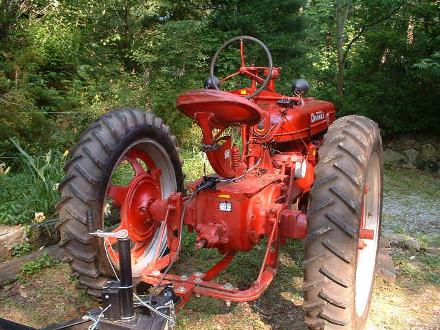

And of course some smart-aleck has to point out that if you didn't have the three-point hitch in the way....
Wm
