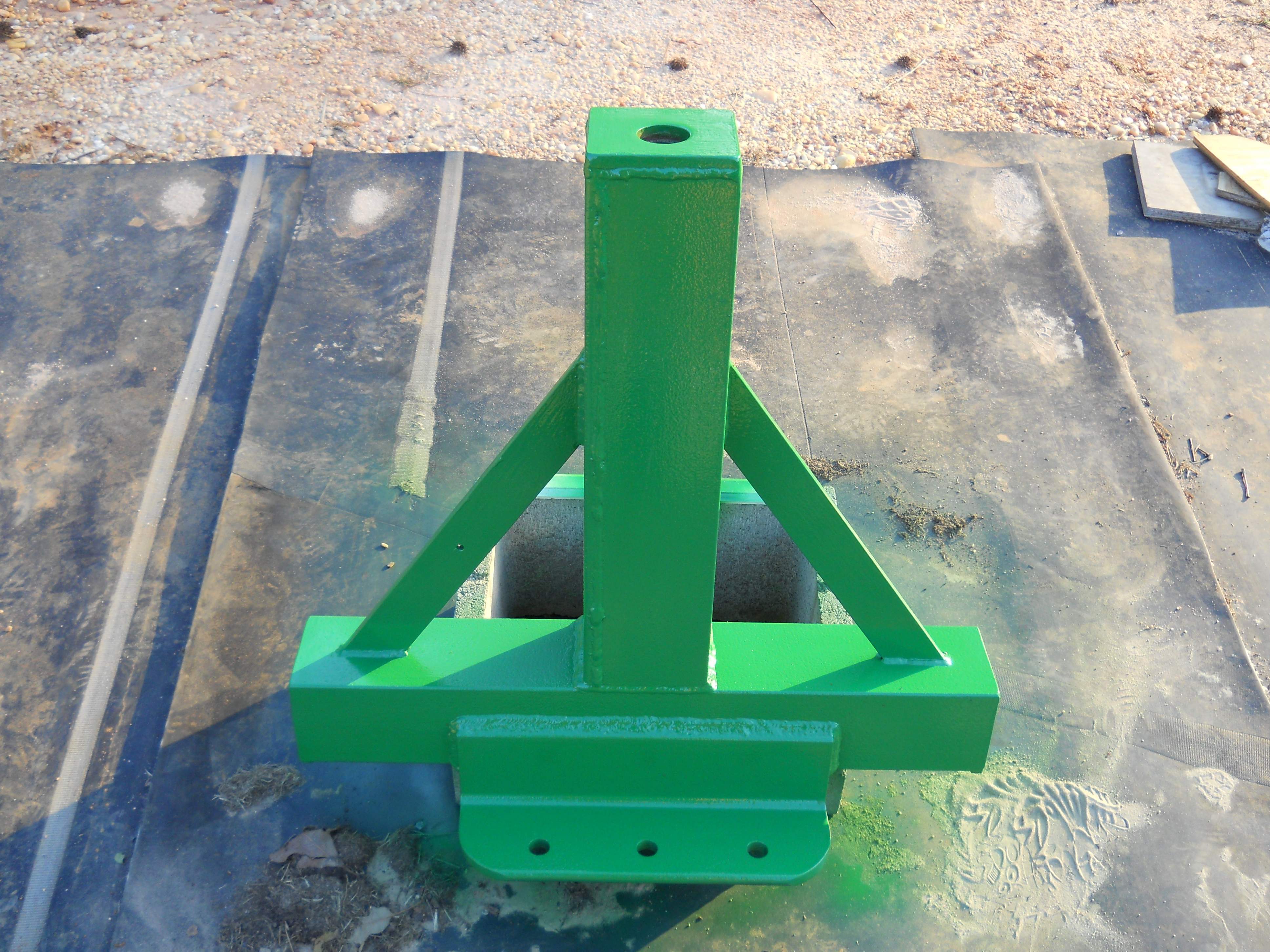

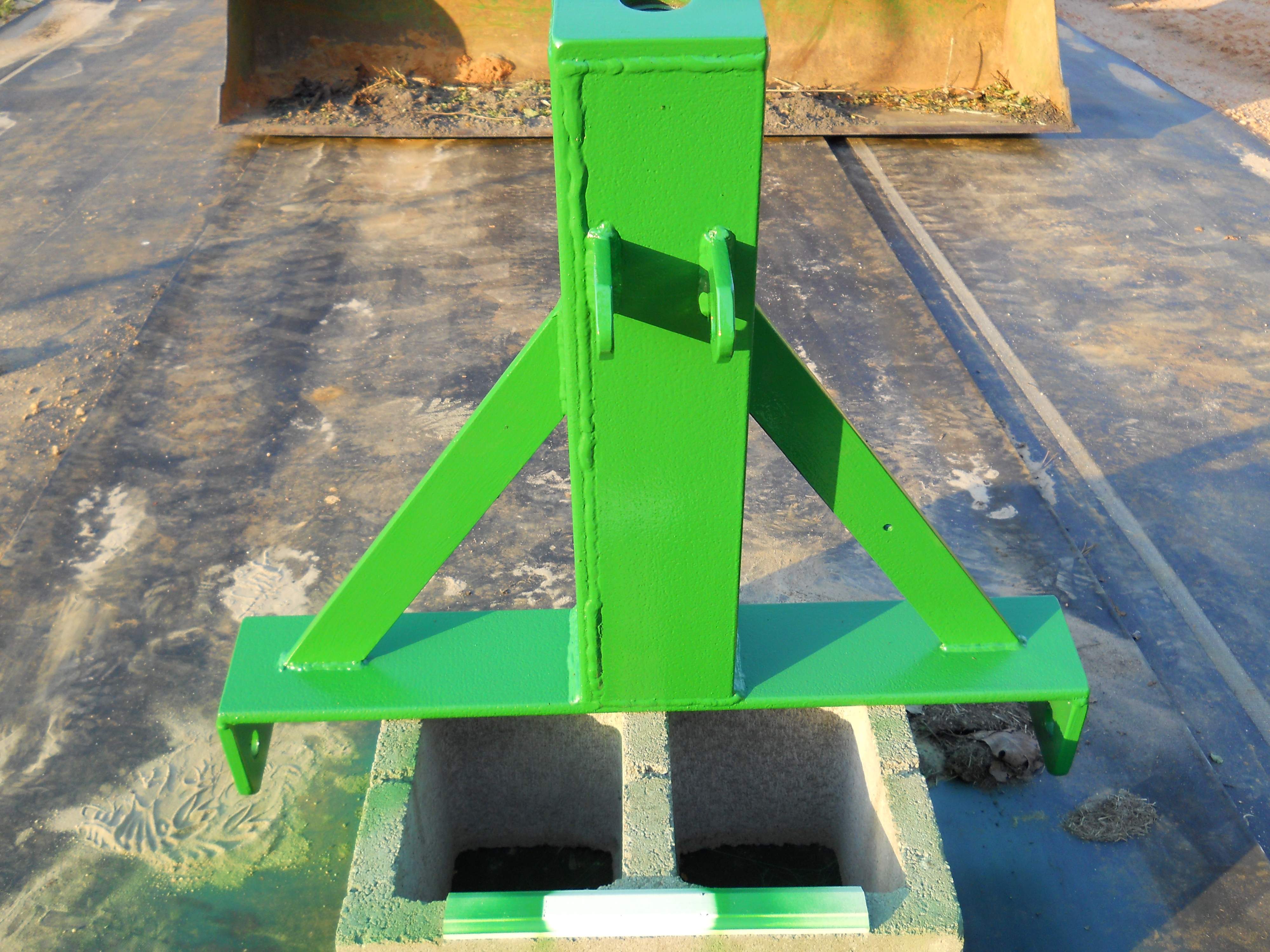

I recently made this 3pt. combo hitch for my tractor. Having to always move trailers and such, I saw one of these and had to make my own. It will accept any ball on lower unit and on top will accept a 2 5/16" ball for those goosenecks trailers. Got material from my brothers old truck bumper and modified. Material is 1/2" x4" x 4" angle iron.

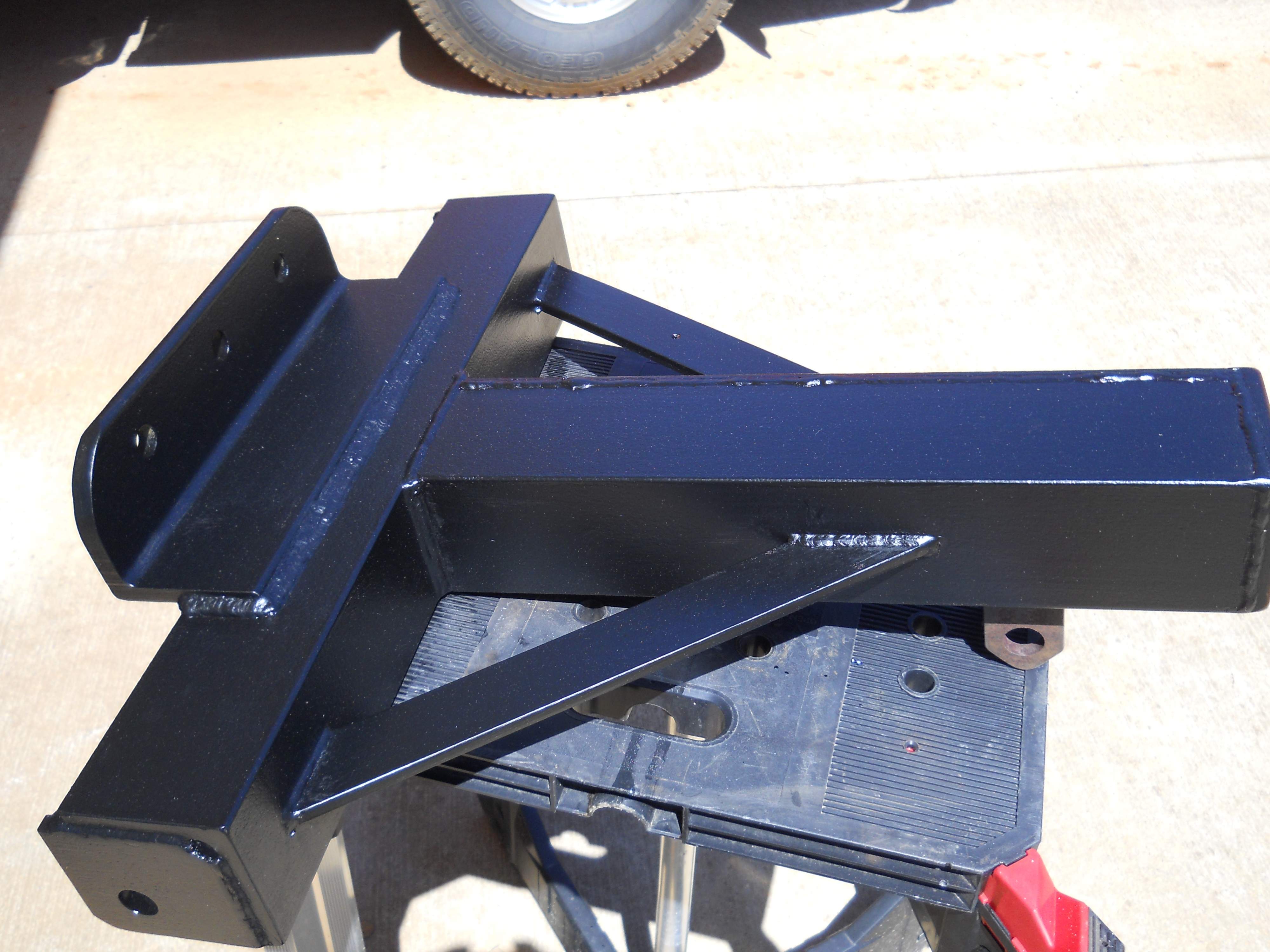

Looks good :thumbsup:I like that you could use found material. I made something similar except the vertical tube I left uncapped so that I could slide in different receivers. The vertical tube was 2.5 x 2.5 which gives the 2x 2 inside. I welded up a piece that would work for my fiver trailer that slides in I also made another that goes on a skid steer plate with the same ides of sliding in different receivers plus a boom pole. I should get some pictures to show but it is not painted and probably will remain that way for several years, lol.
