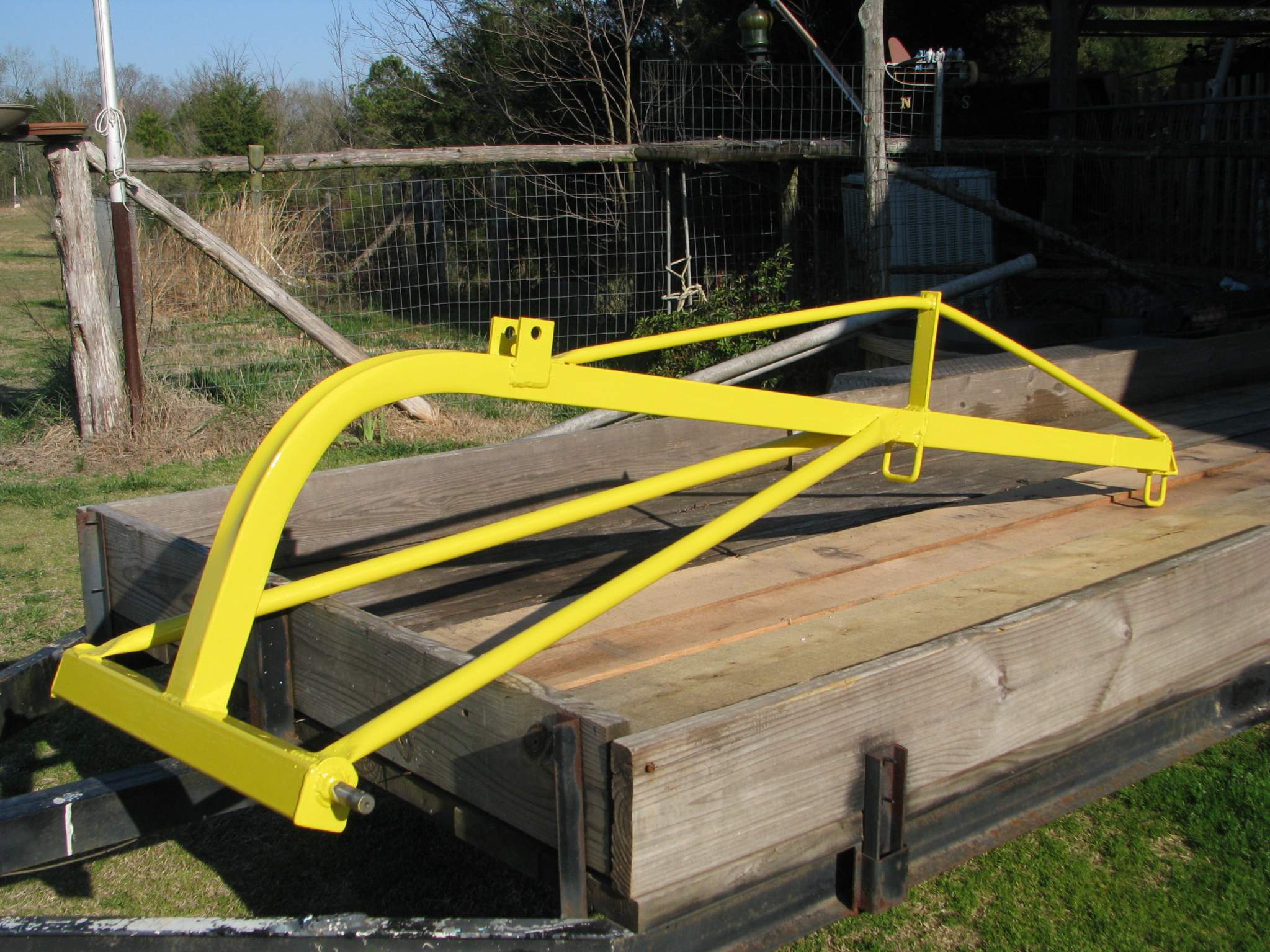

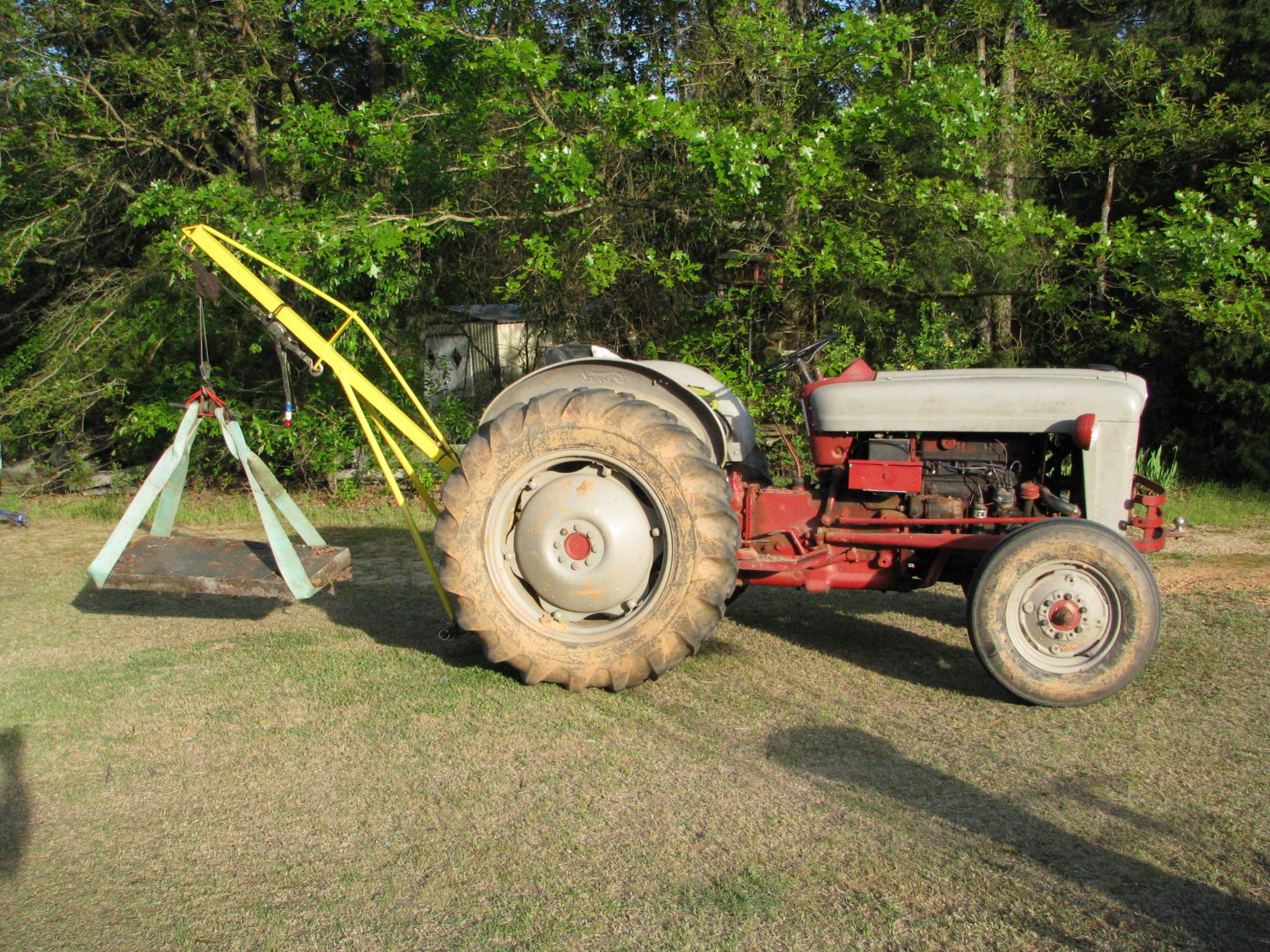

Here are a few pics of a store built one, one (yellow)I built here in my shop, for my 601 workmaster. I use it on my tc30 also, it works great.

Grunt, your pictures raise a few questions. How did you bend that square tubing? The angle of the tube seems greater than the 45 degrees most booms have. If it is, did you do that to get a higher maximum lift?
   / 3 PT boom for 3200 #7

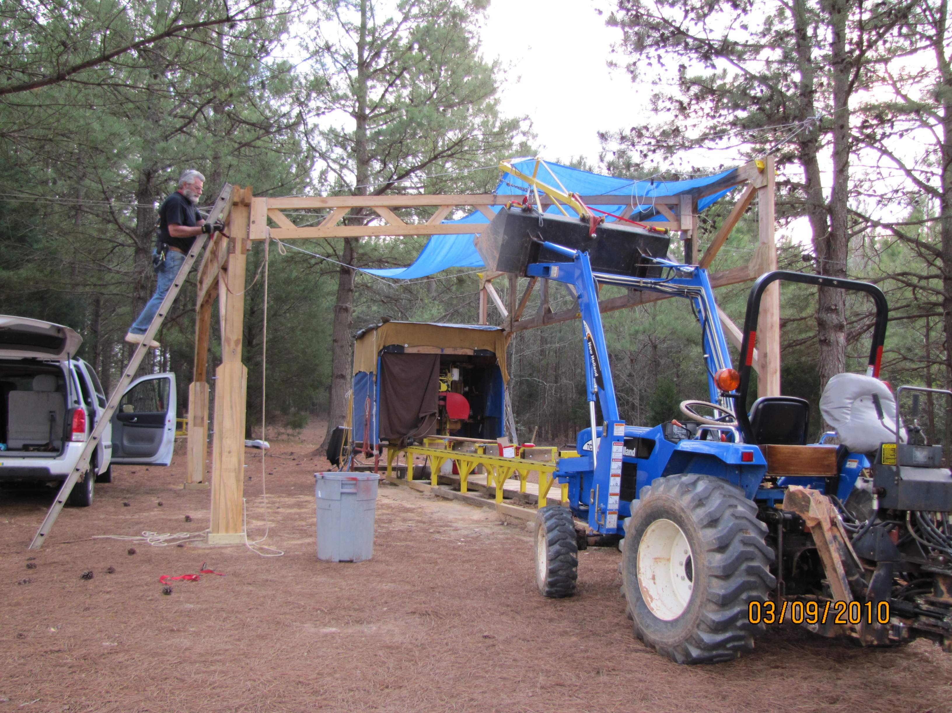

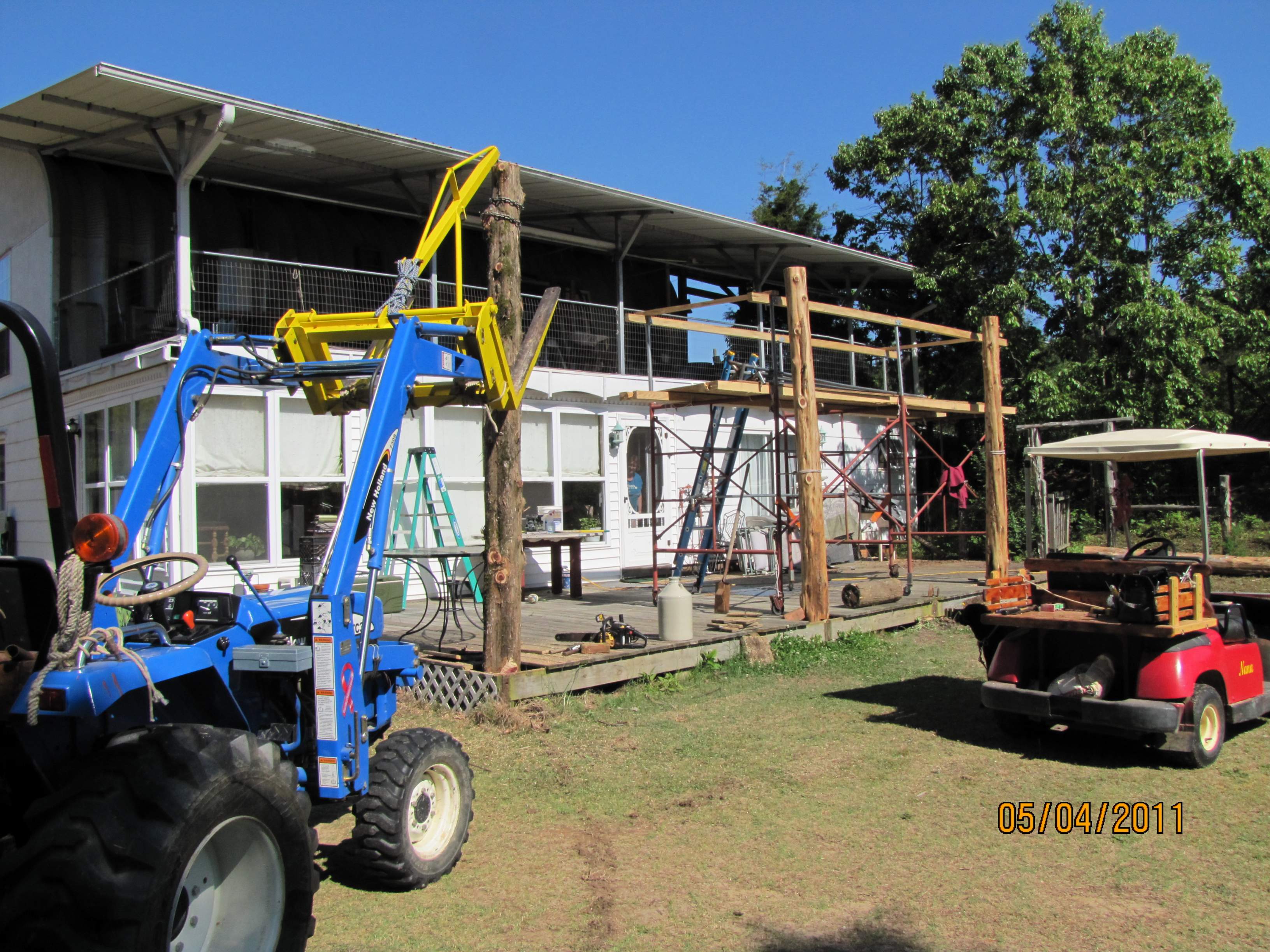

Thats the angle it was when I picked up some scrap from a guy that did carports.I slid a piece incide to make it stronger.Thats a good soarse for sq.tubing. I think the bend I have will make it stronger at that point.Higher lift is allways a good thing.I mounted mine in my front end bucket a set trusses , also set.
