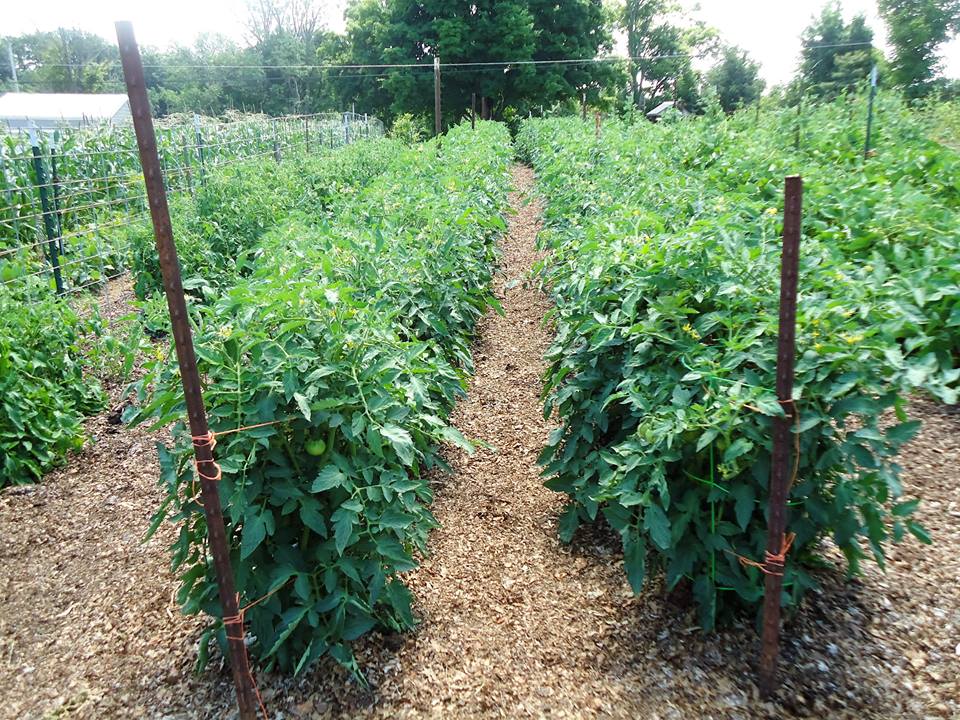

Personally, I use leaves to mulch with. I have a small town nearby that gathers leaves up in town, and they have a huge pile of leaves, free for the taking. I now have a neighbor with a lawn service, that provides leaf pickup in upscale neighborhoods in Columbus. He will bring them to me, saving him from hauling them half way around town, to a mulch facility. They work very well, and not all that hard to put down. 13612133_10209858181430658_7121113114590846888_n.jpg If put down 5-6 inches thick, they make a very good weed barrier. After a few rains, they settle, and compact down to a couple inches thick, making a nice tight mulch. You're able to walk out in the garden, within minutes of a good rain, and not problems sinking in the mud. It also adds a lot of organic matter to the garden. It's pretty well broken down into fine compost the following Spring, and plows down well.

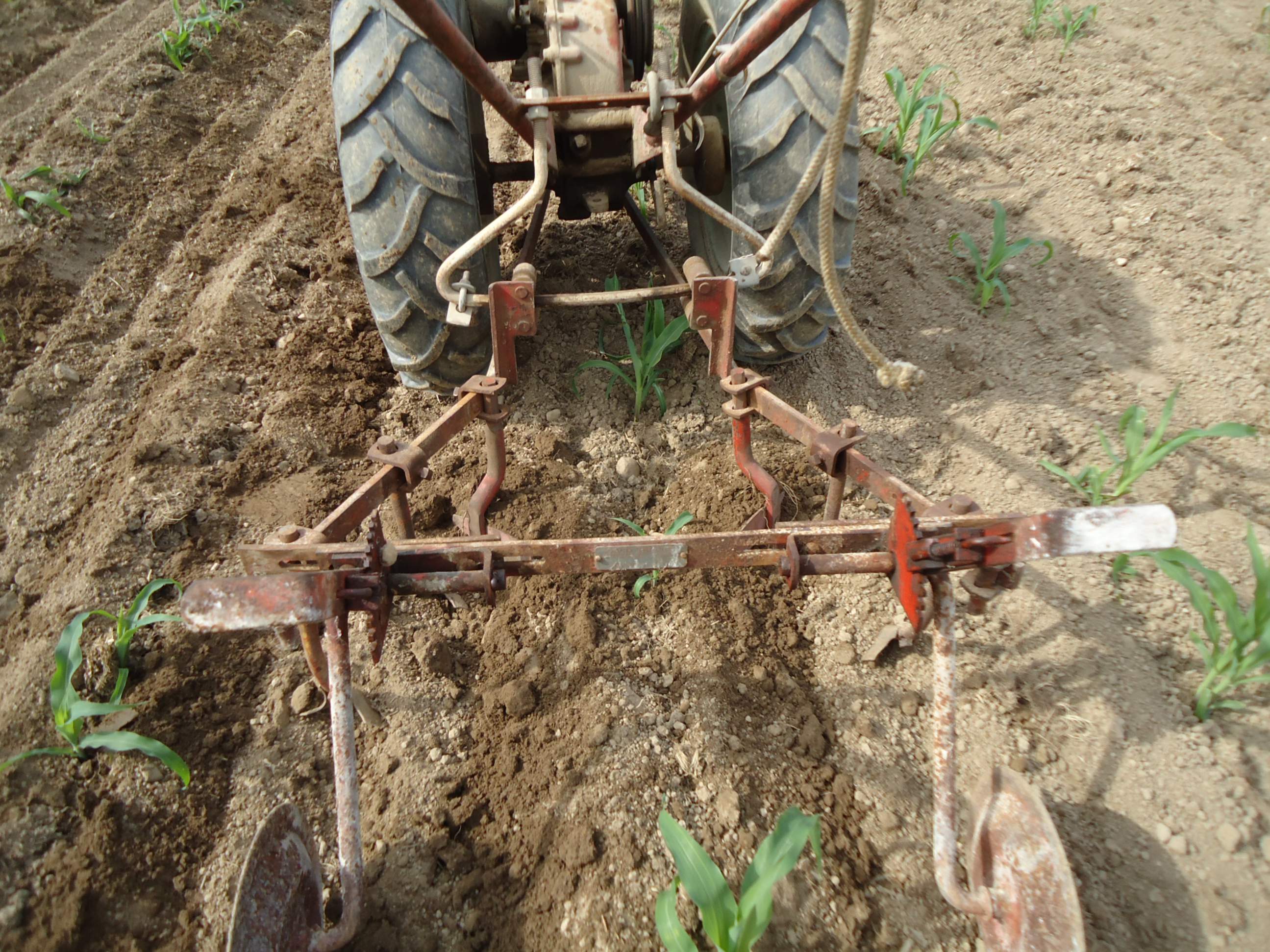

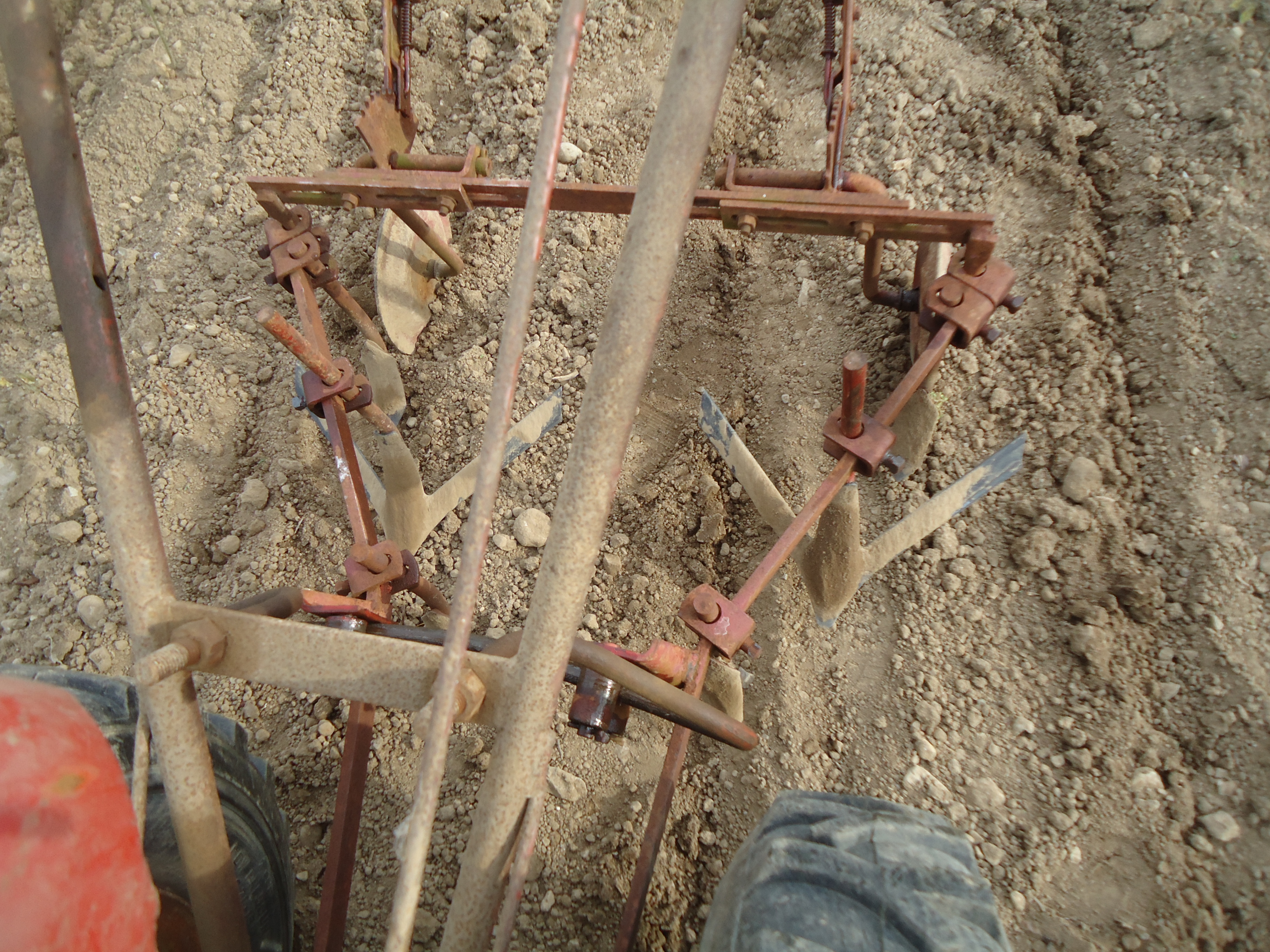

I also use 2-wheeled David Bradley walk behind garden tractors to cultivate, whatever I don't mulch. I plant in 30 inch rows, increasing the amount of crops, in a given space. I have 4 tractors set up with different cultivator shovels & sweeps, for different plant sizes, as the progress. Most, I have around $100 in apiece, so not a lot of overhead.

I'll attach a few more pics of my setups. They aren't trailer queens, but run like sewing machines. They earn their keep here.Hilling Corn 003.jpgDSC01790.JPG
