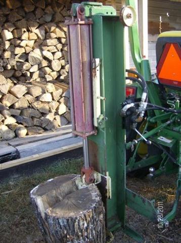

I use the bucket cylinder connections on my JD 790. The "power beyond" kit is NLA, I was quoted nearly $1500 to "piece" the kit! I just use a tarp strap to the opposite fender from the joy stick. Works fine for me! ~~ grnspot

   / 3 point log spliter #10
