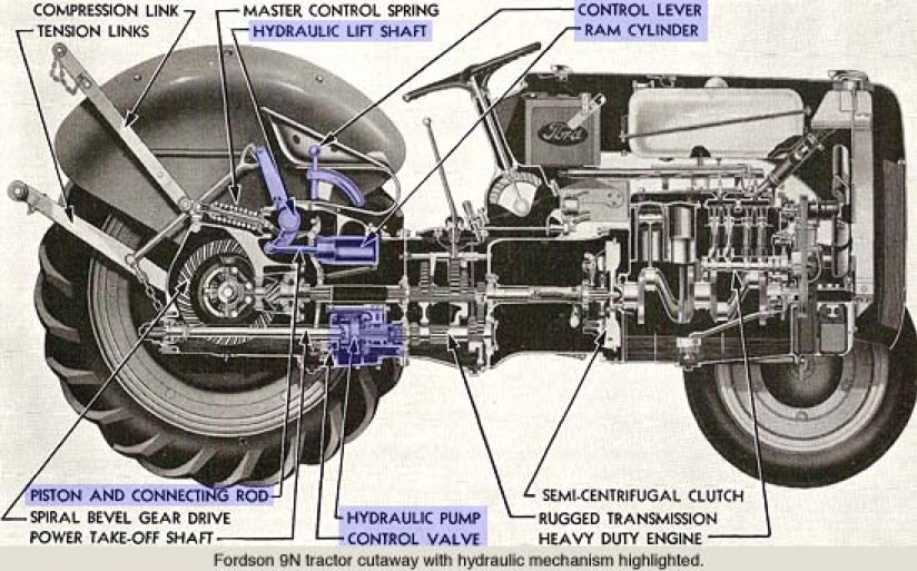

After getting a new rear blade mentioned in another post and coupled with the fact I have a sore neck from crooning around to the rear using it- I got to wondering:
>>>>>>> how does the rear 3 point lift work? <<<<<<
I doesn't appear hydraulic as the arms come out of the sides of the rear end...
plus the controls don't quite work the same as the loader and other hydraulic type controls, its sort of finnicky trying to use it to blade a driveway.
Would a tip and tilt rig help an aging soul??
/ 3 point lift--how does it work??? #2
There is one hydraulic cylinder inside the transmission housing under your seat. It attaches to the rockshaft that moves the outside arms.
/ 3 point lift--how does it work??? #3
Top n Tilt would be quite helpful. 3PH control isn't very fine, as you have found out. You can also change the effect of your rear blade based on which top link hole you use. The 3 holes give you more or less cutting angle. Me, I want TnT! You can also adjust angle using the right 3 pt. arm level adjust crank.
/ 3 point lift--how does it work??? #4
Yes it is hydraulic. A BIG piston that turns the rockshaft that lifts the arms. The lever on mine (JD) lifts arms to the selected point. Then there is a weird option of draft control (wish I Had). Making it even stranger acting.

No the piston doesn't have enough travel to come up thru the seat. Most tractors also have a relief system that trips when the piston reaches a pre- determined point, and stops the travel before the piston comes out of the cylinder.

This may help.
Bruce
