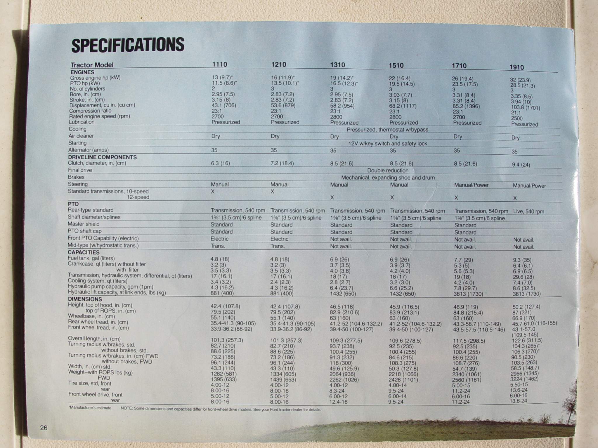

For all you new owners I have this Ford 1000 Series Specification brocher from 1981 with the all kinds of specifications which includes the following information:
Hydrolic lift capacity at link ends, pounds.
1110 = 881
1210 = 881
1310 = 1432
1510 = 1432
1710 = 3813
1910 = 3813
This is official ford information and the brochure contains much more including:

I will be happy to share any of this information to all those that need it. Ray
Hi Ray,
That is quite a lot of lift for 1710. Can you scan and post the page? I'll be amazed if the info is real and there was no typo involved.

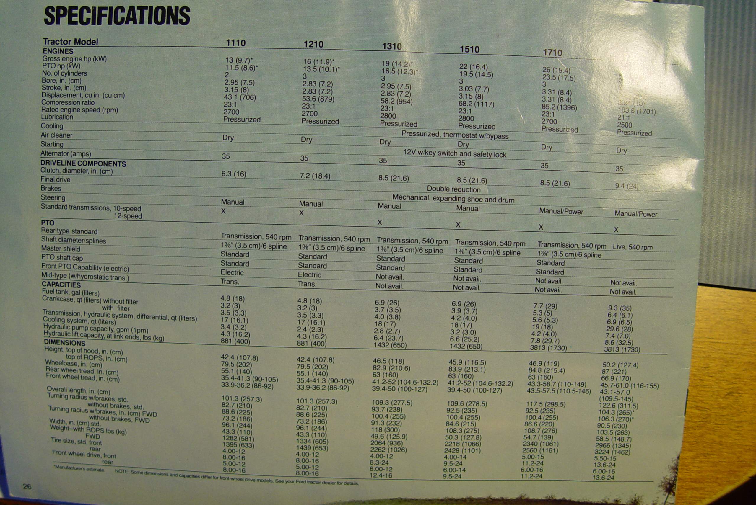

   / 3 point lift capacity #17

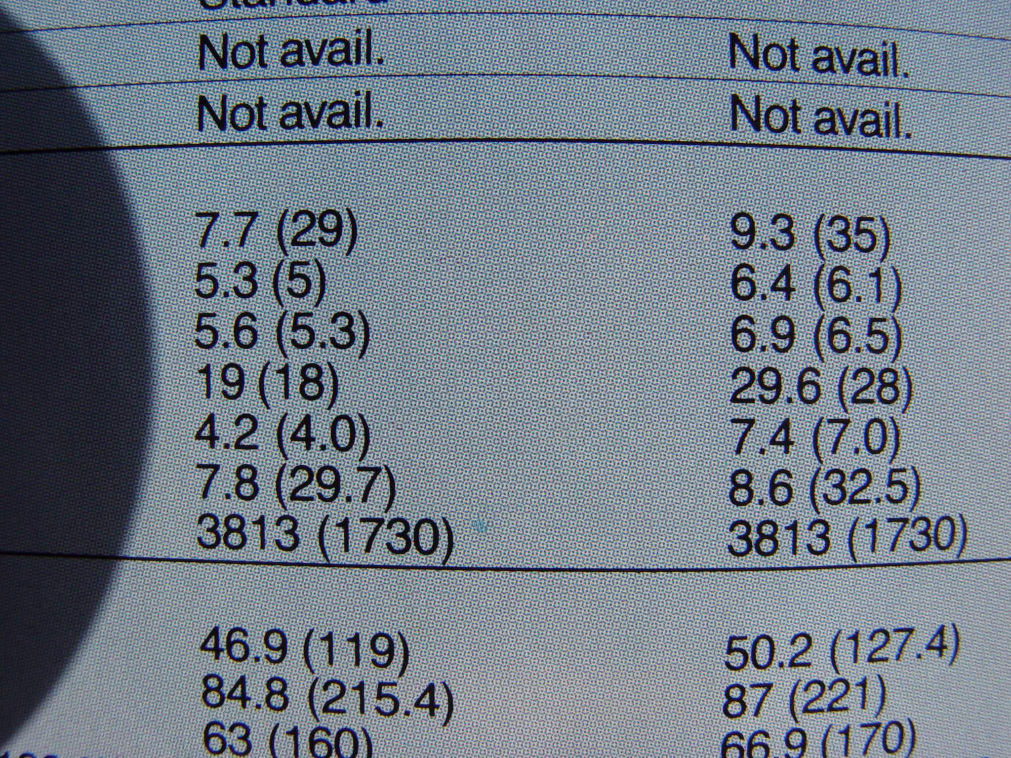

The specifications and capacities pictured above came from a ford brochure. I don't know if the lift capicity of the 1710 & 1910 are a typo or not. Maybe a current Ford employee can verify if it is correct or printed in error.
There is some other information in this brochure as to recommended implements to match. If you need more information, post here. Ray
   / 3 point lift capacity #18
JC, Maybe 1813 lbs lift capacity is a more realistic figure for the 1700. The 3813 listing looks high. Also there is a differance in the 1700 & 1710 engine and pump capacities as the 1710 has a 3 cyl engine. I have the owners manual of the 1700 and will be hapy to share any information now that I have learned how to post pictures. Some of the capacities are differant between the 1700 & 1710. My tractor is a 1700 4 Wheel drive and has served me since 1981 with 985 hours on it. I have only had to replace the water pump in all that time plus the recent lift seal replacement. Ray

I suspect a typo also, look at the specs on the 1910, over 20% more HP, over 25% heavier and 10% greater pump capacity yet the lift capacity is shown as the same as the 1710?
It looks like the 1710 specs are very close to the 1700 except that extra cylinder.

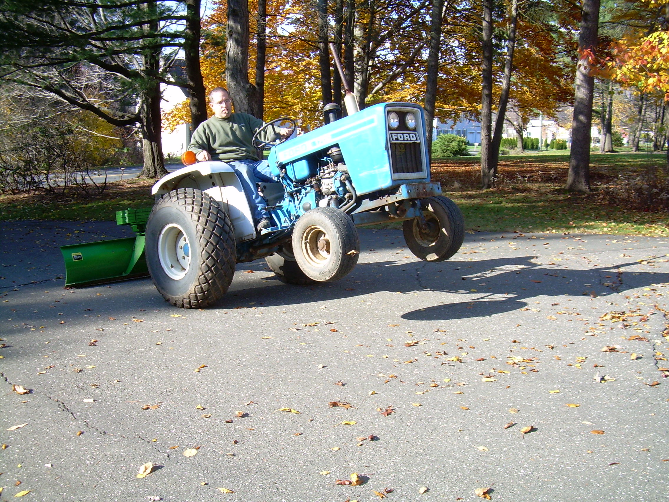

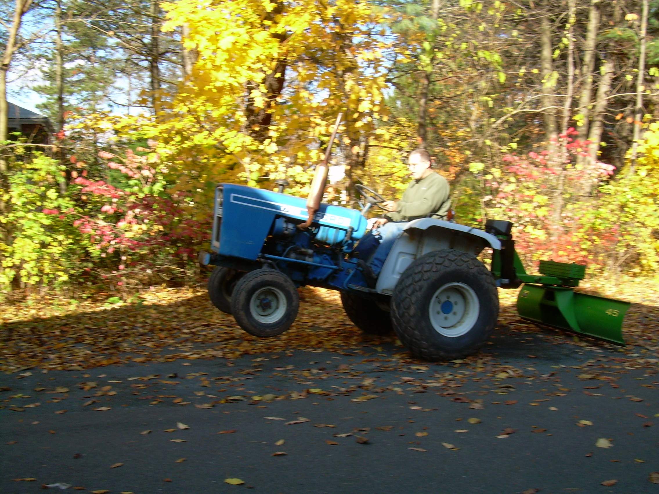

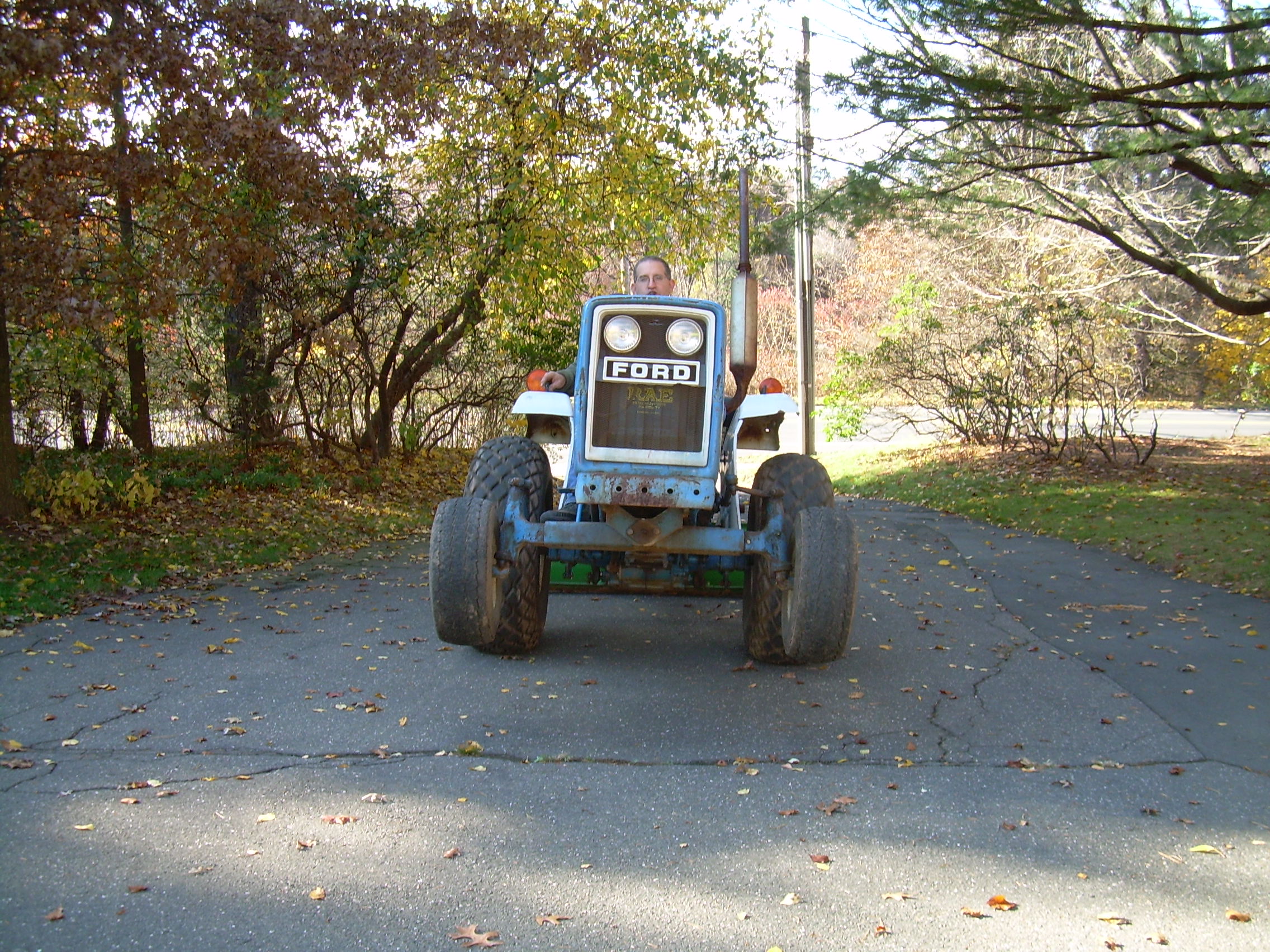

Pictures here are just pure foolish play but since the discussion came up regarding the 1700's front end coming up, this rear blade weighs about 500# with the extra weight on it and it will come up even with 4 suit cases on the front, so I don't know how much counter weight you would need on the front if you could lift 3800#'s on the rear!
