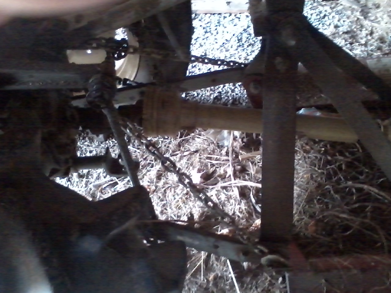

1021161141-00.jpgSounds as if you need something like this. Have been using these check chains to determine the height of my cutter and keep strain off 3ph for about 15 years. Unfortunately don't remember where I got them or exact name.
   / 3-point Hydraulic cylinder has flow by #26
View attachment 485543Sounds as if you need something like this. Have been using these check chains to determine the height of my cutter and keep strain off 3ph for about 15 years. Unfortunately don't remember where I got them or exact name.
where do those attach too? looks like they go from the lower pin to the upper arms? how does that keep the pressure off the 3pt if they go to those?
   / 3-point Hydraulic cylinder has flow by #27
Check chains are run from the lower pin on the implement to the upper pin on the top link. Once adjusted, the implement is held by the chains, not the hydraulics. Another good thing with them is that if you have to lift the implement, then all you have to do is just drop the lift and it will go back down the limit of the chains, no need to adjust height up and down again.
Some people call them limiter chains.]
Here is a PDF on how to make your own
http://www.ntractorclub.com/howtos/pdfs/Limiter-Chains.pdf

Check chains ? Interesting idea - I may give it a try if I can put it together.
   / 3-point Hydraulic cylinder has flow by #30
Right, gunny, top link bracket. Chain Limiter Kit That would be the one.
