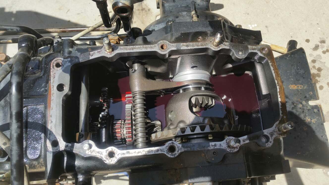

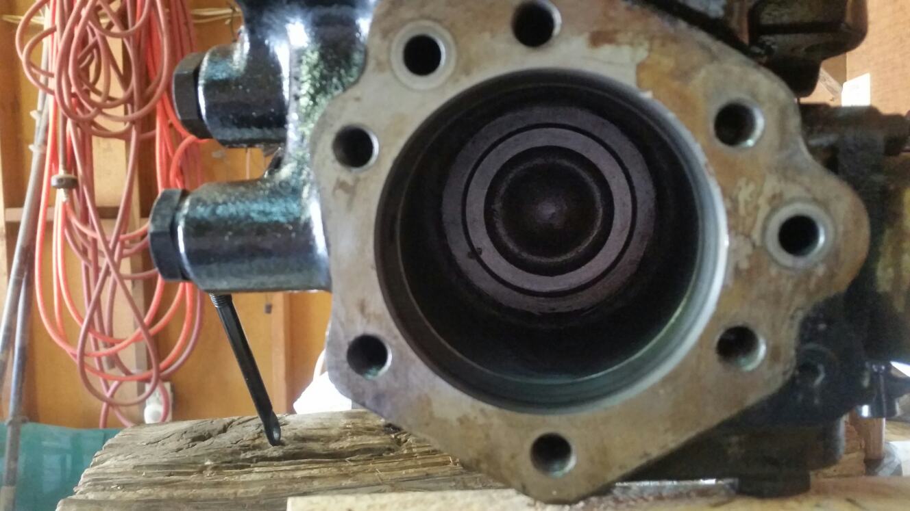

   / 3-point Hydraulic cylinder has flow by #15
Don't know that this will help. Picture of an FX24D. Second picture showing where the housing bolts down. I was acutally not working on the 3 point but had to remove it to access the rear differential. Doubt you would have to take quite as much apart to remove the 3 point housing. Still makes sense to me to remove the front cover and try pulling the piston out as Aaron suggested way back. Nothing to lose in trying.

#16
Thanks for the two pics. Can you tell me why removal of the housing is necessary to make the repair ?
   / 3-point Hydraulic cylinder has flow by #17
the piston will not come out the front, I even tried when I had the whole housing off the tractor.
Still trying to get the pictures, but really winston's show what needs to come off.
the fx28 is quite a bit heavier than the 24, but if you had some help you could lift it off without a hoist, but because of the angle getting in there it would be a back breaker.

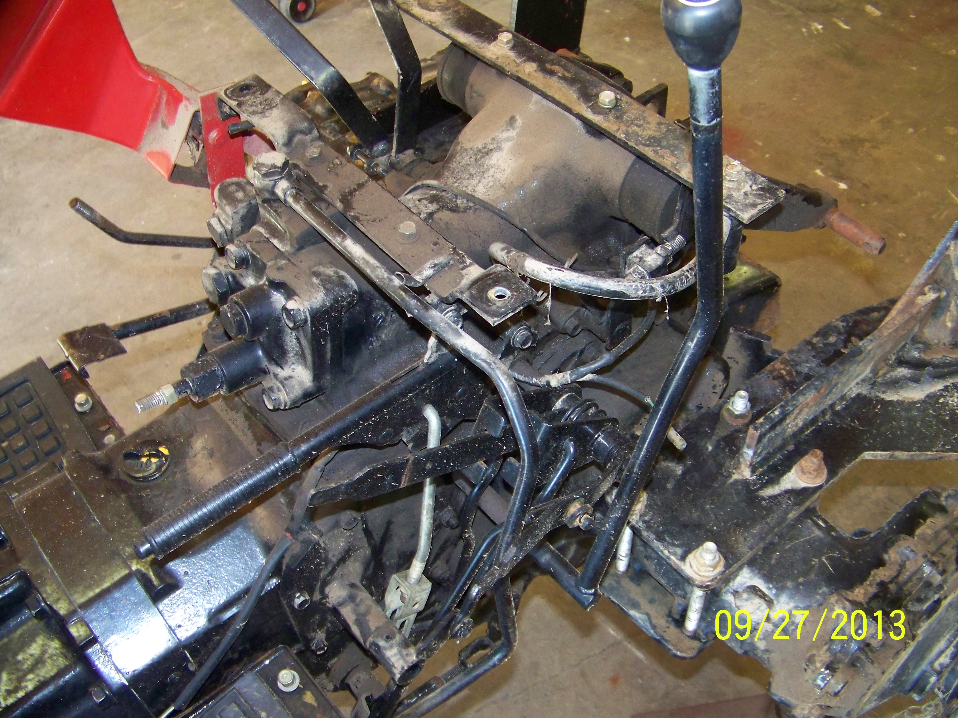

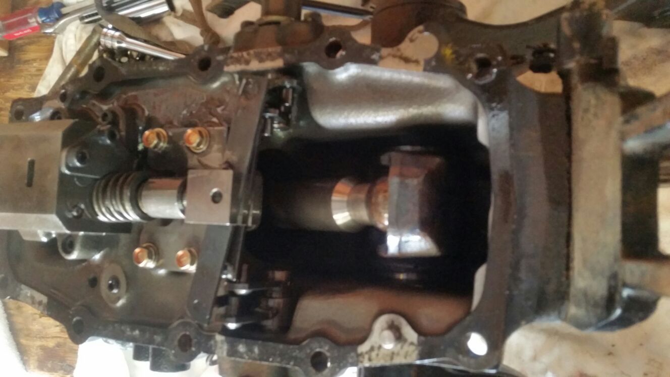

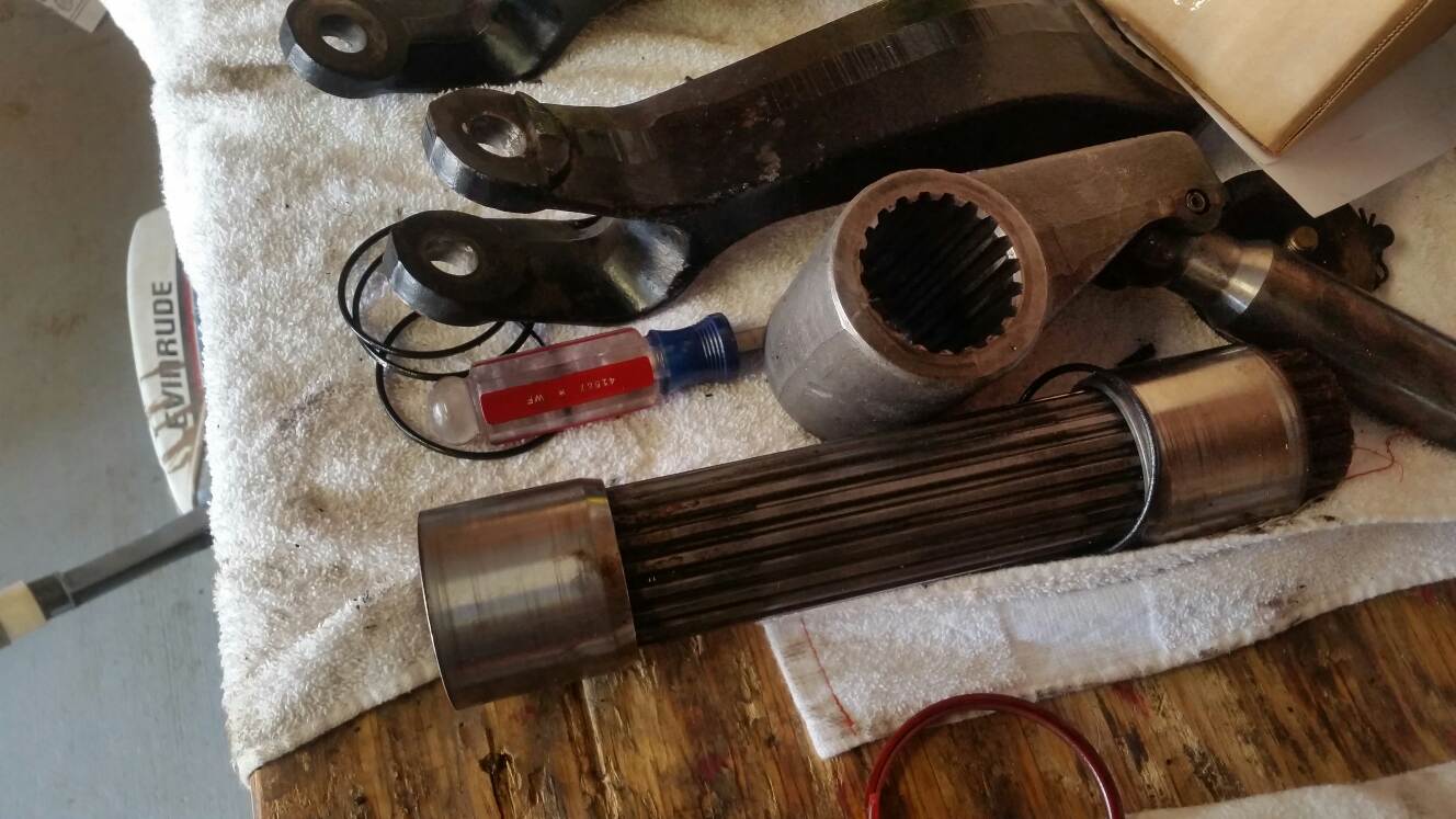

   / 3-point Hydraulic cylinder has flow by #18
see if this helps.

   / 3-point Hydraulic cylinder has flow by #19
I and Winston both have a post about doing this job. Mine was on a ym2000 and his on like a 2001 . Its not a big deal to remove the whole top. Just might want to have a hoist or be able to get right behind the tractor without a ROPS. It is pretty heavy when I did mine, I was standing backwards on the tractor and lifted it off and was kind of stuck, my forearms were supporting me on the fenders and I was holding the top of the 3pt and I couldn't really stand up due to the steering wheel and I was holding the 3pt so I couldn't push my self up either.
If you want I can link my post with pics here. Its not a hard job though to pull it. And Aaron is right in theory you could pull it out the end by taking that cap off the back but I don't see any way you will pull it out though, its a pretty snug fit unless your oring is in Horrible shape.
   / 3-point Hydraulic cylinder has flow by #20
even if you could get the piston out thru the front, the ram shaft would then fall down out of place. Good luck
