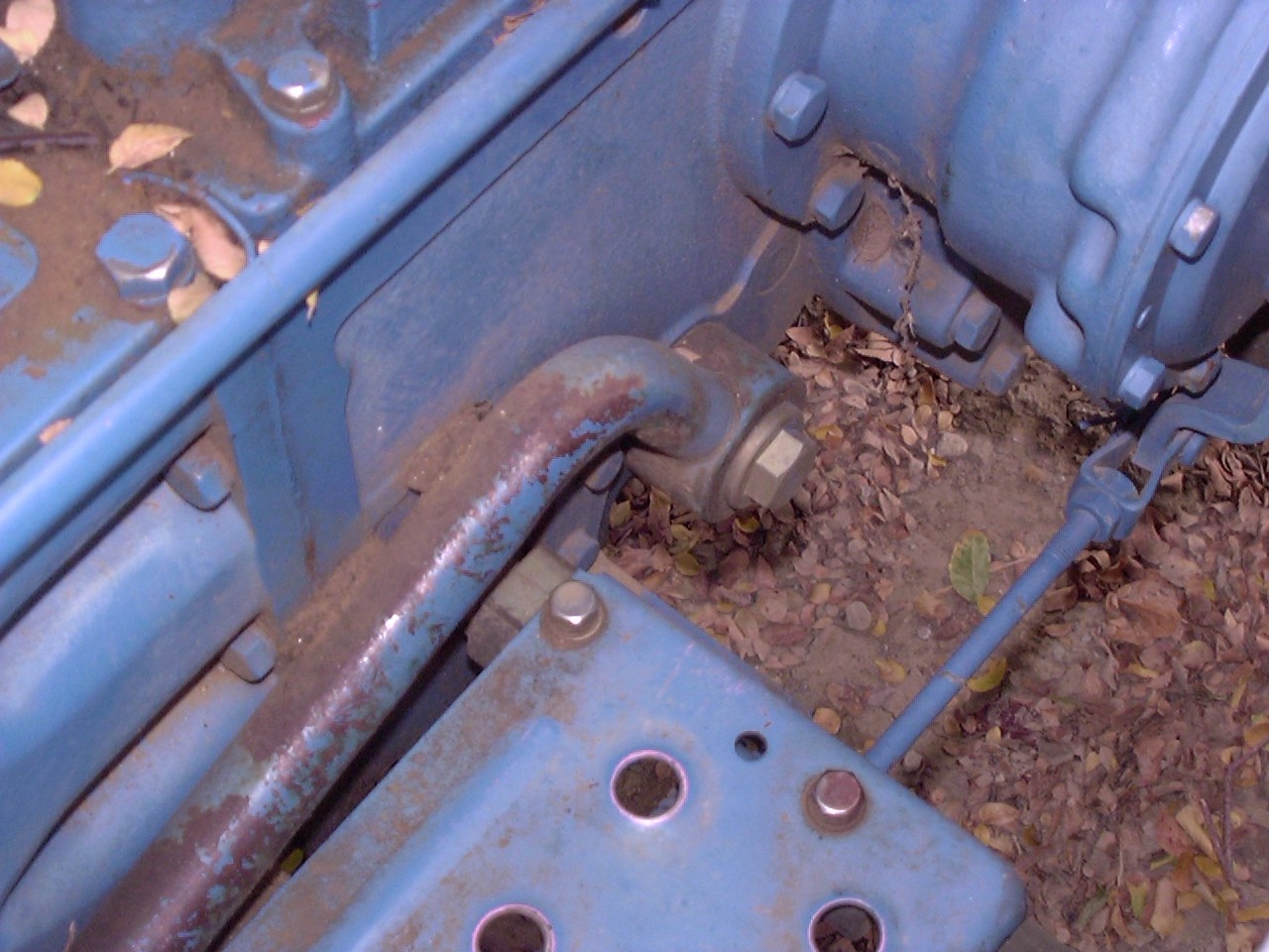

I found another very minor leak on the rigid pipe shown below. The NH site had a detail of this section and it doesn't show an o-ring but only a "fitting assembly" but I'm pretty sure there ought to be an o-ring in there. I'm going to replace this o-ring, providing there is one, and the 2 on the outlet pipe I sucked the oil from. I'll let you know how it goes and thanks again for the help and all the great resources.
Then I may give the tractor a good bath!

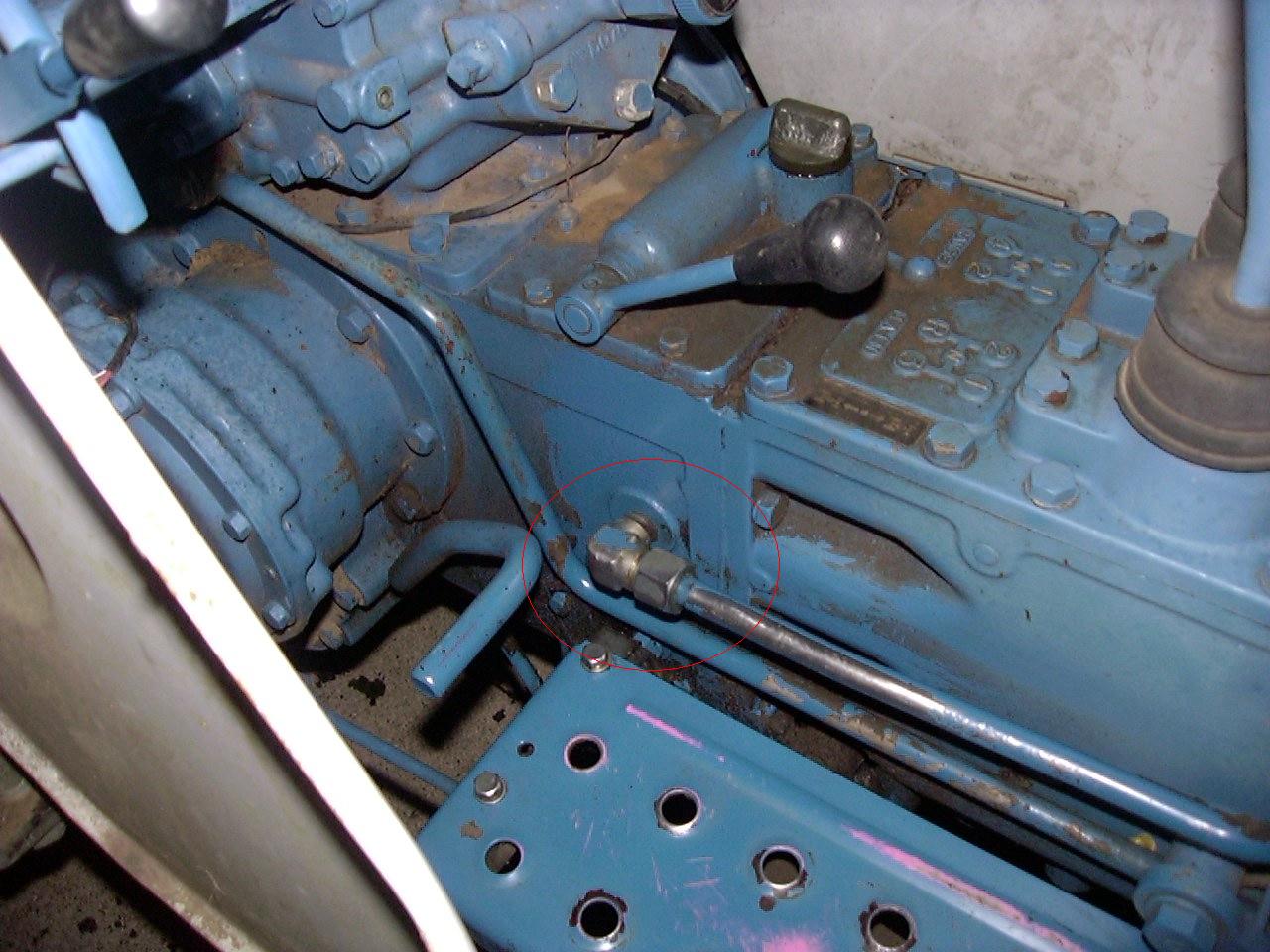

Sevan,
The hyd elbow is JIC fitting where it is connected to the rear diffy housing. it is tapered, if it leaks there it might be a bit loose. The other side of the elbow is compression fitting and may or may not have an oring. I guess it does not have an oring and might have a ferrule or flared. Some may like to put Teflon tape on the threaded part but not all approve it as it might get in to hyd spool causing problem. Since this connection is pre-filter before any control valve I think it'll be okay. I will not go heavy on teflon and make sure wrap the threaded part counter clockwise and not leave anything loose hanging from the end. before any dis assembly I get a crescent or open end box wrench on the outer nut and tighten it a bit to see if that makes any difference.

After cleaning it up I found it is leaking from the connection to the rigid pipe and not where the fitting screws into the oil sump housing. Even as weathered as it is I believe I do see remanants of teflon tape on the fitting. I'll try tightening the pipe connection first.

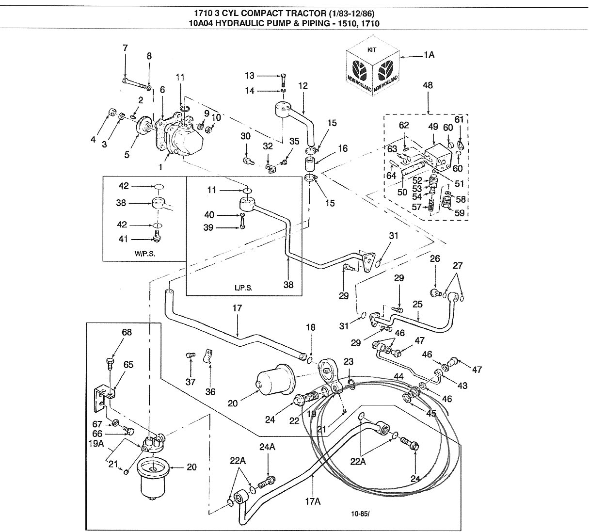

Well... I put new hyd fluid in and replaced the filter but it did NOTchange the 3 pt lift problem.
I guess I'll start looking at the list of possible causes as shown on p. 95 of the repair manual posted eariler.

Need to establish flow first. If you do not hear grinding and cavitation noise pump is probably okay since you had leak under pressure (on the discharge side of the pump). The most likely scenario is Hyd cylinder piston seal. Not difficult at all in your tractor. re check the thread I made to replace mine, should have ample info and pics there to help.
