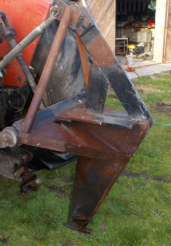

   / 3 point hitch rippers #26
I made a ripper / pipe laying implement.
It wasn't strong enough, so I made it stranger. Then stronger again, adding 5/16 plate to each side so now it's 1" thick and heavily reinforced.
It has to be strong enough to stop the tractor with all drive wheels turning.
I have 4 tons, 4wd, and it works ok in soft ground. If you want to rip 2' into rocky clay, you'll need something heavier I think.
Thats a nice looking ripper there. Do you pull that on your Same 85? My farmtrac is a Same engine. I would be close to 5 tons in weight on mine.
After I'm done haying this year I may scrounge around and see what I have for scrap iron. I might have enough big pieces to make my own but my welding skills are very novice. That is, if I don't find a box blade by then.
   / 3 point hitch rippers #28
Yes, it goes on the SAME.
Several times, I've pulled 100 meter tubes through the ground, 2' under. It doesn't like curves much though.
As a ripper I've used in on roots and rotten stumps.
Sometimes it does stop the tractor, all 4 wheels still turning.
when it sticks, the draft control wants to lift it, and even with that all the way up the downward angle of the hitch arms cause lifting. When laying a tube I chain it down.
