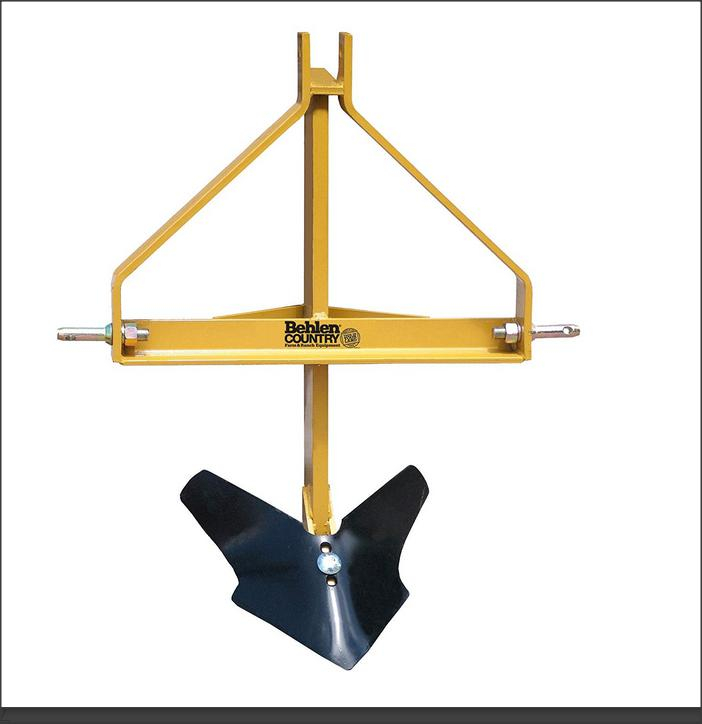

The ripper in the link of post #3 appears to be a what is called a "mole plow" Used to create a cavity in the ground to drain surface water..
I use a similar shape tool to create channels in the ground to collect water around our fruit trees and bushes..

Actually, the pictures are of a blade for a vibrating plow. It looks like someone took one and adapted it to a three point hitch. At the bottom on the back side is the cable attachment and weight to pull a cable or wire through the ground.
