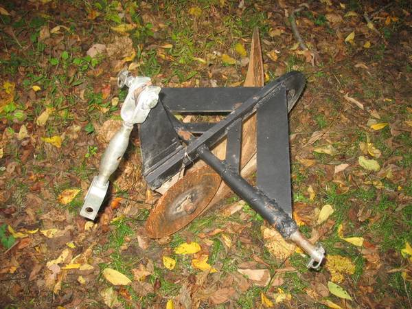

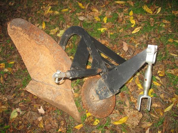

I found this listed on Craigs list. I don't need it now, but will in the future f or a food plot. Is $100 reasonable. I don't have much infor and it looks rusty but not abused. Thanks In advance.

Good price, if it were closer to me, I'd take it for that price.
   / 3 point hitch one bottom plow #4
That's worth a hundred bucks any day;looks in good shape.
   / 3 point hitch one bottom plow #5
Could it be a cat 0 plow and maybe a little small for your tractor and maybe a 10" share?
   / 3 point hitch one bottom plow #6
I agree that plow MAY be for a tractor with Cat 0, rather than Cat 1 hitch. Plow fit to tractor is important.
Thanks all.
I sent a message to him asking for more info. No reply yet. With my 25hp I figure I should be able to pull a midsize plow. It will depend on the soil(rocks). I figure if it's a little small I could turn it twice? New to this.
Should be worth about $75 :2cents:
Everything is more $$$ around here. SOme yuppie will "display" it on his front lawn and tell everyone it's revolutionary war era.
   / 3 point hitch one bottom plow #9
Thanks all.
I expect you can pull either a 12" or 14" plow if the plow ground contact parts are not worn and free from rust. After "breaking" new ground it will be rough. Traditionally, a Disc Harrow is the next implement pulled over plowed ground, followed by a drag of some time to finish smoothing. For food plots, particularly if the plow is just 10", a Cultipacker may work rather than a Disc Harrow.
Food plots due not have to be as smooth as a field. Food plot seeds are generally strong germinators.
