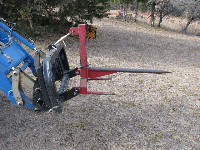

Still needs paint, but here's what I ended up doing.
   / 3-Point Hitch on loader arms PICS #23
That looks like it will work very well. The sliding lower link adapters will make hooking up really easy. I like your long toplink too. The 4" one that came with my adapter had to be replaced with a tiny Cat 0 toplink when I use my balespear.
