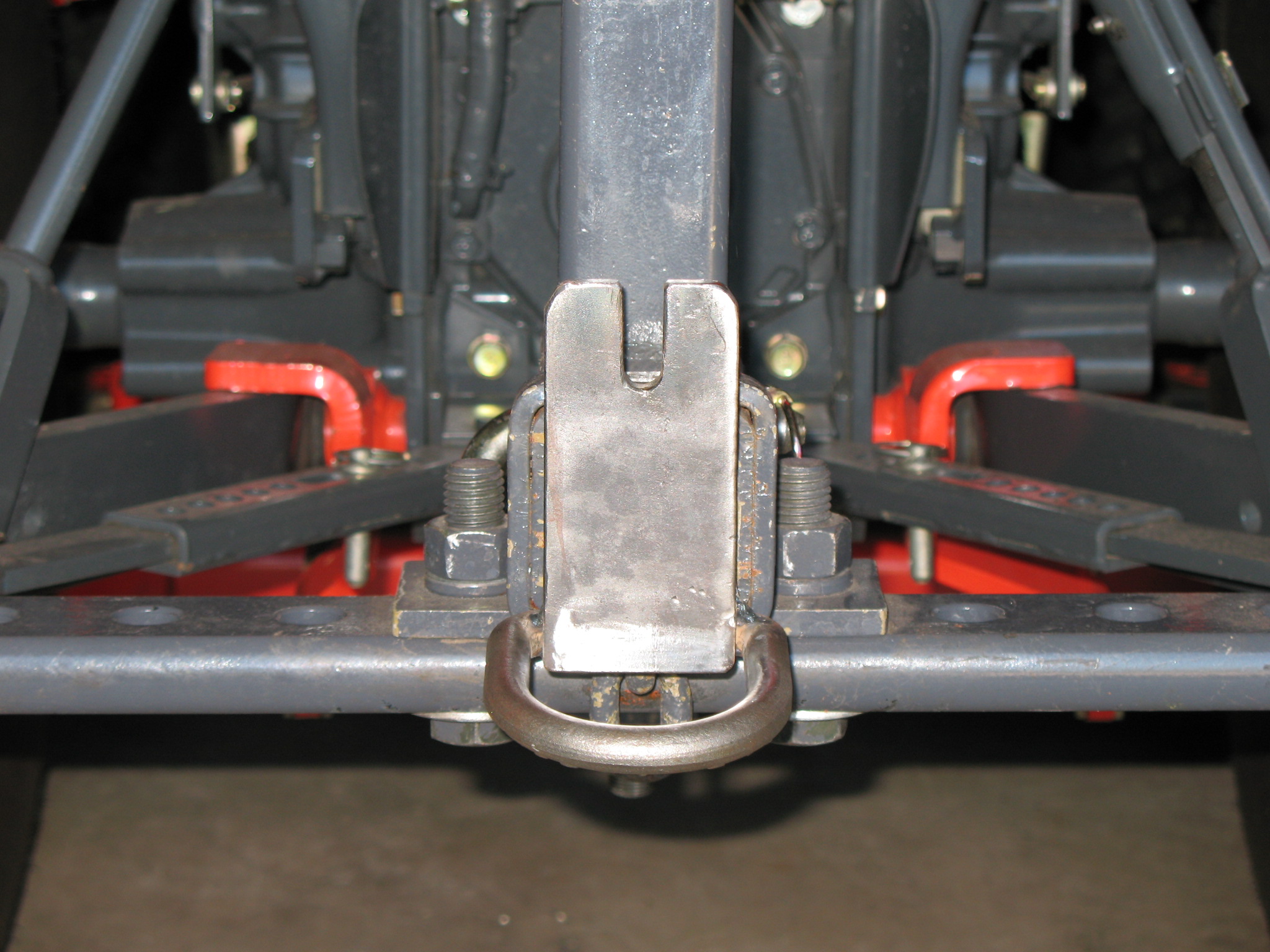

Hi, is anyone familiar with this 3-point hitch log skidder from Smallwoodlottools.com? I plan to use it with by BX23 for thinning my woodlot. I've been making do with chains and the drawbar. Nothing too big, stuff up to a foot in diameter. Thanks, Rusty

For no more than there is to it they sure are proud of it.
I wouldn't be hard to rig one up with more versatility.
1.An Omni Hitch with the boom attachment and logging tongs from Northern
2. A Quick Hitch and Logging tongs.
3. Build your own set up similar to theirs.
These could be used for more than just skidding.

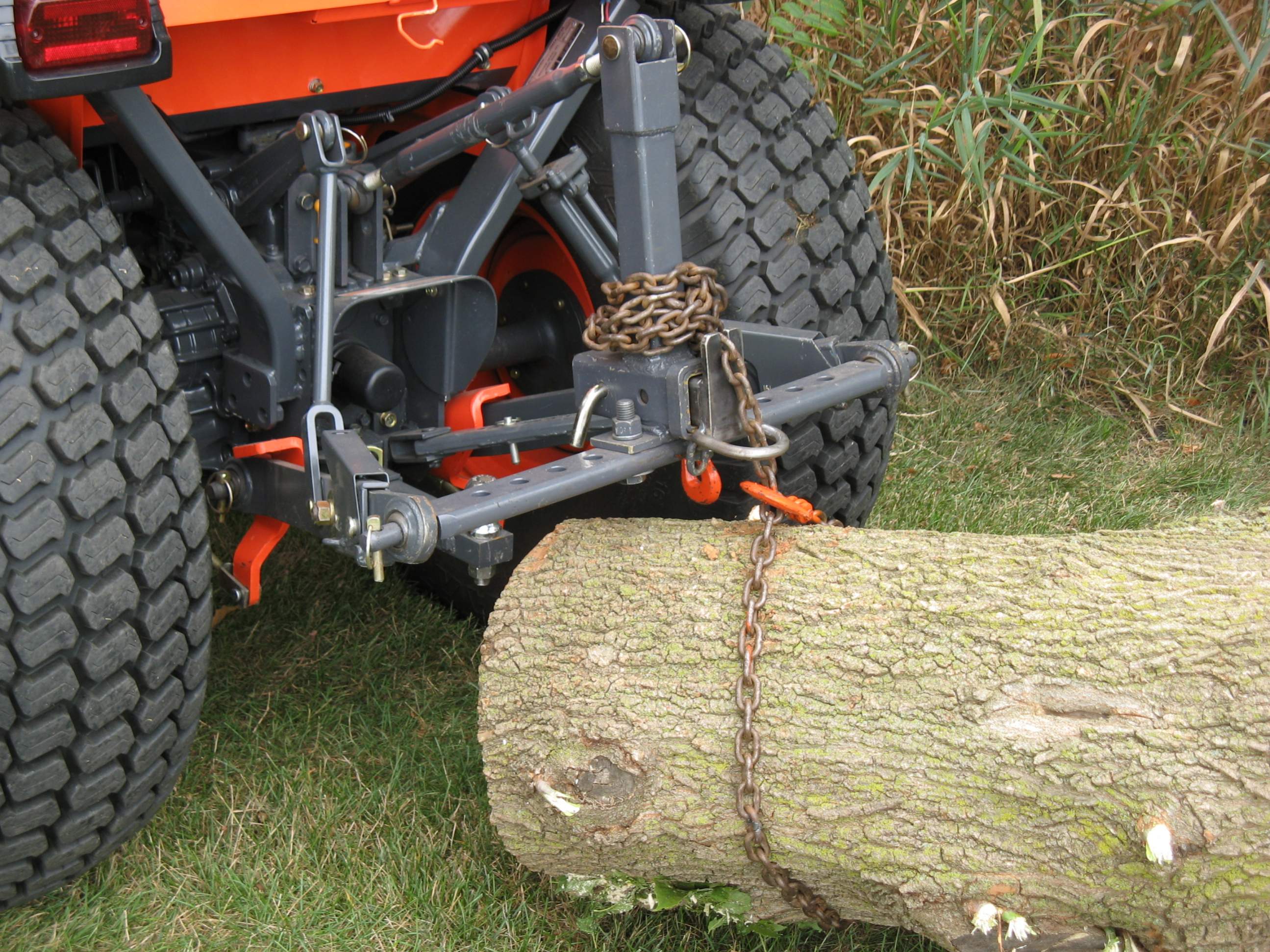

It seems to work well for logs that you can easily get to. It looks to be well made and well thought out. But, what about logs that are laying by a stump so you can't back straight up to it? Where there is a log there is usually a stump close by. Still hard to beat a chain with a slip hook on one end and a grab hook on the other. Add a grab hook on the tractor drawbar so you take up the slack in the chain and you have a simple system that will move a lot of logs. Works even better if you have it attached to the 3PTH so you can lift the front of the log.
Here is a picture of my setup.

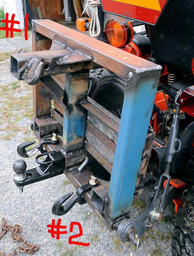

This is what I use. The upper #1 hooks do the lifting and the lower #2 hooks do the pulling. I use chains with a slip hook on one end that allows the chain to loop around and tighten onto the log. A grab hook on the other end.
The steps are:
Loop the chain around log and hook it to #1 upper hook.
Raise the log with the hitch and put the grab hook on a chain link right above the slip hook.
The slack part of chain then can be slipped into the #2 grab hook so the pulling force comes from the lower 3ph arms.
It is more simple then it sounds and works very well. I can haul 4-5 smaller (5-7") trees at a time and hardly ever had one slip out.
If you can weld or know someone who can it would be easy to fab up something.
