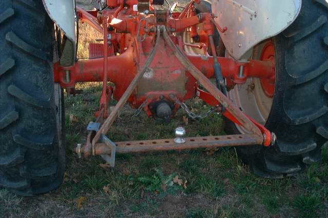

The attachment is the proper setup for a 3PH drawbar with a ball. Just remember if you put in the drawbar stays to the toplink bracket, don't go changing your 3PH lever to a higher setting. Doing that will test your relief valve and may bend the stays. The blue bracket on the left side in this photo is a common way of keeping the drawbar from rotating. Notice it has a cutout slot for the drawbar stay and will only work on the left side.
