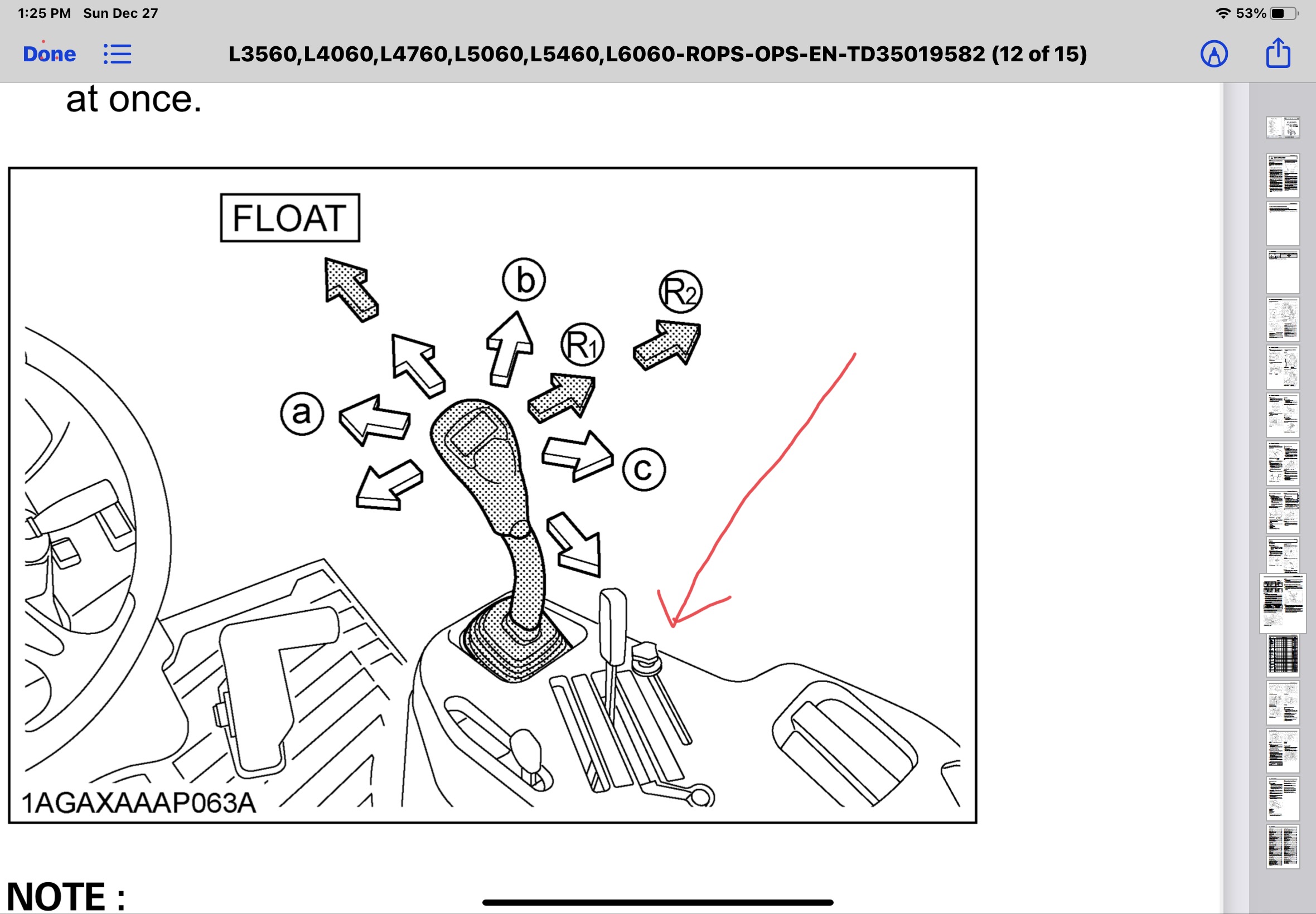

Maybe post a picture of what it looks like for folks like me that does not have a Kubota. We might be able to give some ideas if we see what is going on.
Edit: The plastic knob is small and difficult to turn or tighten with fat fingers or while wearing gloves. Also mine will jump out of its track if loosened too much which means getting off the tractor to reset under the fender. Member Jeff?? redesigned his and replaced the knob with a Allen head but I can not find the thread. The principal of the design has been around for 50+ years but Kubota just did a poor job using it on the Grand L.

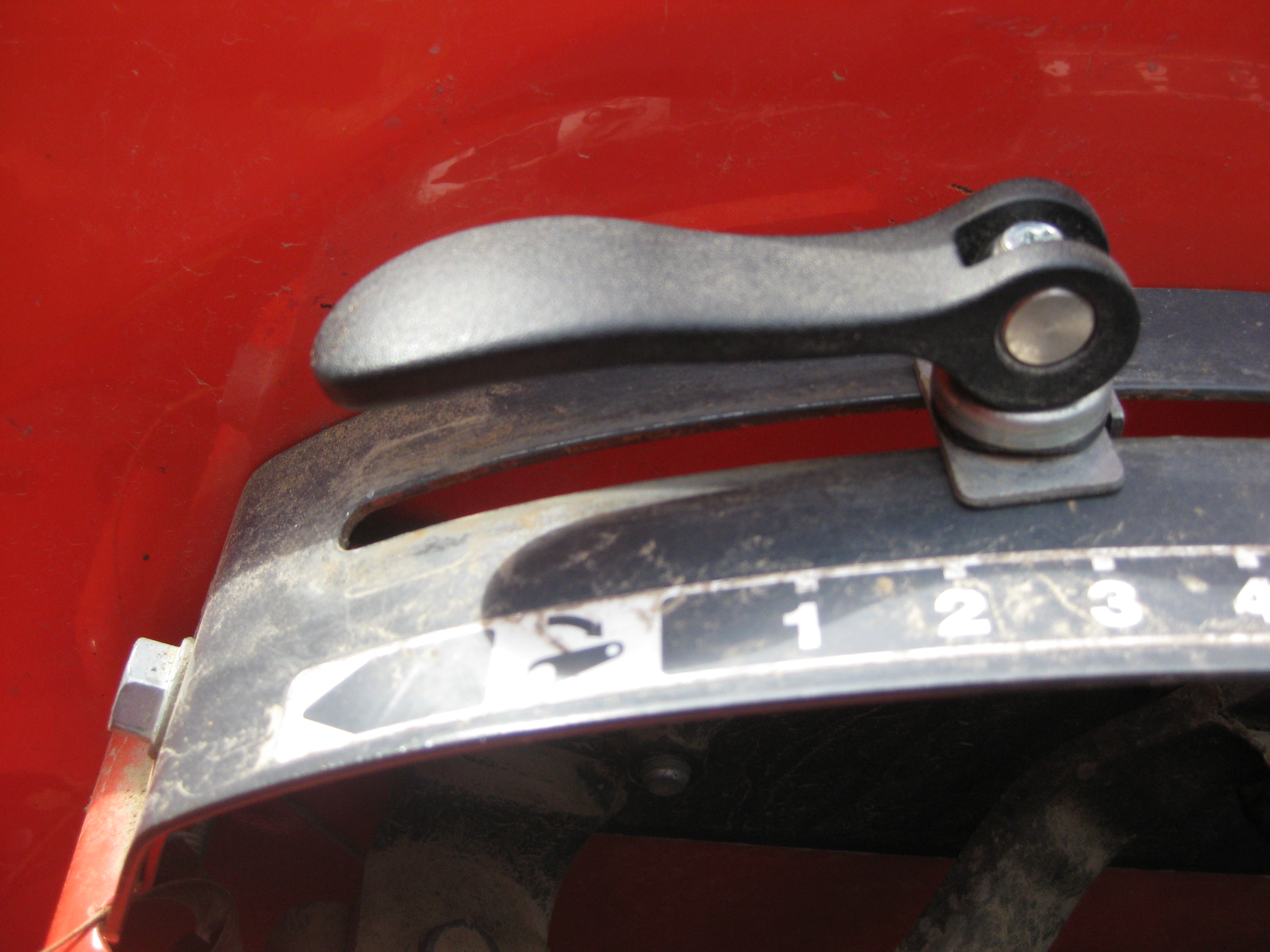

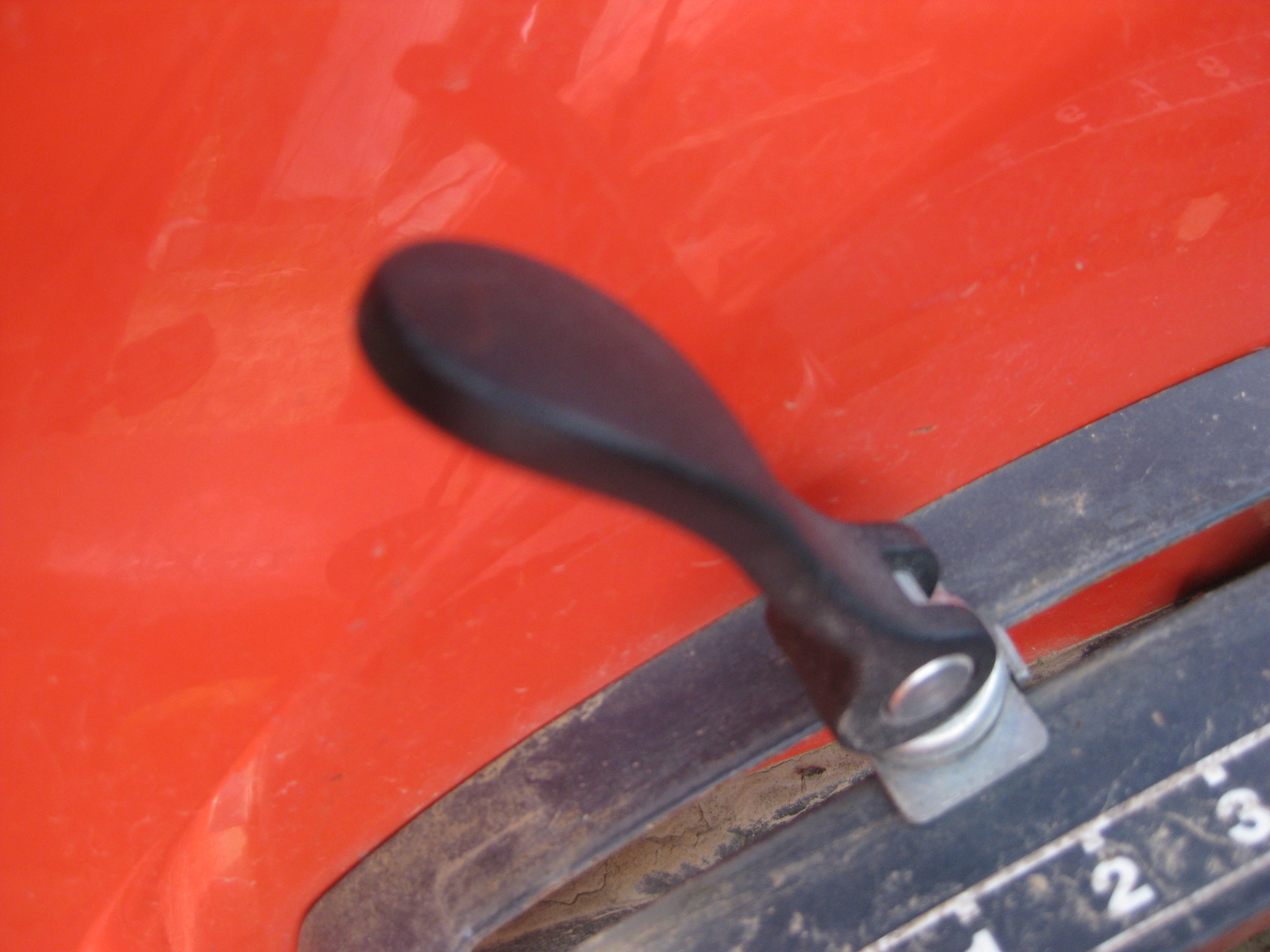

Yes, a cam lever is the way to go. I got mine from a bike shop, they're used on the seat posts. It was $6.
   / 3 Point Hitch Control Locking Knob #30
Use a cam lever with M6 threads X 20mm screw length. I ordered mine from Amazon. Works perfect. I use the stop a lot when bush hogging and planting.
