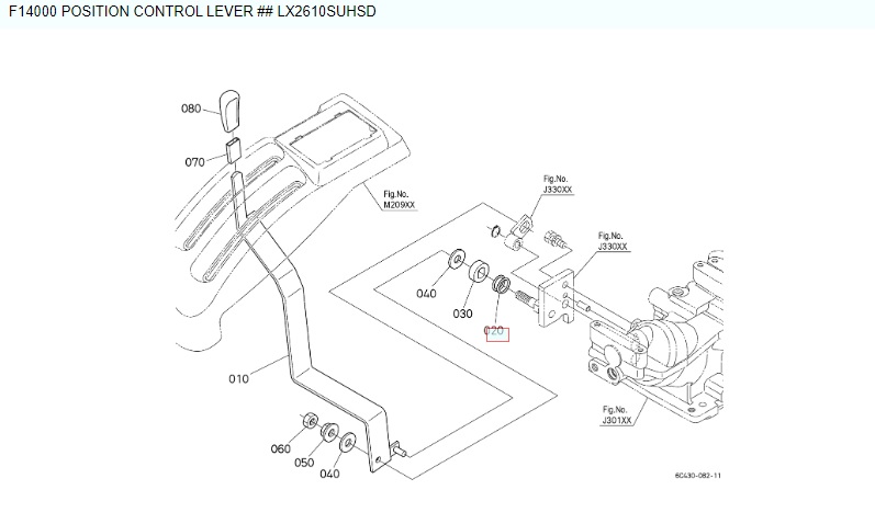

Oh, and check the spring and spacer (020 and 030) as well. Won't take a minute to just remove that end of the lever to check those parts for damage. Something's wrong if that lever doesn't stay up. Putting the stop up there is gonna get an attachment forgotten and left to drift down on top of something else. Always lower your attachments when you're done for the day.

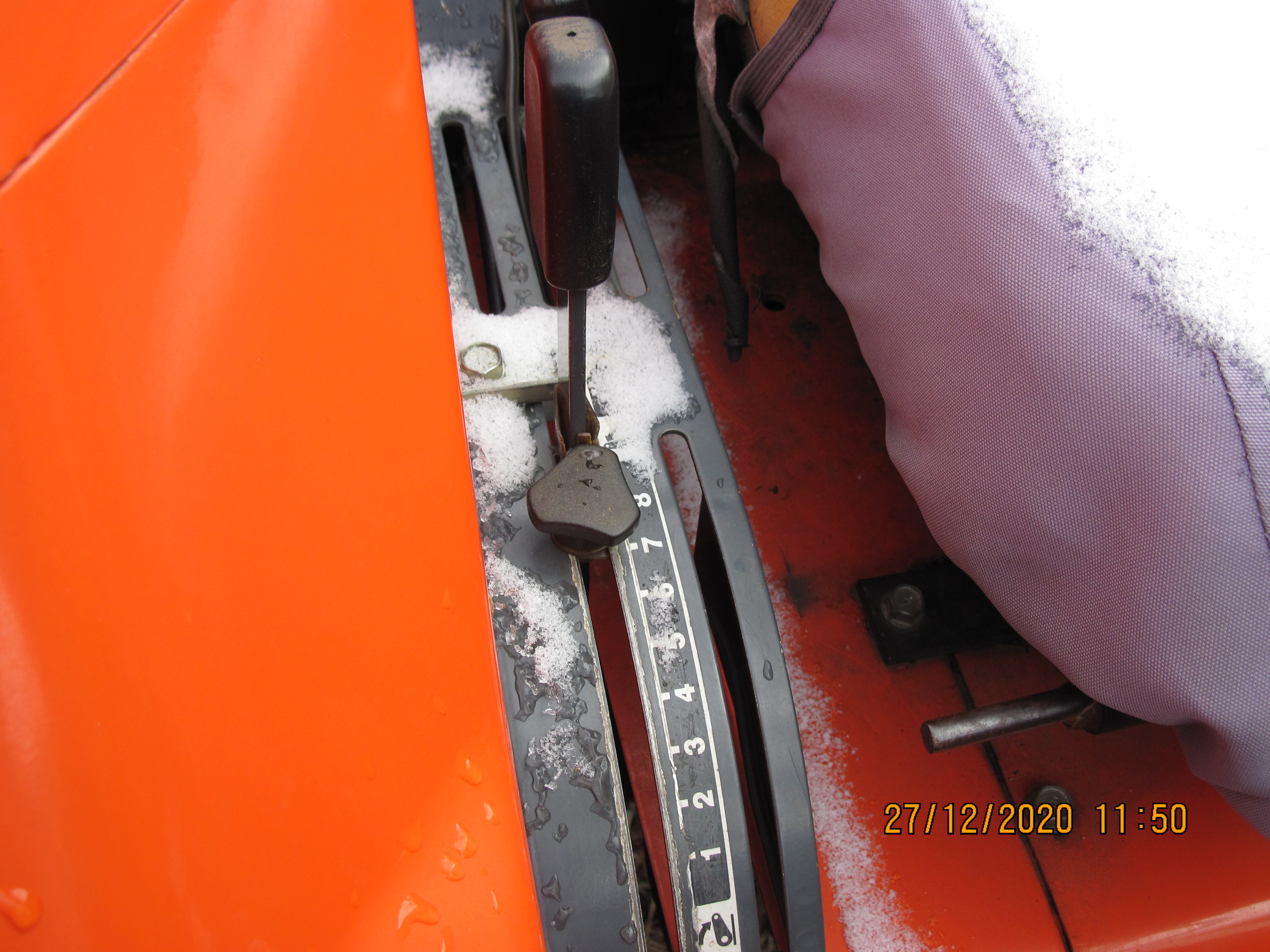

Here it is, all cold and crusty.
Must be a simple solution.
I see two issues. One is the friction adjustment as others have mentioned.
The second is having to screw the stop so tight to hold. Possibly a fix to this would be a wave spring washer under the knob. That way you would not have to tighten as hard to hold.

The only time I need to set that is with my sickle bar mower. If I let it set down to low it will bend the top link or the pto shaft. I deal with it like it is but don't like it with my fat stubby fingers. I considered replacing the knob with a longish threaded spacer with a piece of 1/4 rod thru the top like a T wrench or tap holder. But haven't done it yet.

Maybe post a picture of what it looks like for folks like me that does not have a Kubota. We might be able to give some ideas if we see what is going on.
Edit: The plastic knob is small and difficult to turn or tighten with fat fingers or while wearing gloves. Also mine will jump out of its track if loosened too much which means getting off the tractor to reset under the fender. Member Jeff?? redesigned his and replaced the knob with a Allen head but I can not find the thread. The principal of the design has been around for 50+ years but Kubota just did a poor job using it on the Grand L.
