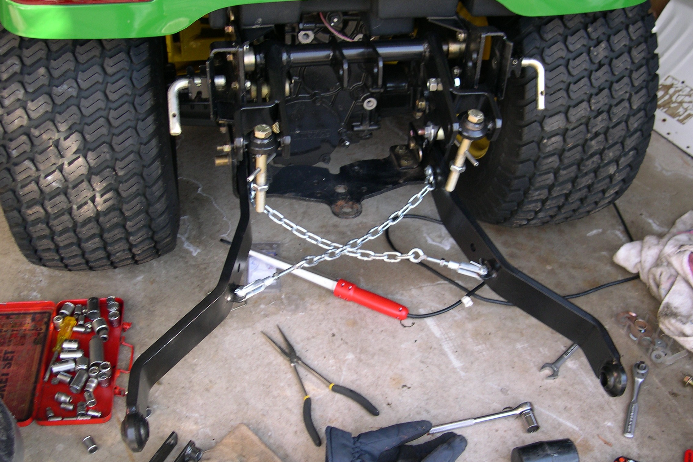

Go with the oem kit, I doubt you will find anything else that is remotely close to what you need. The link you listed is of no use whatsoever on an x749.

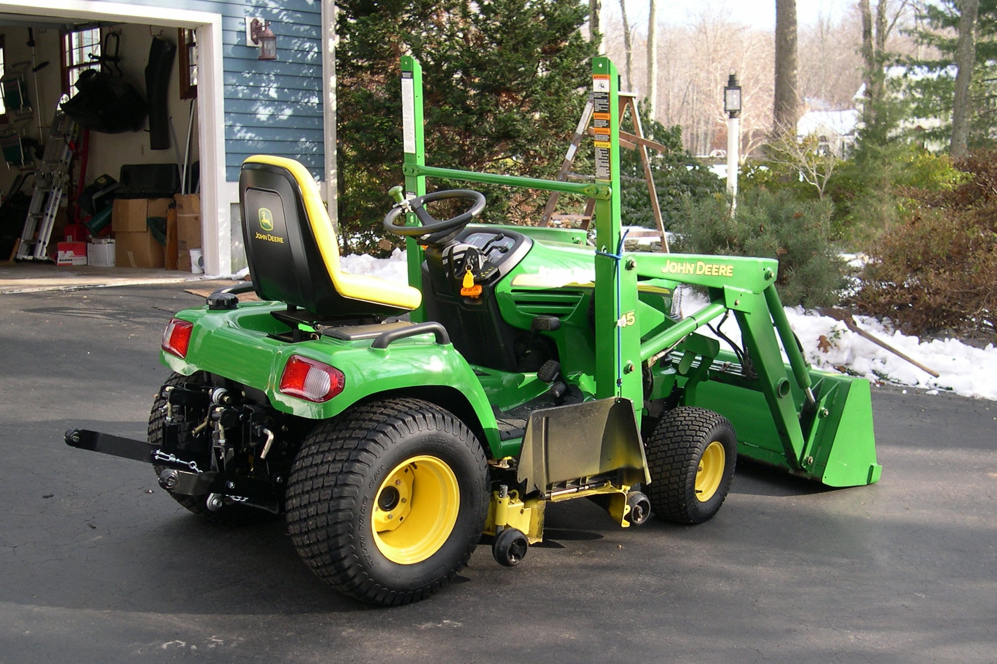

Here are some pics of the hitch to illustrate this.
/ 3 Point for X749 #3
I put a Ruegg 3PH on my old X485. Don't believe he has a website but he has a banner ad over on weekendfreedommachines.org with his contact info. Pretty sure he makes a setup for all of the X7 machines and for a few dollars less than JD.

Got a hold of Ruegg and he says Deere moved the lift cylinder on X7 series so it although his unit will bolt up, the lift will not work.

Looks like OEM it is...what size is the box blade...does the tractor handle it well?
That's too bad. Liked his hitch on my old X485. He'd do well to make one that works with the X7xx series given how many have been sold. Good luck with the OEM one, which will no doubt work.

The boxblade is a 48" Cammond, works fine with four front weights. I also have a 60" Landscape rake pictured below. The hitch seems to work pretty well, I am satisfied with it, it gets lots of use with the pine straw rake which was the main reason for getting it.
