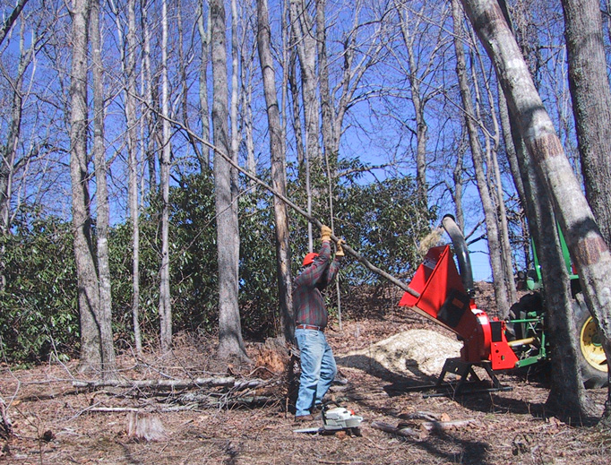

I had the same machine, branded Brush Hog, for a number of year and got rid because constantly cleaning the chips out from under it got old very quickly. Also, getting to the chipper blades to sharpen them was a total pain.
I replaced it with what is now a Echo Bearcat CH5540, which is available under several brands. I love the blower, which works well when I'm doing a large stack and putting the chips in a pile and also for spring cleanup when I drive down the driveway chipping wind fallen small branches and blowing the chips into the woods. Getting to the blades means removing one bolt and tipping the blower chute down.
I don't do a lot of small brush so the chipper only model works well for me. For homeowner use I think power feed it an extravagance.
Here it is in action:

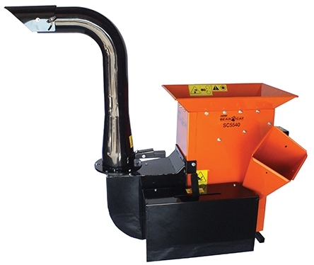

BearCat 5540 with the blower. Mine is several years older than this new model.
Most of my work is shredding not chipping. I can shred up to 1-1/2" and everything else gets burned. With the fan, there is no jockeying around or raking chips out of the way.
