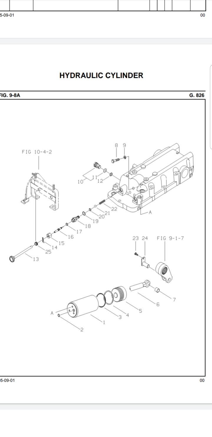

If you are speaking of the pressure relief valve on the side of the 3 point cylinder casing. I thought the same as well. I have no way of testing this relief valve. But the copper washer under it has been replaced. The one that came out of it from the factory looked as if they punched it into the hole. And was malformed. But it did work this way since 2003
/ 3 point and remote weak
#18
Screenshot_20191119-182940_Drive.jpg. #10 is the pressure relief valve to the 3 point. I have replaced the copper washer that goes behind it. As for the relief valve itself. I have no way of testing it. Is this the relief valve to are speaking of?
/ 3 point and remote weak #19
View attachment 629388. #10 is the pressure relief valve to the 3 point. I have replaced the copper washer that goes behind it. As for the relief valve itself. I have no way of testing it. Is this the relief valve to are speaking of?
That looks like the safety relief valve for the 3 pt. Like, if you have a heavy implement on the 3pt, you then happen to drive fast over an aggressive bump, that relief will let go to relieve the shock load. So it wont, either break stuff or blow the seals of the piston. That's why there is no way to adjust it.

#20
Yeah I a sure that's what it is. I was asking Tx Jim if that was the relief valve he was speaking of.
