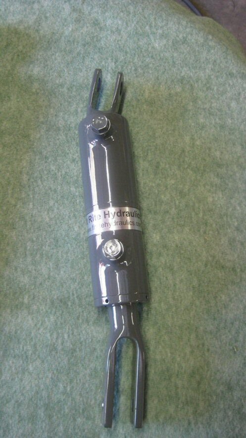

I'm not sure you will be able to find a double acting cylinder in the size range that you need with no ends. :no: Probably going to have to get a welded unit and cut off the ends. I recommend that you get a tube type welded unit and go from there. Maybe Bailey?
What tractor are you building this for? Are you going to build it to get single side tilt, or to tilt in both directions equally?

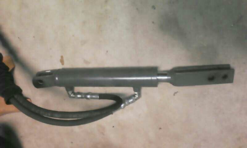

I use a 4" stroke unit and with a small modification to the lower clevis, Then you have a unit that gets you an equal amount of tilt angle to each side.
Why would you use a 2 1/2" or 3" dia unit? 2" is more than enough for that tractor. I'm not sure that a 3" dia unit would even fit? :confused3:

NCM_0824.JPGFound a picture of my tilt cylinder.

Try bailey, I order stuff from them a lot.

Thanks for the replies and advice...not sure why I was looking for such a large bore cyl...likely because that is what I had on hand that I could make work 8 years ago when I first fabbed a tilt cyl,
...It was a 4" stroke and I did set it half extended when I set the length to what the solid link was...gave me plenty of tilt in both directions...
I will expand my search now to include down to 2" bore cylinders...thanks again for the advice and the links to the sources.
