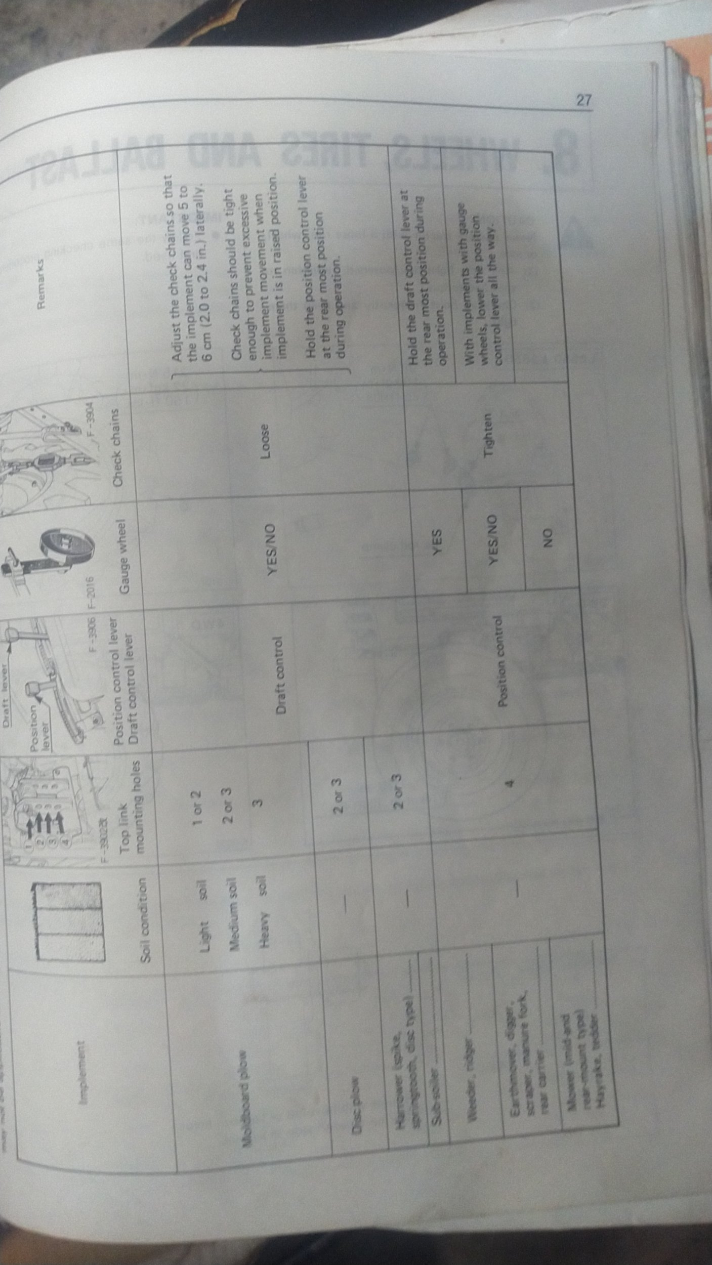

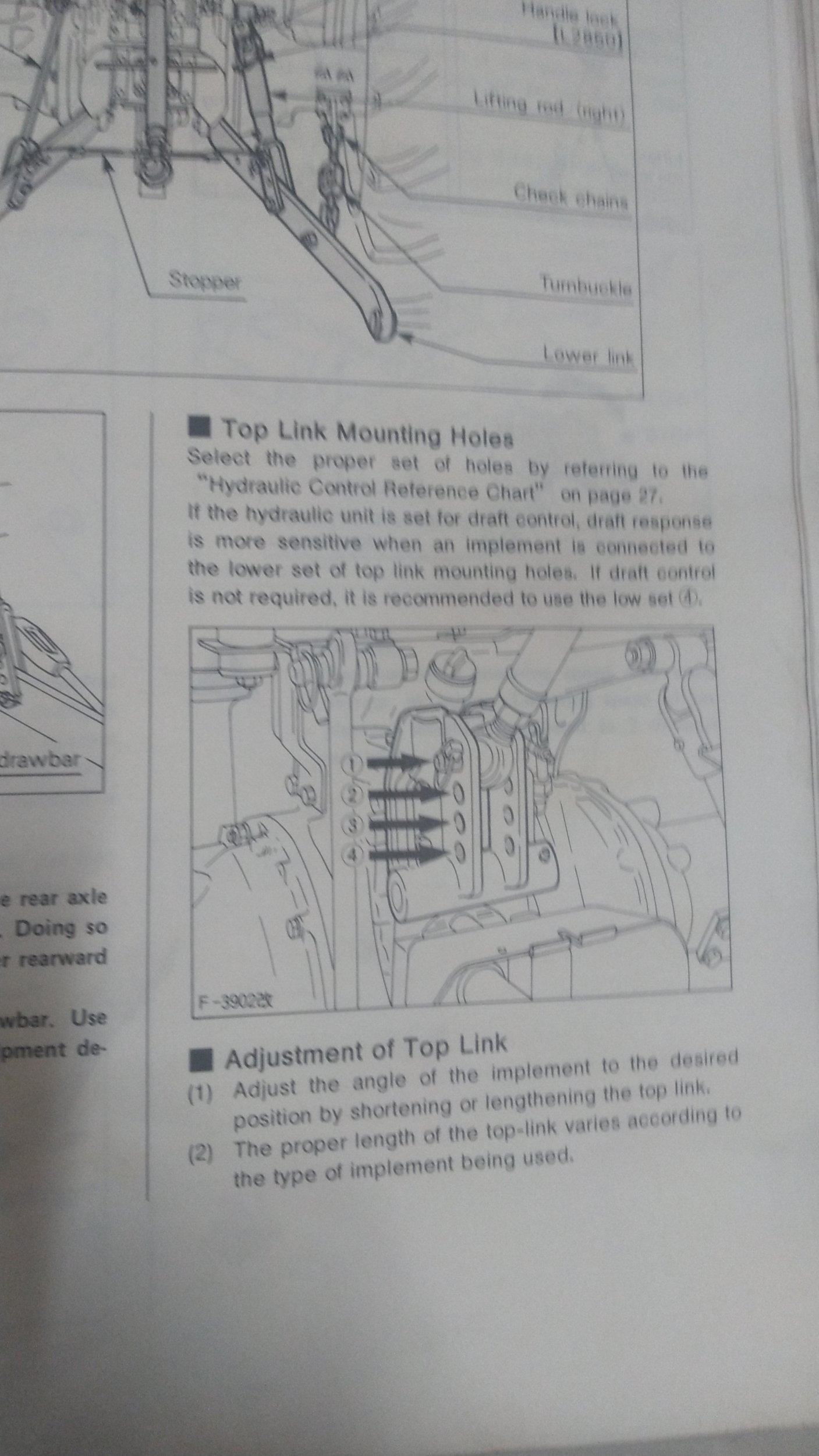

Per an old manual from a 35yr old l2850 lower the hole on tractor less stress you put on rear end I believe.
