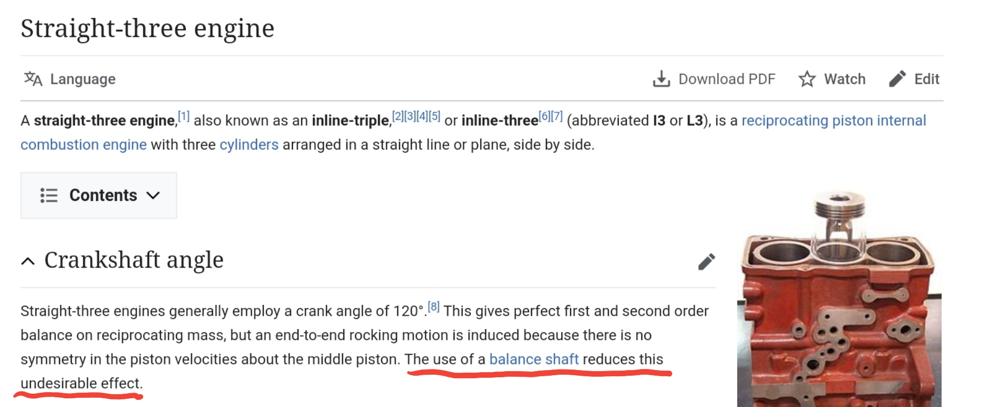

So I have been doing research on 3 cylinder vs 4 cylinder Diesel engines.
Has anyone actually tested if a 3 cylinder is more fuel efficient? Or tested which one is smoother, quieter etc?
For example I have a Mahindra 5555 with a 2.7L 3 cylinder engine (55hp) I believe it痴 same engine in 5570 (70hp). A friend has a LS 6168 with a 2.5L 4 cylinder engine (68hp).
It got me thinking which one was best. Not a tractor to tractor comparison but 3 cylinder to 4 cylinder comparison.
Note* (fun fact) my 3 cylinder rated 540 PTO RPM is 2059 engine RPM while the LS is 2500 engine RPM.
I have browsed and read a lot on this subject from multiple forums but most info seems to be opinion not factual testing.
It all depends on the engine design regardless of the number of cylinders. They can all be made to be well balanced. Fuel efficiency is again dependent on the design Of the systems involved and the situation used in.
There is no better or worse based on the number of cylinders.

   / 3 cylinder vs 4 cylinder debate #51
You can see two 3-cylinder engines in my avatar.
Smaller one has licensed FIAT engine, known in Long tractors there decades ago, 2,34 litre 45HP@2400rpm,
Bigger one has SAME air cooled engine, 3,0 litre with turbo, 70HP@2350, know there also as AGCO5660 (version without turbo, 60HP).
My conclusion: I'll buy 3-cyl FIAT engine again, as it is smooth running, quiet, no vibration, very explosive engine, like run even to 2600rpm .
SAME engine has big vibrations (feel on steering wheel, especially under 1500rpm), high noise (even on liquid cooled engine version) with rattle sound, high peak torque, but low torque at nominal speed, and hate high rpm (over 2200). I'm regretting that I didn't buy 4-cyl version (4 litre).
So, it's up to the engine construction.
Today, Fendt produces 200 series tractors from 80-115HP engine with 3-cylinder 3,3 litre engine... In a old days 89...90HP was border to 4/6-cyl engine...
Bigger frame, Fendt 300 series , has 4-cylinder 4,4 litre engine in equal power range.
My 2 cents...
