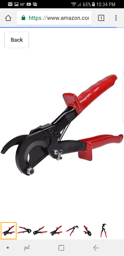

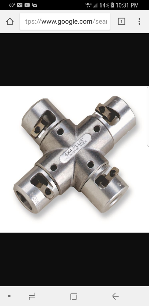

I understand I won’t get a huge return on my time, but since I have access to many scrap cars, it feels wasteful to send them to the scrapyard with large wires still intact. I’d appreciate advice from the pros. Even if I skip the smaller wires and focus on battery leads, I need recommendations for the best cutters to reach in and sever cables close to the starter. Ideally, I’m looking for 1-2 foot shearing-style cutters and suggestions for a quality motorized wire stripper—drill or electric. Is small-gauge wire worth the effort? Thanks for your insights!
/ 3/0 Wire stripper/cutter? #25
With the right stripper unit, all gauge wire is worth stripping! A manual unit with wire sorted will go fast. That way, you set for wire size and strip all that size, then readjust for the next size and repeat.
