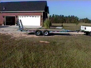

Check the title/registration for the weight limit.
/ 2OOO Hudson 5 ton Trailer #22
If trailers sell up there like they do here, I'll bet if he just holds firm, he'll get the $1,000 for it and not take too long to do it either.

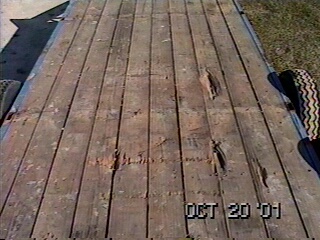

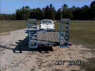

I have a real hard time believing that is a 10,000# trailer. Maybe so. For a year 2000, and all that is wrong with it, no fenders and the owner claims that he over loads it, no way. There are plenty of good deals out there on new or very good used trailers. I'd encourage you to keep looking.

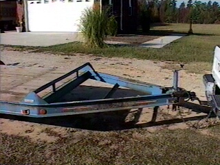

I had a Hudson trailer. Sold it to the neighbor a couple of years ago. It looked just like the one in your pictures. Except it had fenders and 2 wheel brakes.
It was rated for 6000 lbs gross weight. I did not like the construction type tire and wheels. These wheels cannot be balanced easily. They are not easy to mount on trailer with out some run out.
The only problem I had was one of the rear spring brackets was not welded properly to frame and it broke.
There was a tag near tongue that stated its load capacity.
It wasn't a bad trailer./w3tcompact/icons/tongue.gif But I would look for more features and different wheels on a used trailer for $1000./w3tcompact/icons/wink.gif

If the guy has has been overloading the trailer - even if he hasn't managed to bend the frame - he may well have induced some cracking in the frame welds and/or damaged the wheel bearings.
Now there are many cheap ways to hide that kind of damage - extra shots of grease and leaving the frame dirty - but only a few expensive ways to find it - ultrasound, tear-downs - or catastrophic failure.
I would run from this particular deal - I'm not one for buying into other people's poor maintenance.

I looked at your pictures again and I think I'd pass on this trailer. That thing looks like its been refitted with mobile home axles and tires. Not that mobile home axles are bad, if I built my own trailer I'd use a couple of the 25 or so I have still bolted under my rent trailers. It might be a sign that the original axles were destroyed. If that's the case, what else has been ruined?
/ 2OOO Hudson 5 ton Trailer #36
A lot of smaller trailer companys use those axels, I have a 5 ton Hurst trailer that is built in Tenn. and it has those axels also. The trailer he is looking at looks like the original owner might have taken off the fenders especially if he was hauling logs, the fenders would be in the way with loading and unloading. I would pass on the trailer and buy new or from a trustworthy source. The amount of damage created if the trailer should break is not worth the risk also if the lights don't work it is probally because he has been using it in fields and woods when he was loading logs and tore out the wires. I paid $1700 for mine brand new.
