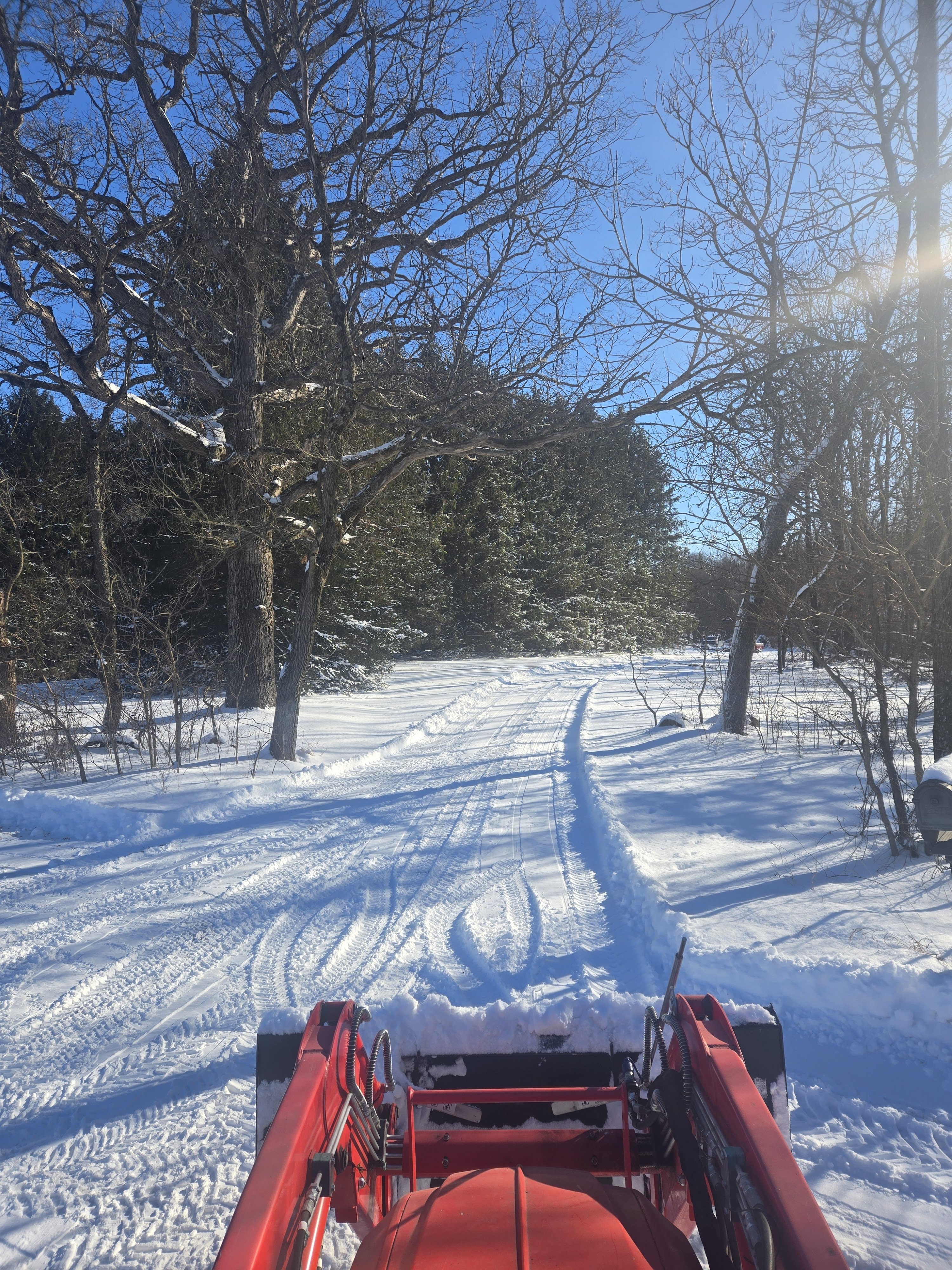

My wife likes the rural "2-track" look also, but I can't bring myself to leave the driveway alone long enough to allow it to develop. The best we get is some summer weeds in the middle here and there.
I wouldn't mind grass in the middle aesthetically, but maintaining a full crown for drainage and getting good snowplow clearing is my primary goal. Doesn't snowplowing scrape the grass off?
/ 2A Limestone for driveway #31
Nope.. the racks are a little lower, sunk in, and I dont scrape all the way down.
