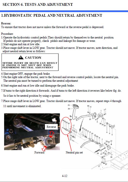

I have a 2012 T293 that has worked flawlessly ... until recently. Most of the time, when you let up off the pedel, it will creep in reverse. This happens about 70% of the time. I imagine that there is an adjustment for that. Does anyone have the repair manual for that? Anyone experience this before? Any suggestions on how to fix it?
thanks.

The reverse pedal on my 503 wouldn't completely return to neutral, all I did was just get underneath and lubricate all the pivot points with WD40, worked fine afterwards.
My Kubota would constantly do that unless it was cleaned and lubricated
/ 293 Tranny creep #3
If the lubricating doesn't fix it look in your operators manual and it will show the pedal adjustment. Under the platform by the pivot point for the pedals there is a bolt to loosen and slightly turn the adjusting nut. Then retighten the bolt and get on the tractor and give it a try. Depending on which way you move the adjusting nut will make a difference on the pedal centering. You will need to be on the tractors seat when you test it as if its to far one way or the other the tractor will move in that direction when started.

Good Afternoon!
Could you private message me an appropriate email address?
I have a diagram detailing several ways to fix this issue!

/ 293 Tranny creep #10
Hopefully this helps you.
/ 293 Tranny creep #11
myyaz33 has the fix for you - just be aware that 1) it isn't running when you do the adjustment and 2) it doesn't take much of a turn to make a big difference, more of a 'suggestion' of a turn should do it. It is easy to do though.
