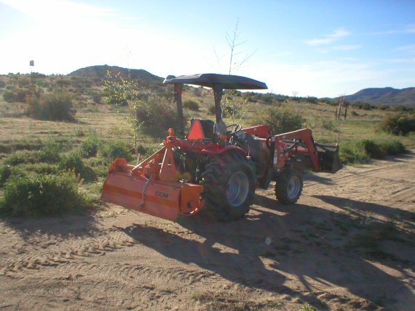

I have a 3215HST and run a CCM MR-160. It tills 58" wide. I feel like my 3215 could handle a 72" wide tiller with no problem in our soil, but for where I till, I need the narrower width. I do not notice any tire tracks left behind with my 58" tiller. I think that your tractor could handle either a 60' or a 66" without any problems.
Good luck and let us know what you get and how you like it.
