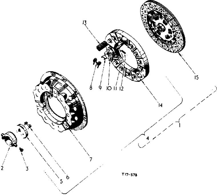

I have a 276 international that wants to keep going when you shove in the clutch. Hit the brake and the clutch disengages. Do i need an adjustment or new any and all info appreciated.
/ 276 clutch trouble #2
Here is an exploded view of your clutch assembly, and part listing to match.
If you have approx. 1" to 1 1/2" of free travel in your clutch pedal, then it may be internal. ie; Broken spring(s), release lever, clutch disc hanging up on main shaft, worn pilot bushing, etc.
You don't mention if it wants to creep after tapping the brake... If not, I'm thinking it may be the disc hanging up on the shaft. I'm thinking if it were a broken spring, or lever, it would have a tendency to try and keep pulling itself.
Then again, on my Case 310B backhoe, the previous owner left the inspection plug out of the bellhousing/torque tube. This allowed apparently mice, and ground squirrels a place to build their winter home. When I split the tractor to replace the engines rear main seal, I found about a half of a 5 gallon bucket full of, uh.., greasy/oily, 'stuff". Leaves, string, walnut shells, etc. all wrapped up in and around the pressure plate... There was a definite improvement in the clutch, after cleaning it out...
Again, if you have the proper free travel in your pedal, sounds like you may need to split the tractor, and see what the problem is. Not all that bad of a job, if you have the proper place, tools, blocking, etc. and a good manual.
1 751726R91 CLUTCH CLUTCH, 10" spring centre, comprising
1 705542R91 STOP BEARING
1 3040411R91 CLUTCH ASSEMBLY COVER
1 3040412R91 CLUTCH DISK PLATE
2 705543R1 RETAINER RETAINER
6 179839 BOLT BOLT, Hex, 3/8"-16 x 1", G5
6 103321 LOCK WASHER WASHER, LOCK, 3/8"
2 705542R91 STOP BEARING, and cup, assy.
3 2 705543R1 RETAINER RETAINER, spring
4 3040411R91 CLUTCH ASSEMBLY COVER, clutch, assy., comprising
5 705538R1 PLATE PLATE, release lever
6 3 705530R1 SPRING RETAINER, release lever plate
7 705537R1 COVER
8 3 705531R1 SPRING SPRING, anti-rattle
9 3 700915R1 STRUT STRUT
10 3 705536R1 LEVER LEVER, release
11 3 705533R1 BOLT EYEBLOT
3 705532R1 NUT NUT, eyebolt
12 3 700913R1 PIN PIN, release lever
13 12 700910R1 SPRING SPRING, thrust
14 3040415R91 PLATE, pressure
15 3040412R91 CLUTCH DISK PLATE, clutch driven, assy.
3040413R91 FACING PACKAGE, clutch driven plate facing
