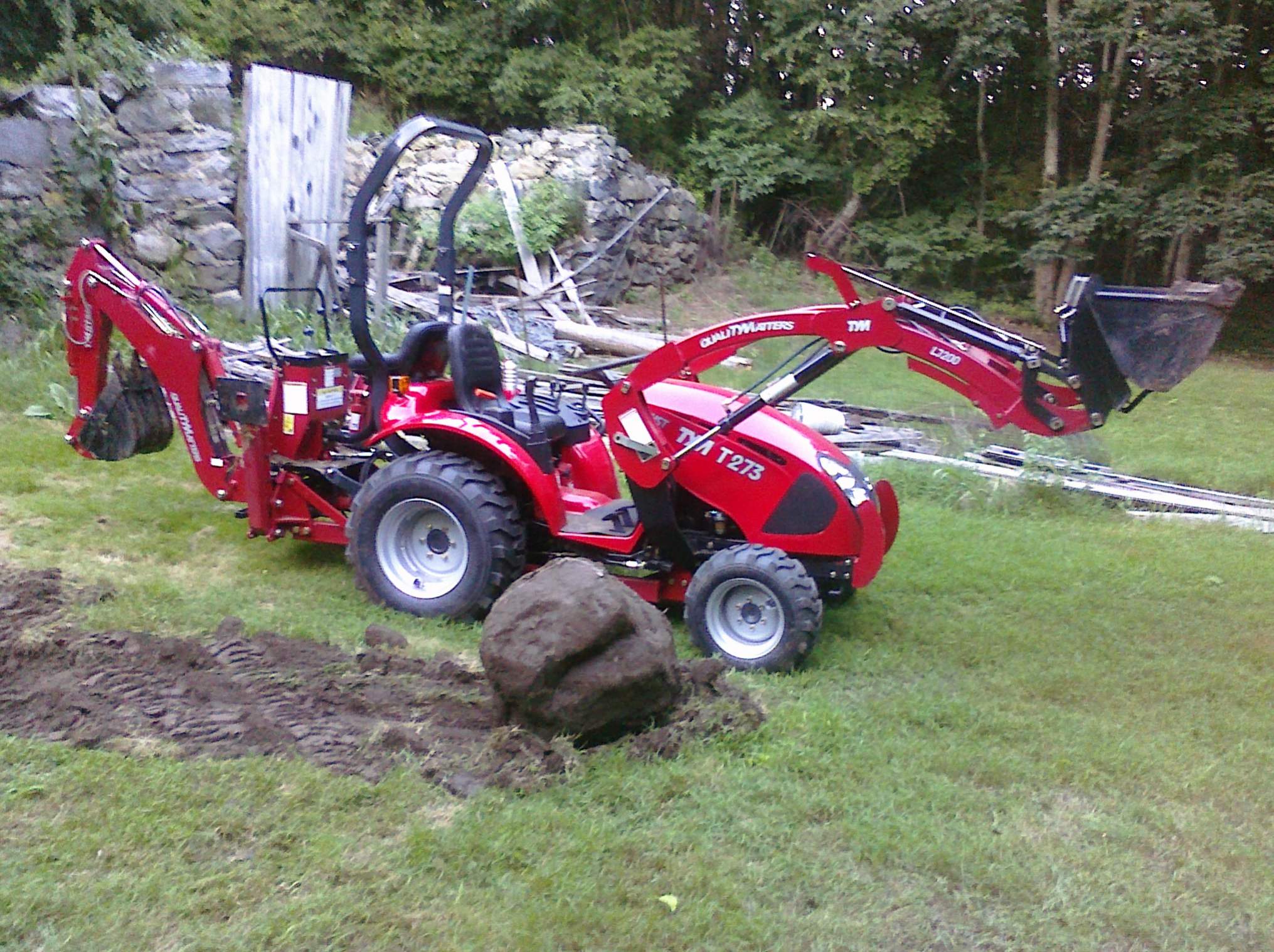

I recently purchased a TYM 273 with FEL and factor backhoe. When using the backhoe I have noticed hyd oil coming out of the breather hole of the tank cap. I swaped out the cap and it still came out. I then plugged the hole and the fluid came out the breather tube. This does not happen with the FEL. It is now with the dealer and they feel the cap was defective however I have tried 2 and had the same result.
I am waiting for the dealer to test the unit with the new cap, due tomorrow but I am not optimistic. Anyone else have this issue or thoughts on the issue? I love this machine and hope this is a fluke or simple fix.

did you try reversing the lines........
/ 273 hydraulic issues with factory backhoe
Funny you ask. I had read a previous post where the ownr did just that to resolve the issue. I called the dealer and suggested they try that. They called back and said it worked. They returned my machine tonight so I will give it a try in the morning.
I had asked the TYM eastern service manager about this and he had heard of this leak issue and was perplexed because it was random on these compacts. After thinking about it it makes sense, the BH is dealer installed and they have a 50/50 chance of getting it right. There is no clear indicator on how the connection should go. I will add matching colored zip ties if this works.

Yes- Had that problem and still do. The dealer said to switch the lines but it didn't change anything. I finally ran the breather tube into an overflow bottle, plugged the hole in the vent cap and at the end of the day I pour the overflow back into the filler. I plan to take the unit back to the dealer in Oct and leave it there for the winter if necessary until the problem is fixed. Now---the diesel preheater has failed and the dealer has not returned my calls. I like the tractor but these "Jeez, we've never had that problem" or "I thought I called you back" responses are getting old.

Switching the lines worked well. I ran the backhoe for a few hours since and I did get a little leakage from the breather hole but the cap needs to be rotated a half turn so the bevel is oriented correctly. Your solution is a good temporary fix but I agree it is not the way you should have to run your machine. Keep me posted, the performance seems fine on my machine. I still need to contact the service repp at the "factory" to see if this fix is legit or there is a bigger issue at play. How many hrs do you have on your machine. I hope this is not a sign of things to come. My dealer was pretty good at dealing with y issue even though I gave them the fix. Good luck.
