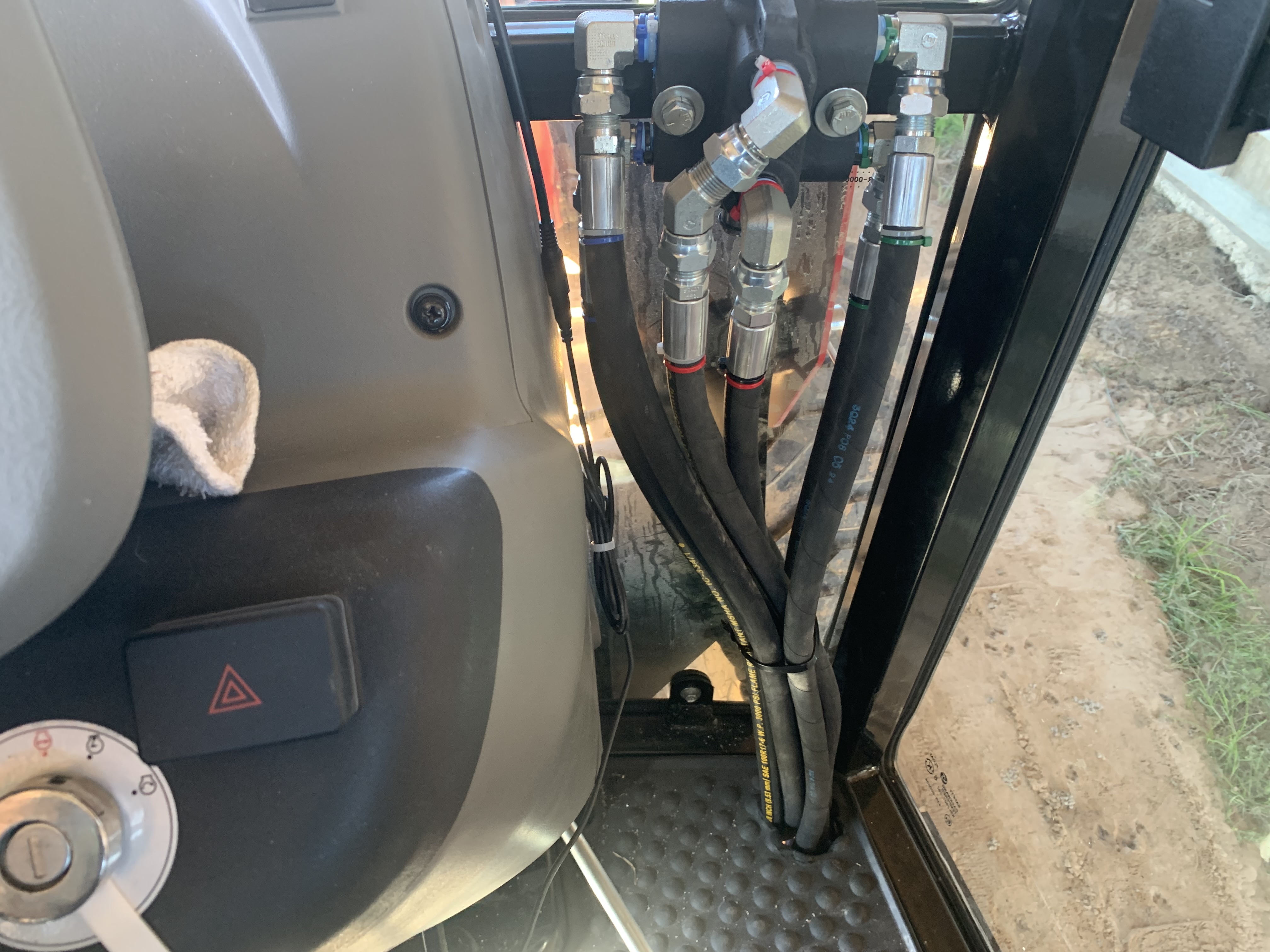

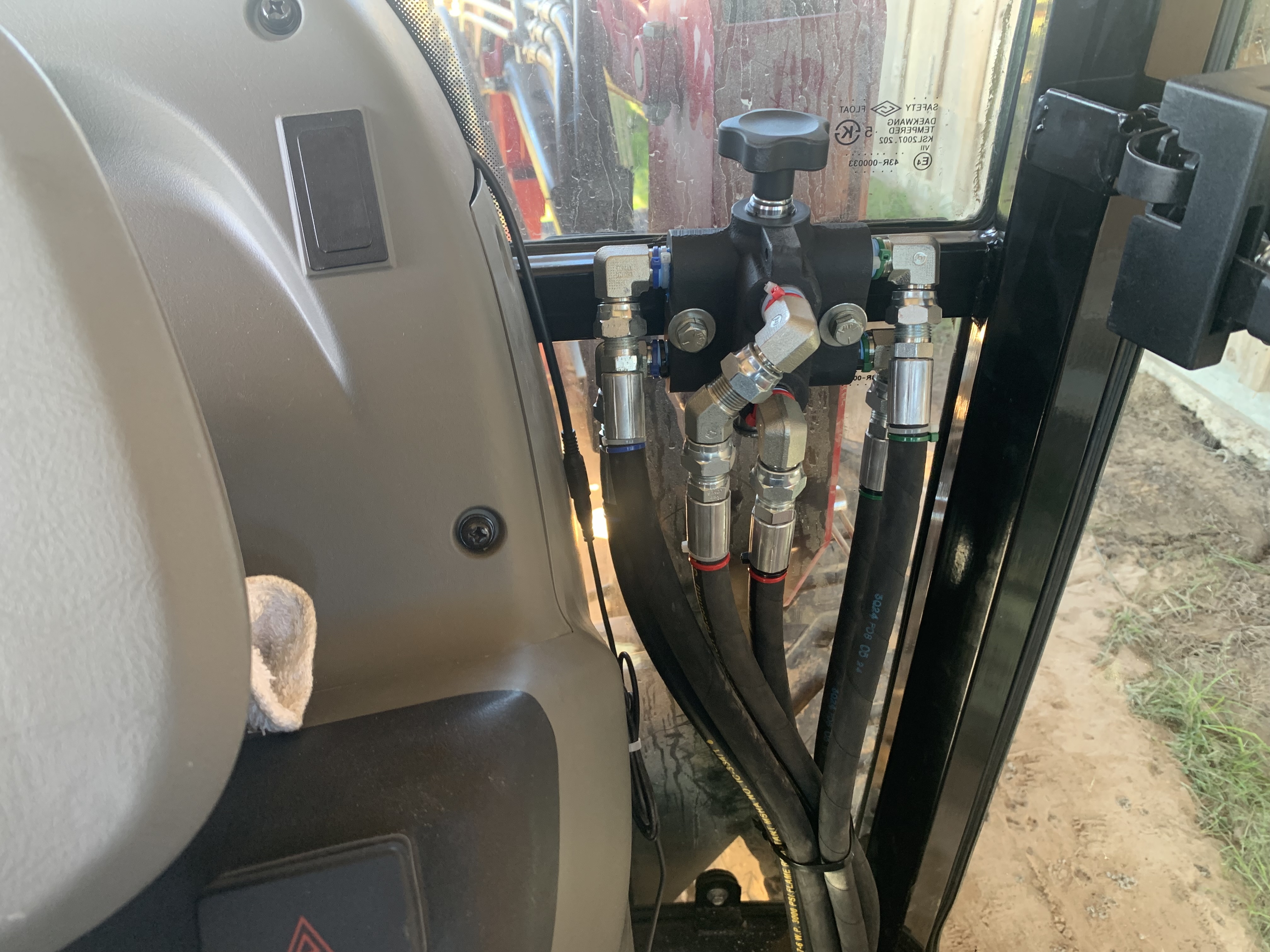

This is what the kit looks like installed from tractor innovations at a cost of $625 tax shipping total cost,it is connected to the dump curl cylinders only and Andy with TI is great to work with if you have trouble installing. I love the price and simplicity of this kit, it does the job without breaking the bank.

Glad that it worked for you. I do have a concern for the amount of heat that is going to add inside the cab tho.
/ 2660 cab tractor remotes
#13
Thank you Engineer for the comment but can you explain how it will add heat to the cab?

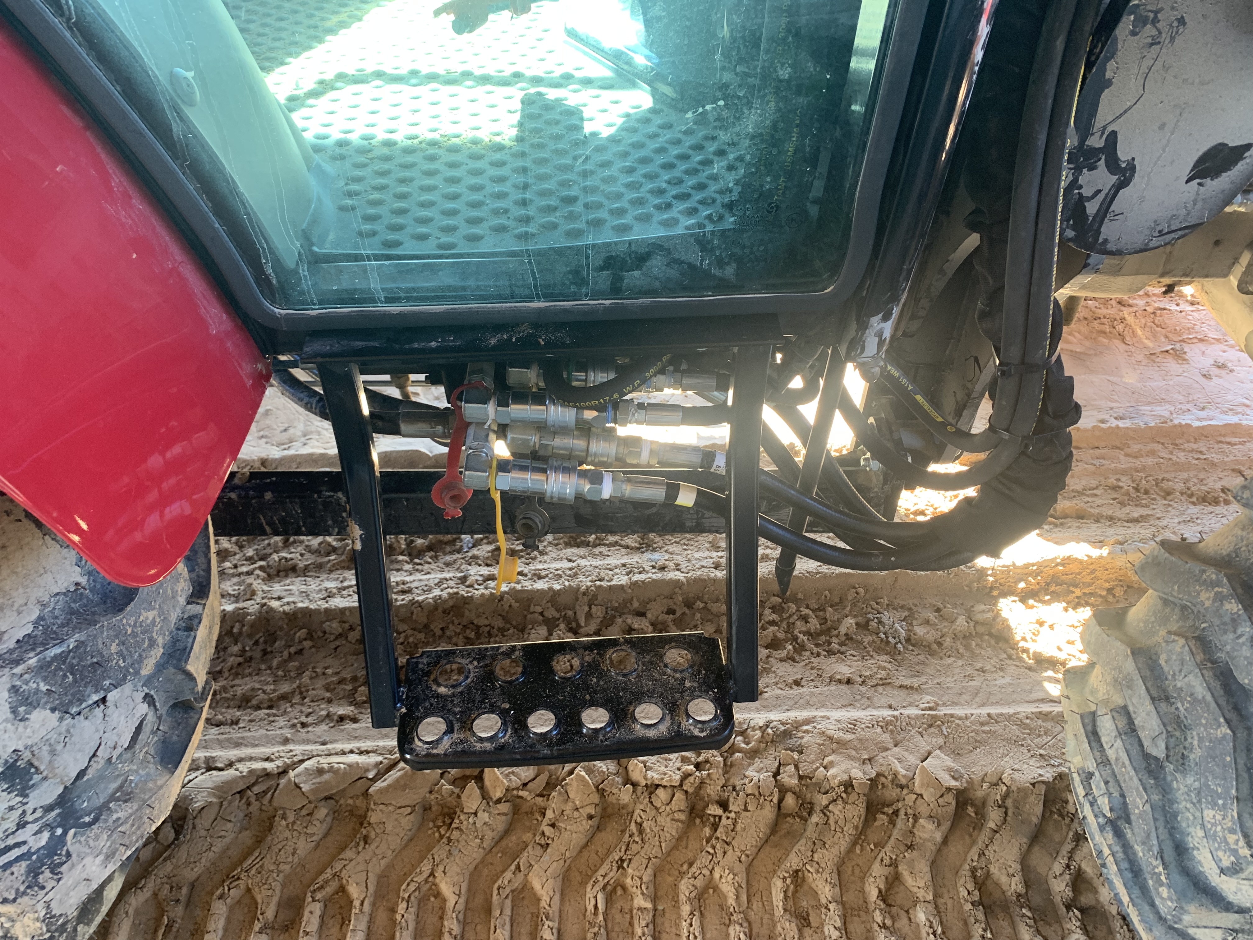

How do you add a second rear factory remote? Does it just stack on top of the existing valve?
#15
No instead of placing the
just install the hydraulic quick connector to the rear instead of the front of loader, go look at one of his u tubes then you can see how simple it is.
