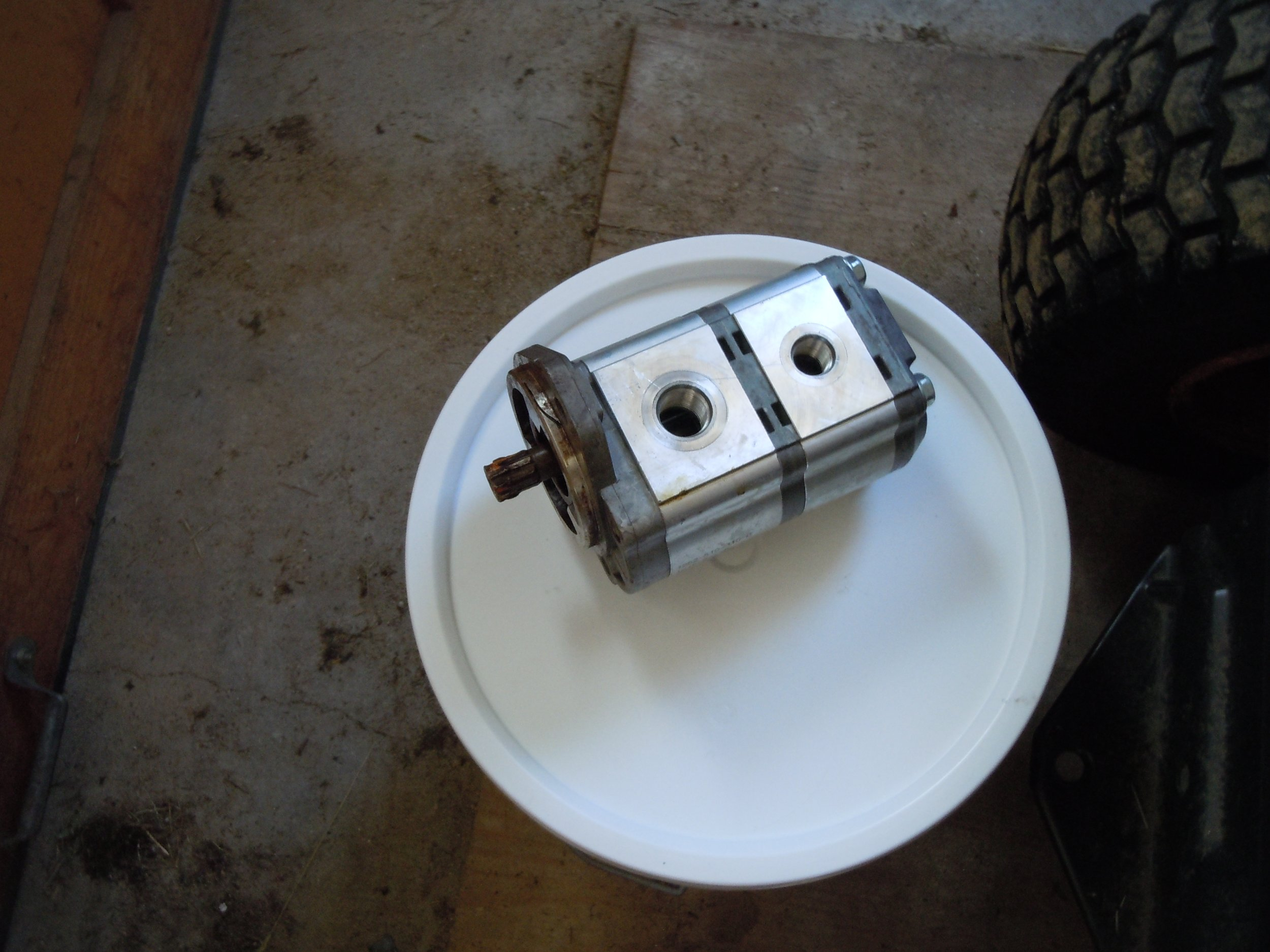

   / 2655 HST Pump gone bad, no help from Mahindra #19
That is your hydraulic pump for your remotes and 3 point on the larger section and your power steering on the small section.
Your main "hydro" pump would usually be construed to mean the portion of the hydrostatic drive system that drives the motor section.
   / 2655 HST Pump gone bad, no help from Mahindra #20
Thanks Lou, That looks more like that $$$!
