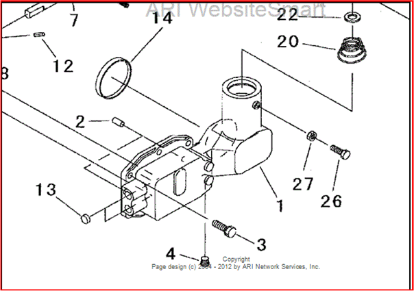

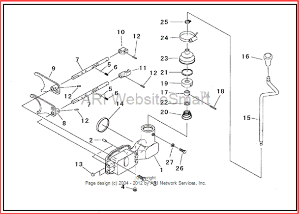

/ 2615 Oil Leak #8
I am having a similar problem. I believe mine is coming from a plug that has worked it's way out possibly due to a plugged vent? #13 in this pic.
/ 2615 Oil Leak
I am still having this leak on my tractor and I am wondering if Part number 14 is a gasket and this is where my leak is.
Any ideas would be of great help.
Butch
/ 2615 Oil Leak #13
Did either of you solve the leak? I am having the same problem with my 2615, leaking from the top plug in the illustration. Thanks
/ 2615 Oil Leak #14
Butch
Hey Butch, I'm having the same problem with my 2615, what did you figure out?
Thanks Marty
/ 2615 Oil Leak
#15
I have been told that there is no gasket where the shifter housing meets the trans housing. It uses a gasket sealer. I would like to no from our dealer friends if that is true.
Butch
