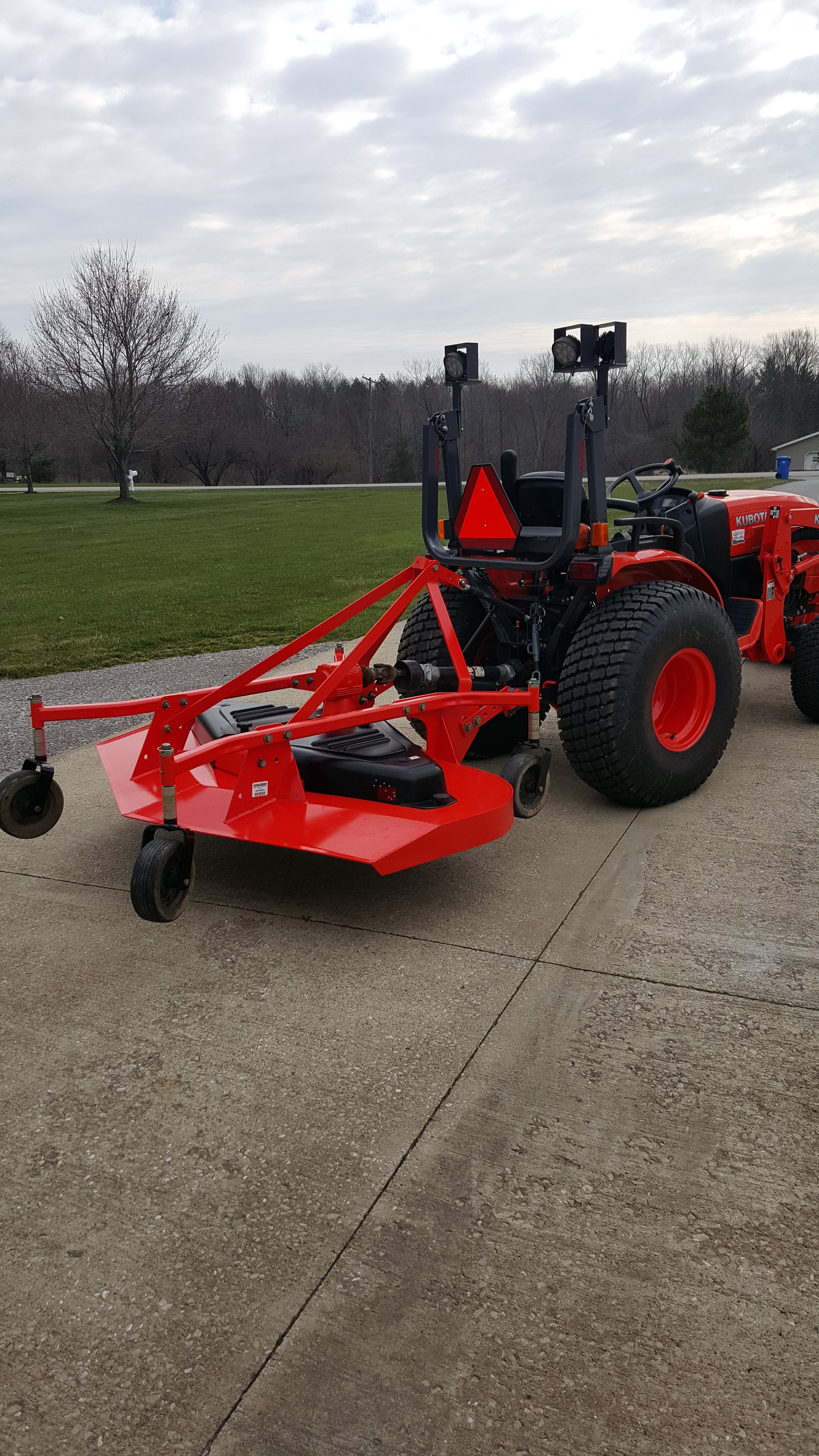

Sold my 31 year old L2250 and I'm comparing its replacements. L series no longer has mm pto so the B series is what's available. Getting BH this time along with FEL and 60 in mmm. What additional tractor options should I consider.I have all the 3pt hitch implements all ready. The 2 tractors are priced less than 10% from each other.
Mostly mowing, a lot of FEL use and some BH use. Bigger not always better but space also issue. All input appreciated.

Two good choices. I recently had to decide between the same two and went back and forth quite a bit. Do you have a preference of deck types? B2650 uses ground contact deck while B2601 uses suspended decks. B2601 is slightly lighter by itself but when when mowing with a deck hanging under it, it's a little heavier than a B2650 with it's deck rolling on it's own wheels.
B2601 is physically a bit more compact which can be an advantage for you. Personally I like the looks of 2601's analog dash better but I do like the additional information such as real time monitoring of rear and mid pto speed on the 2650's display.
Both make about the same 26 hp. B2601 at 2,800, B2650 at 300 rpm less. B2650 makes a good bit more torque though with it's larger, long stroke engine. 2650 also has a little stronger hydraulics.
My B2650 was just delivered a couple days ago and so far haven't had enough seat time to comment other than the engine is smoother than the smaller one in my previous B7500 which is a pleasant surprise.

B2650's 72" deck is drive over which entered in to my decision but I'm unsure if the 60" is. After delivery the first thing I did was remove my 72" deck and after looking at it just raised the front with the FEL, turned the front wheels a little and pulled it straight out, easy as could be much easier than the 54" deck on my previous tractor. The reason being this deck rides on 4 gauge wheels which all swivel and there's plenty of room.

Yes, 72 inch deck is drive over. My old bx had the 60 inch suspended deck. I really like the 72 ground contact deck better. Less compaction and easy to install as outlined on Milo's post. I was all set to get the 2601 until my wife asked me about cab availability. That lead me to the B2650 cab model. More expensive but worth it; ac, heater allow for bug, cold and sun protection.

I was looking at the same two tractors also. I ended up going with the B2650 for several reasons. More hydraulic power for loader work and 3 pt work. Wider and longer wheelbase for better stability and better ride as I use my tractor to mow around the house with my 60" mmm, mow 3 acres out back with Land Pride 72" 3 pt finish mower, plow all my snow here in the snow belt, rototill, boxblade and anything else. It also has position control for the 3 pt instead of quarter inching on the B2601. It is a very nimble machine to get around and the 60 " mmm mows great. I can have it on or off in 3 minutes. Turn 1 idler wheel 90 degrees, unhook linkage, turn front wheels all the way to the left and pull it out the right side with one hand. I have over 460 hrs on my 2015 model and it has been flawless. Not slamming the B2601 as it is a good model also. Good luck whatever way you go. Any other questions feel free to ask.
