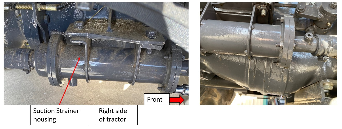

Next I moved onto the suction strainer, and again found that the housing design didn't match what was pictured or described in the manual, so I had to guess at how to remove it. I removed the bolts on both sides, which drained about 5-6 gallons of hydraulic fluid, loosened the clamps on both sides, and then removed the 3 bolts at the top that mounted the housing to the tractor. I am wondering if I should have just loosened the clamp on the outlet end and only removed the bolts on this side? Anyway, I removed the whole housing, opened it up and replaced the filter. I am confident I placed the filter in the same direction as the previous one, then I put the housing back together and re-attached it to the tractor. This is shown in the second attached picture.

I think the 3 point hitch and the front end loader work off of the same hydraulic system, but I'm not sure about the steering. The tractor started up and ran fine, but the front end loader was unresponsive. Oddly, one direction, curling down, worked for one tiny little bump and then it quit too, but all other directions (up, down, curl) didn't work at all. The bucket is resting on the ground, so I can't drive around and test the steering. I researched and asked around and was convinced that the problem was air in my hydraulic system, and most advice said that this will work itself out by exercising the hydraulics. I put about 250 pounds on the 3 point hitch, and the 3 point hitch worked just fine at raising and lowering. It did appear sluggish at first but after ten or so raises and lowering it was working just fine. I put one hour on the tractor, running it at about 1400 RPMs while raising and lowering the 3 point hitch and working the controls of the loader to try to work air out of the system. The whole time, the 3 point worked fine and the loader never responded. At this point I don't know what to do. I can't imagine working the air out would take this long, so there has to be something else wrong.
- Should I go ahead and fill up to max on the hydraulic fluid? I understand you can also have too much fluid, so I wanted to wait before trying this.
- Assuming the 3 point and the FEL are on the common system, what could possibly cause the 3 point to work while the FEL does not?
- what else should I try?

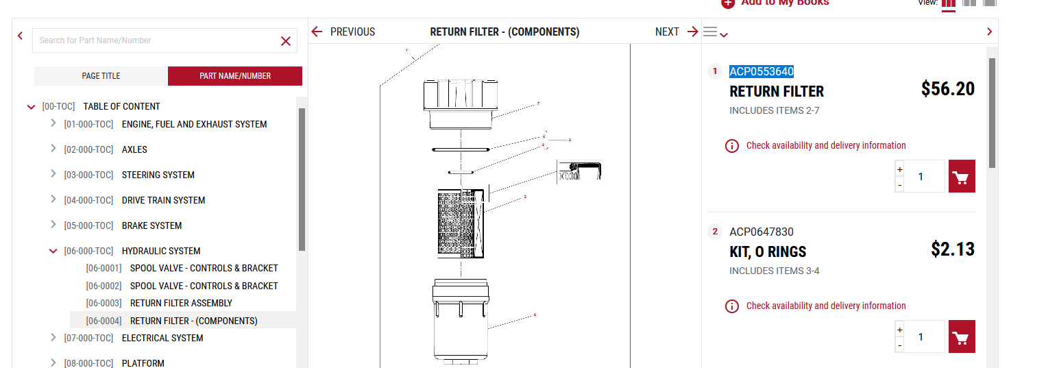

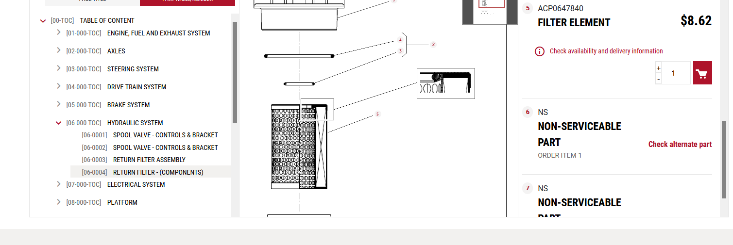

I do wonder if something going on with that return filter, from what I can see on parts list for a 2650H the return filter is a ACP0553640 part number for the whole assy.
from what I can see the element itself is ACP0647840

@Dmacleo there's two different kits for this tractor on the return filter, and I think I bought the wrong one because the O-ring was for a different sized housing. I did validate before putting the filter in, though that the filter itself was the same. See pic below. However, I have nothing to lose with trying the old one if you think there might be something potentially defective about the new one. I'm going to open up the suction strainer housing anyway (this time with something large and clean to catch the fluid with) to double check everything is placed correctly in there.

well same part# stamped onto it is good but yeah, you mentioned reusing o-ring in first post which caught my eye.
